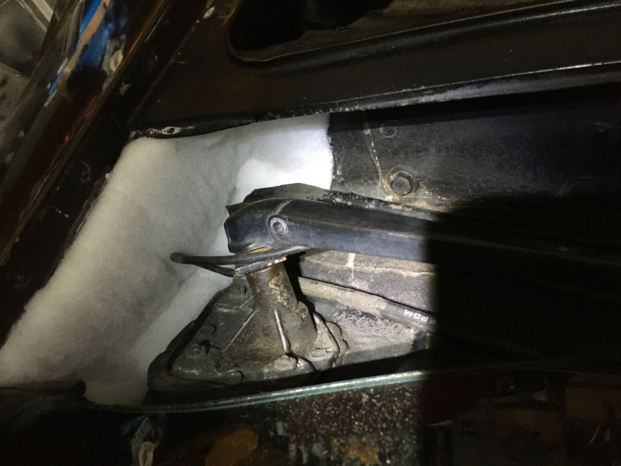

It was 116F in Portland last week. Rehabilitated the ac on both of my 78’s last year. Reused the original evaporators and condensers; new ACDelco R4 compressors and r12. I did add lots of extra insulation, especially around the evaporator box and along the firewall. Electric fans probably help the condenser a little.
Self-stick high temp insulation
Didn’t need to use Max at all.
Driving around with the ac on norm and medium fan kept me cool and comfortable.

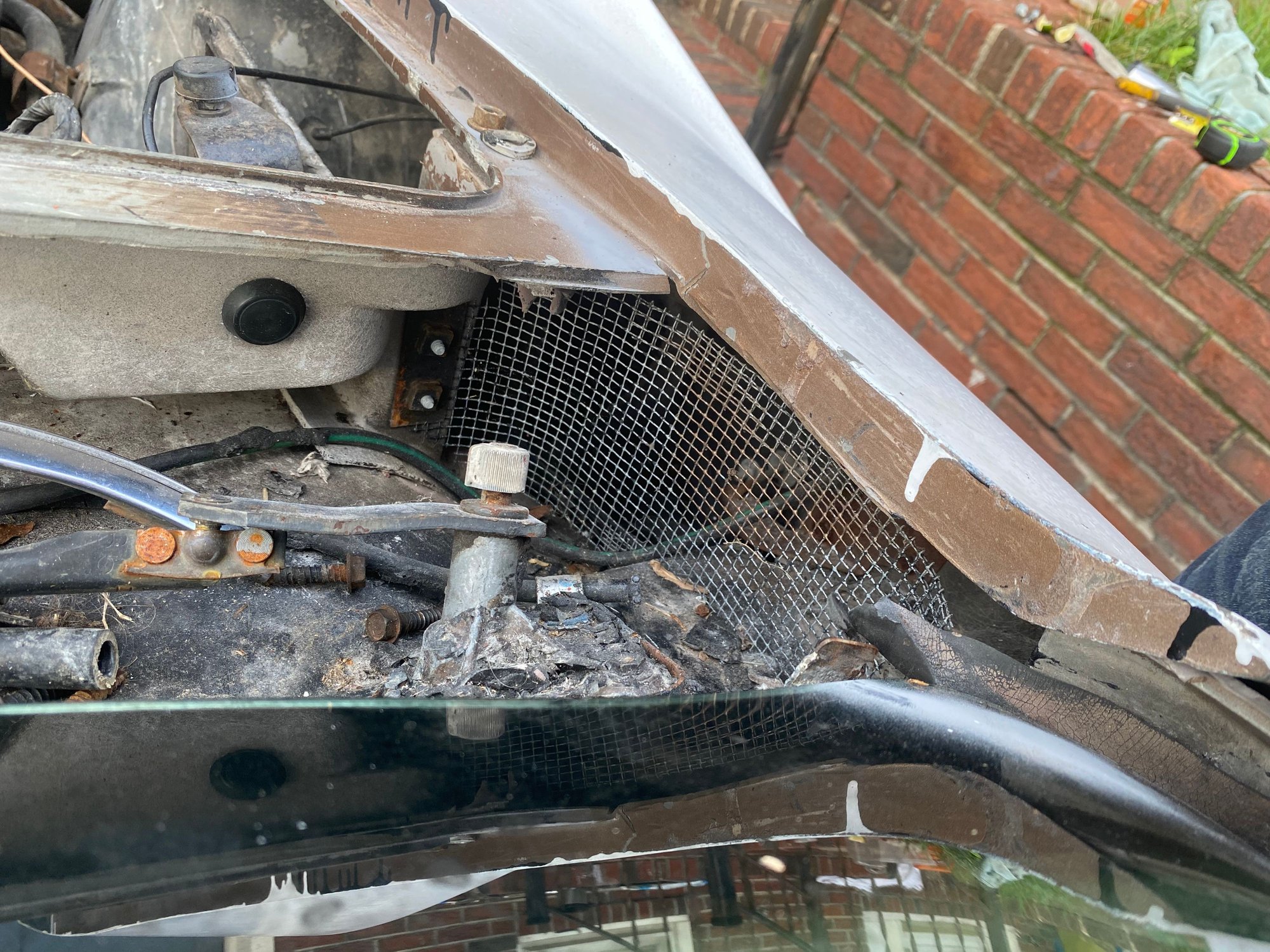

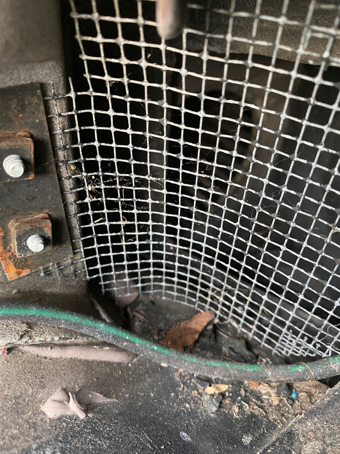

Default Air Inlet screens
Air inlet screen openings are bigger than the holes thru the evaporator. Debris buildup will compromise the evaporator and the finer stuff comes thru into the cabin. Fiber filter material wrapped around an activated carbon filter sheet will make it like a modern cabin air filter.
