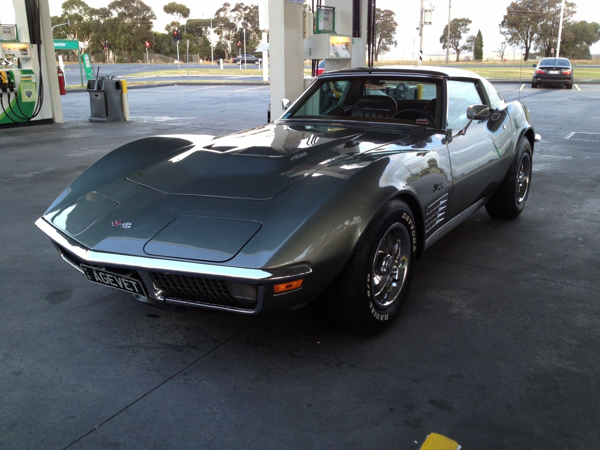

Hi, I have a 71 vet, and my lights and wipers stopped working. The lights pop up and the wiper door opens but no headlights and no wiper motor. Checked all fuses and they are ok. Im guessing it’s an earth issue.
can anyone help?

Sorry; can't help with your electrical problem, but your car looks great!
Welcome to the forum!
