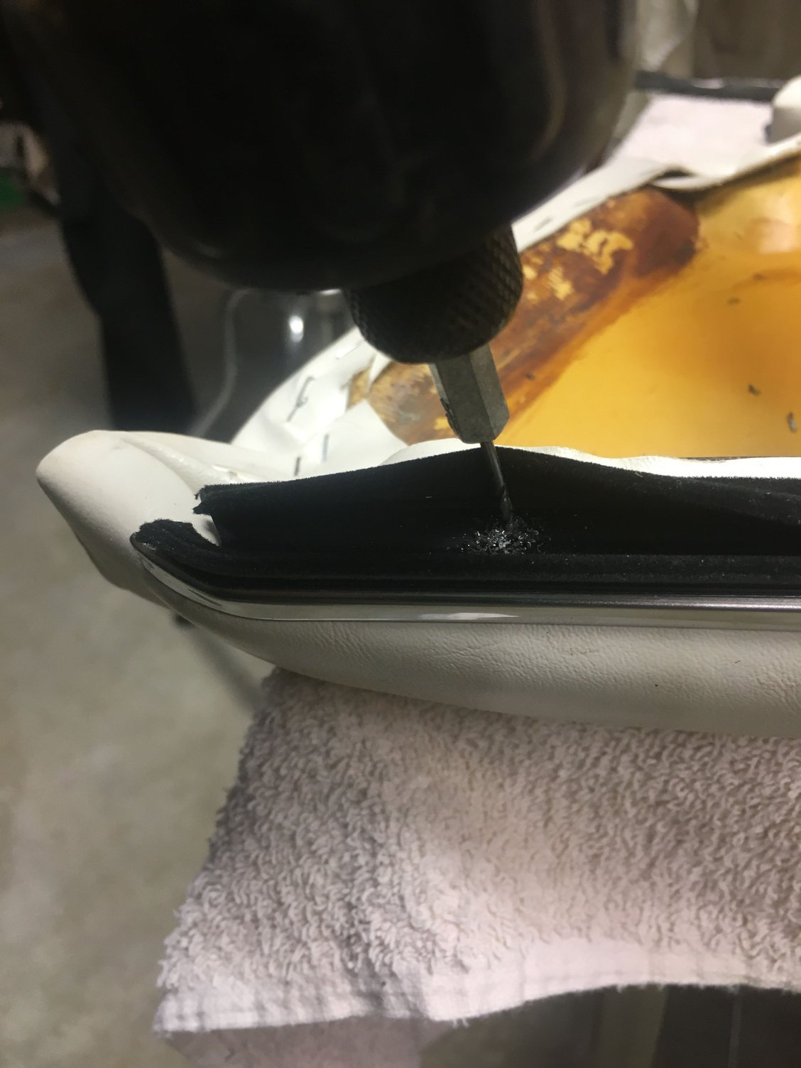

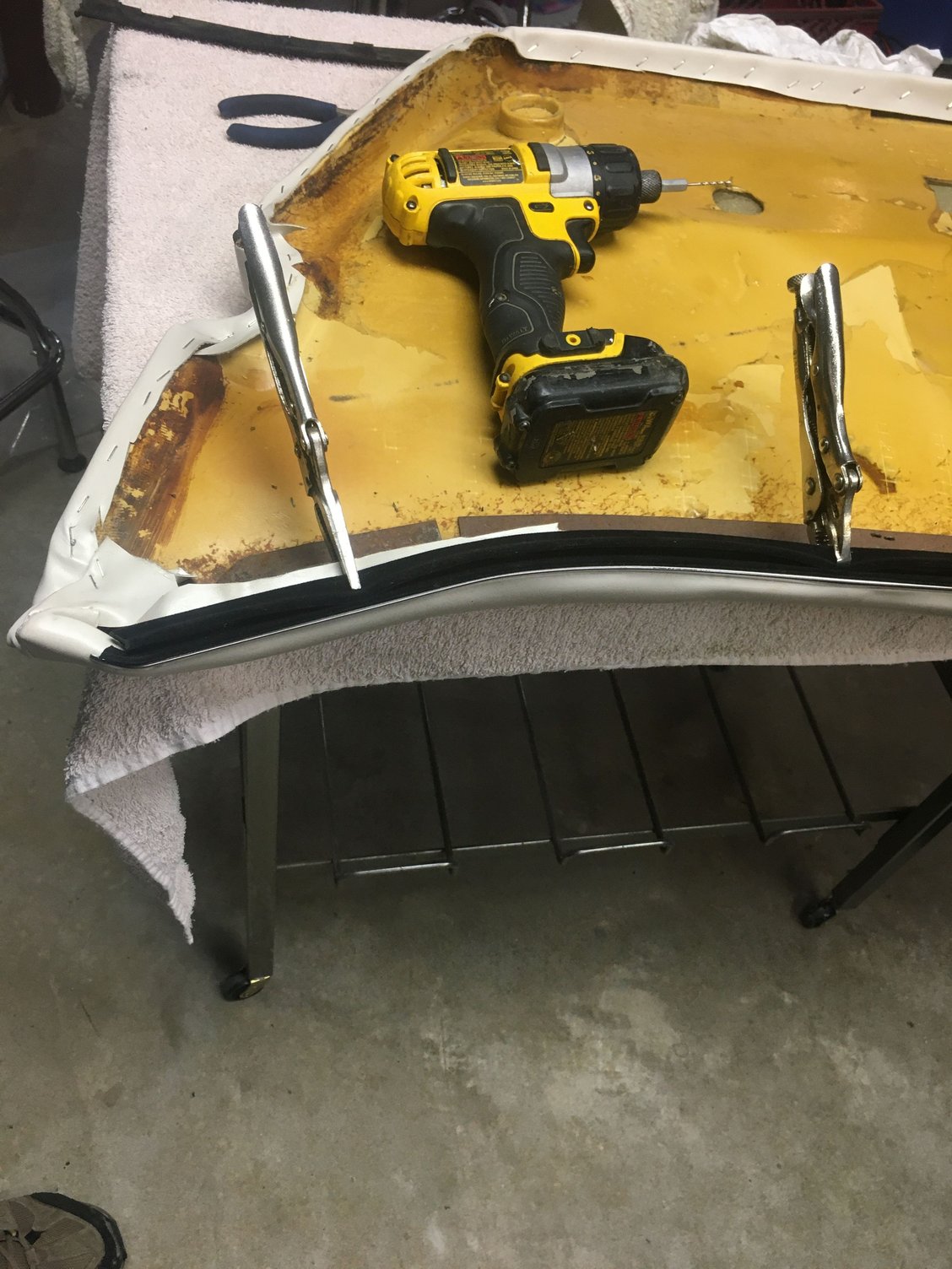

I recently tackled this, and used SS staples that are available and specific for this application.
I ended up drilling tiny holes in the metal strip - 2 per staple - and this did the trick.
