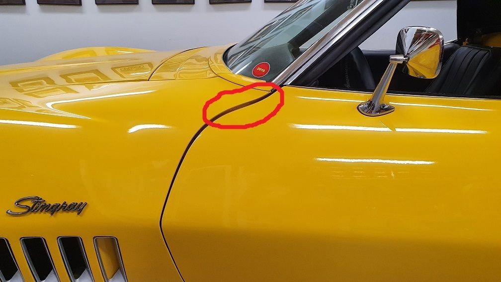

I lifted mine this weekend to change wheels. Placed the jack in the middle of the frame (under the tranny crossmember) to lift the whole drivers side.
BAM! Cracked in front of the door with nice loud sound. (Front clip to firewall). Paint job is 5 months old. Oh well, it's not that visible from the outside...
