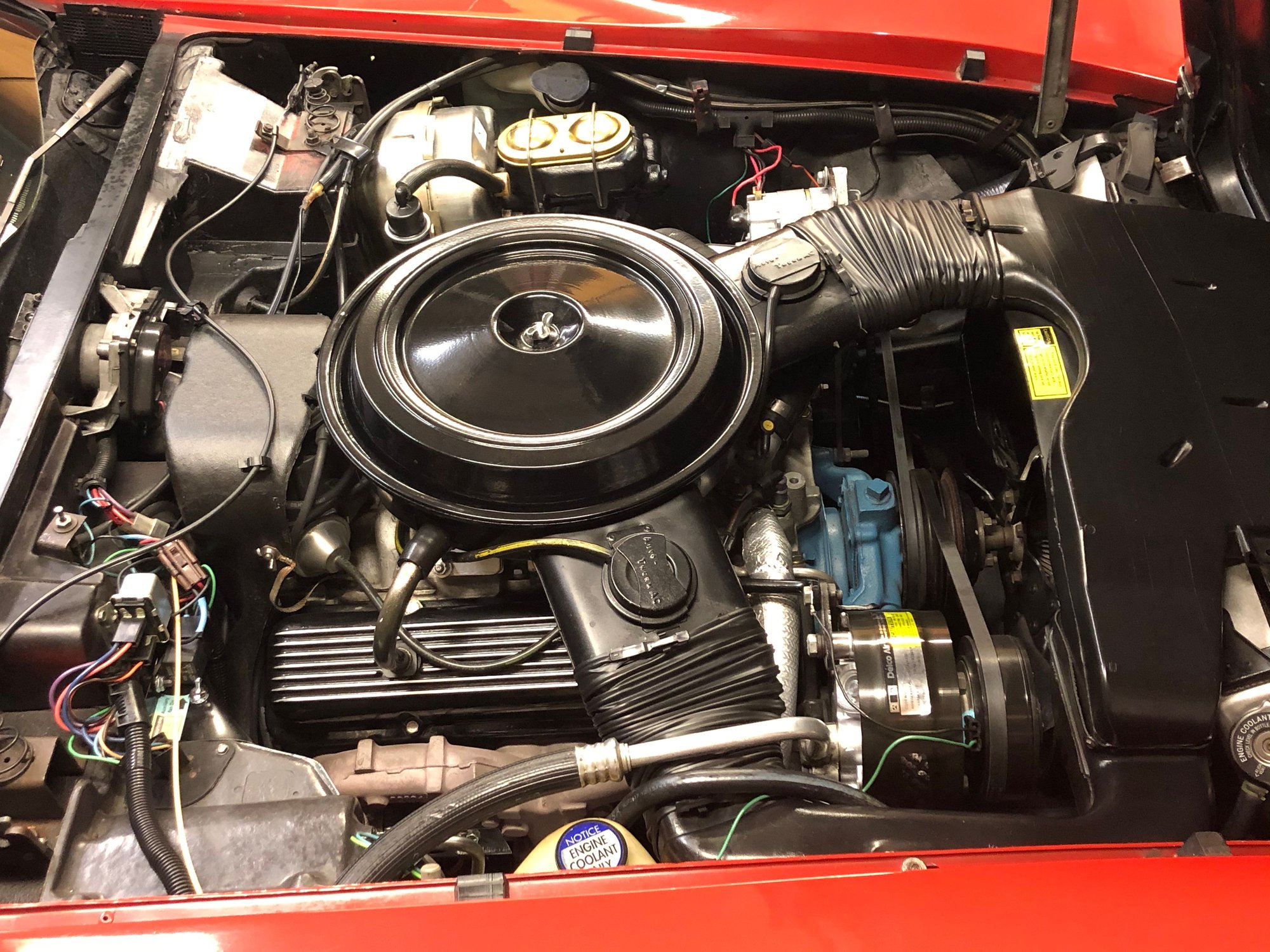

Hello again, I decided to repaint my dual snorkel air cleaner in my 1973 Corvette. Yes I am sorry I decided to do this task because I stripped the paint off tried black gloss epoxy paint, stripped it off again tried black gloss enamel and still not happy with it. Does anyone know which type of spray paint I should use? Should I be using lacquer and sand between coats like I would the exterior of a car? am tempted to strip did the paint again and take the whole thing to a body shop and get them to paint it professionally. Thanks

I had mine powder coated in gloss black...

Sevnt6, the motor and bay is freakin beautiful!
Can all those pieces be bought chromed or did you send them out? Can you give me some idea some prices, I have the air cleaner.

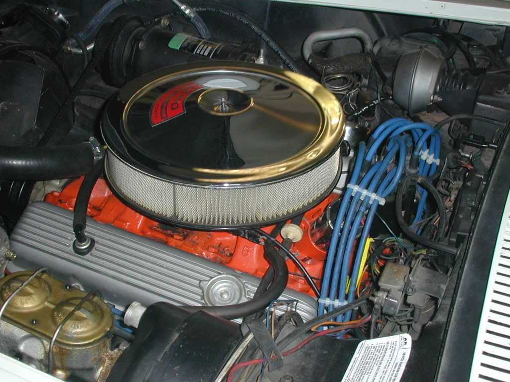

rustoleum professional semi gloss at lowes is pretty good.
here is a combination of, original finish with rustoleum touch up.. and the lid powder coated with powder coating epoxy which is currently used in under-hood suspension OEM's currently. the vacuum actuator (s) was painted rustoleum as it was repaired
valve covers also same epoxy as lid
too lazy to remove all the items that will melt in oven for powder.. like the diaphrams which i don't think you have to deal with.. that high gloss powder looks awesome.. let us know how it comes out!!!

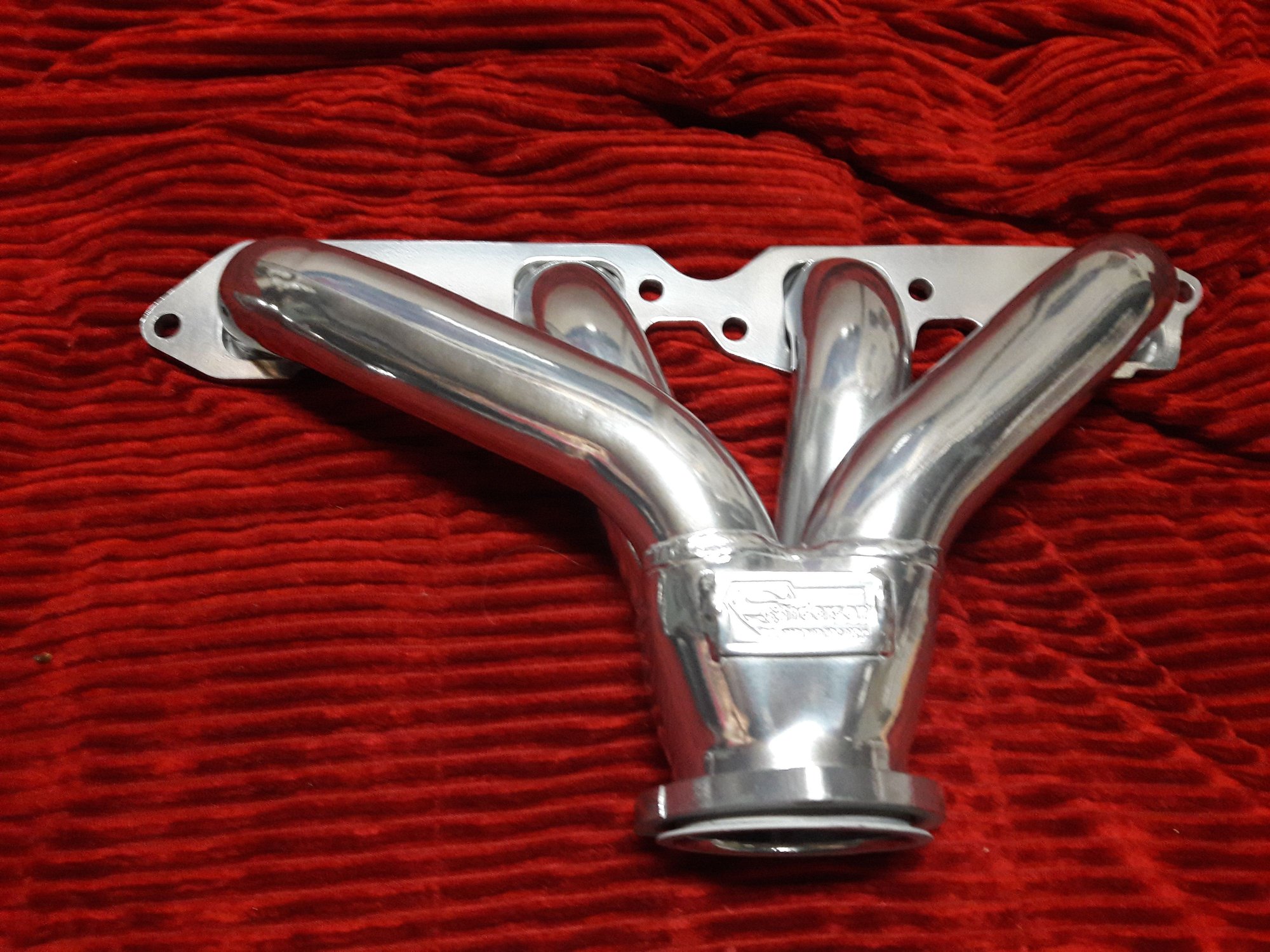

Originally Posted by Z06LMB
pictures?
The only picture I have available right now is a picture of the ceramic coating on the headers.

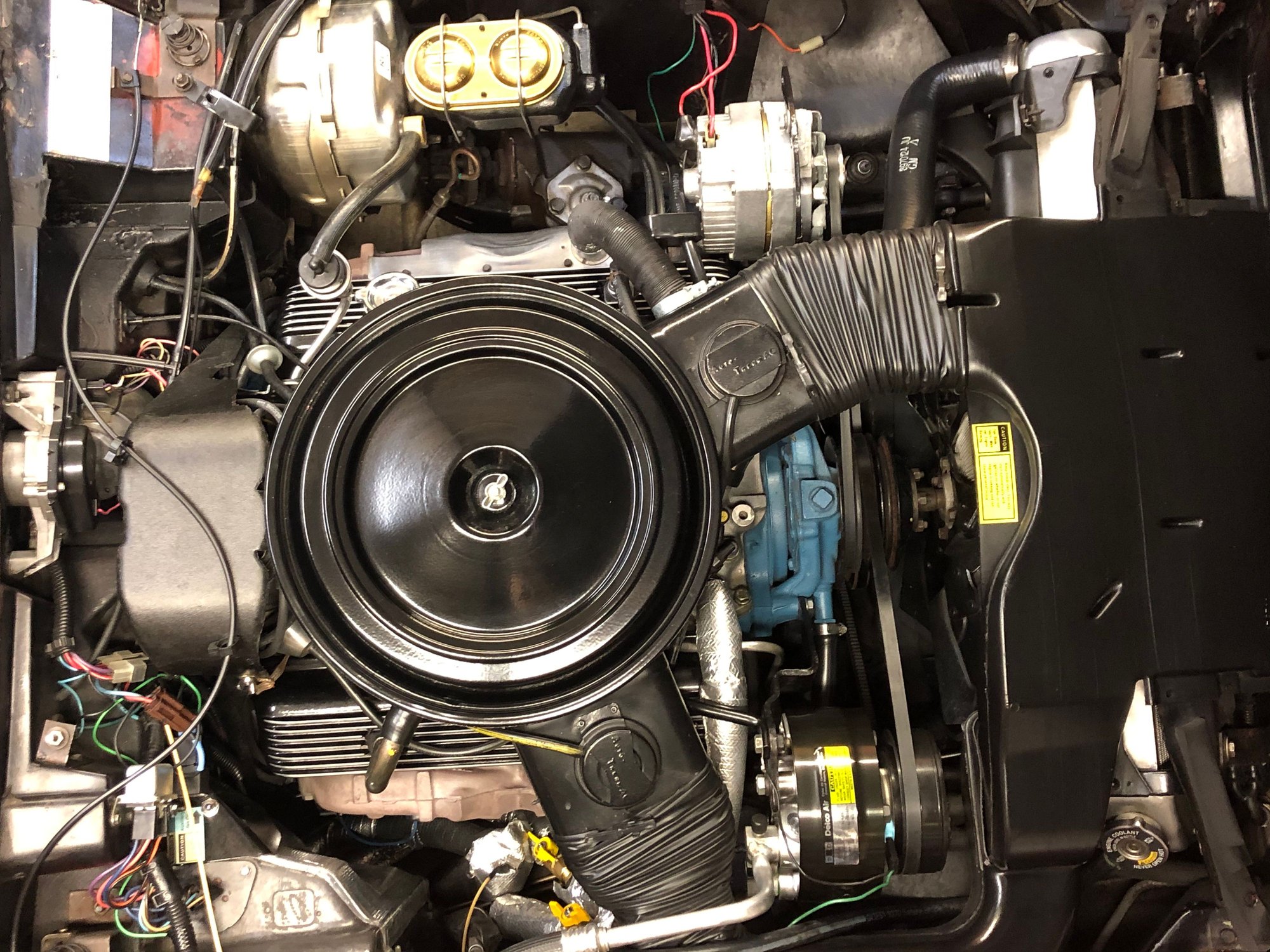

I’ll respectfully take a different position vs advice regarding powder coating your air cleaner can. I feel your pain about your worries that you wrecked your part by attempting to refinish it. I did the very same thing, years ago, however, I took to compounding it then using progressively finer polishes. I got a smooth, even, glossy finish restored. The work was a bit tedious but not at all difficult. Frankly, it was the finishing, far more than the painting, that made my project a success. IIRC, I used a common gloss black (Krylon?) rattle can to paint. You will need to allow a fair amount of time for the paint to fully cure before polishing.
I took the photo shown below this morning for posting here.
