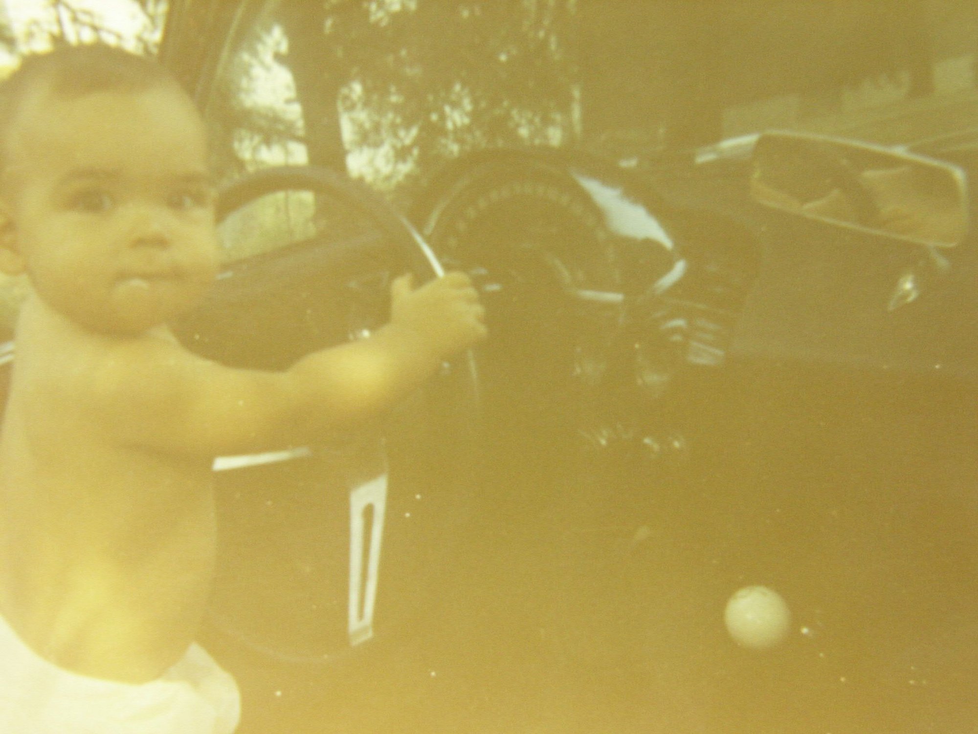

Hi all,
I'm trying to find the exact duplicate of the Corvette steering wheel I installed on my 61 Corvette back in 1970. That wheel was given to me by my friend who owned a 1968 Corvette (I think I got this right). As you can see in the picture (no that's not me) the wheel is a split type with stainless center. Can you confirm what year Corvette wheel this is??
Thank you

1968's were 16" in diameter and 1969 onward were 15", This was for burgermeister thigh clearance as well as left knuckles clearance.

I installed in my 1961 ... as I was and still am 6'4" and the extra leg clearance was needed! It worked great! - so both 68 and 69 Corvette steering wheels had the stainless center rim splitting the black textured plastic as pictured? I do not recall if it was 16" or 15".

so the question is .... did both 68 and 69 Corvette steering wheels have the stainless center rim splitting the black textured plastic as pictured?
Thanks all for your help with this ... I need to know what steering wheel is pictured so I know what to hunt for!

Yes, They were the 'same' except for diameter.... black vinyl rim, brushed stainless spokes. 68 & 69...and onward to 75.....when the Vega made by Rubbermaid wheel took over. For 4 years.....
To answer your question, 66BBCoupe, '68 steering wheels did NOT have the stainless center rim splitting the black textured vinyl as in your picture of your '61.
He is a link to a '68 steering wheel showing no stainless center rim splitting the woodgrained plastic wheel. https://www.ebay.com/itm/20328273040...BoCH5YQAvD_BwE
Here is a link to a '68 NCRS Top Flight car. Steering wheel shows no stainless center rim splitting the woodgrained plastic wheel. https://www.admcars.com/1968-chevrol...ght-c-1058.htm
Therefore, the wheel in the picture of your '61 is 1969-75 Corvette steering wheel.

reference "Therefore, the wheel in the picture of your '61 is 1969-75 Corvette steering wheel."
Perfect - that's what I needed to confirm! Thank you.
Unk
Not really. 68 was like 67. 69-75 Were alike.
