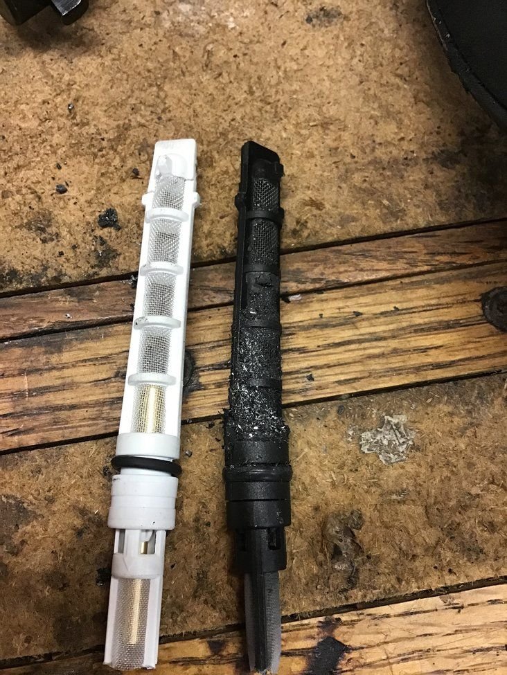

The orifice tube should be removed after evacuating the system to check for debris. If the system isn't taking in refrigerant then it could be blocked. That will ruin the compressor if it already isn't. The orifice tube will be full of gray/black gunk if the compressor has failed. Then it is time to properly flush the entire system, replace the compressor, orifice tube, and accumulator (and correct oil) plus new o-ring seals suitable for the refrigerant type, and vacuum. If it holds vacuum for a couple of hours then you can move forward with the charge.
I was going to suggest this but honestly didn't know if it had one or if it was replaceable. This could be the entire issue actually.

Yes, on a 1978 it has an orifice tube and it's replaceable. Just did a A/C rebuild on my '78 two months ago.

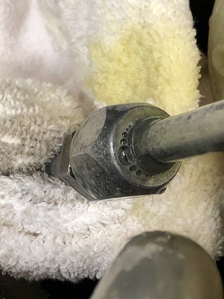

metal line going from condenser in front of the radiator to the evaporator in the firewall. the fitting on the evap is where the orifice tube is located. https://www.ebay.com/itm/28385510349...IaAqF2EALw_wcB the rear fitting in the pic. the drier needs replaced as it has been open to air so it is sucking up water. not why it is called a drier though. it collects liquid refrigerant so the compressor doesn't try to compress a liquid which never ends well. dryer. https://www.topflightautomotive.com/...kaAj1bEALw_wcB

this orifice
Ac accumulator compressor change where is oriface - CorvetteForum - Chevrolet Corvette Forum Discussion
this compressed air to see leaks..
Lost my r12 seal questions - CorvetteForum - Chevrolet Corvette Forum Discussion
compressed air helps you spot leaks
check for cleanliness
