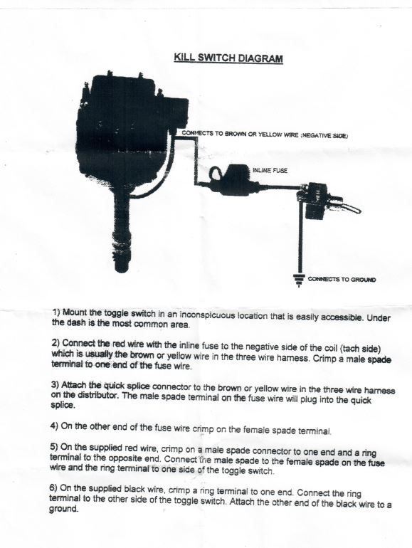

Default D.U.I. Distributor kill switch question
it connects the negative side of the coil directly to ground. How does that not fry the coil? Is it because there is so much resistance in the coil (circuit) that current is not that high ?

Originally Posted by 7T1vette
Weird approach to a 'kill' switch. Easier just to put a 'hidden' toggle switch in the power line going to the + side of the coil. No power to the coil....no Joy.
Yep. I remember reading years ago about using this approach (grounding the neg lead to the coil) and chose not to do it, because it seemed like a weird way to do it. Instead, I put a hidden switch in the 12 ga wire to the starter solenoid, but now that I have a remote solenoid, it’s easy to defeat. So I bought this kill switch from D.U.I. when I bought my new distributor…..
adding a switch on the + side of the coil might add unwanted resistance to the circuit…..but that’s just a guess….

Well I called Performance Distributor and the guy assured me it was no problem and that is the way it is supposed to work. There is a 20 amp inline fuse in the circuit.

Old Oct 1, 2021 | 06:25 PM
need-for-speed's Avatar
need-for-speed
Joined: Feb 2000
Posts: 45,404
Likes: 892
From: Texas
CI 1-4-5-8-9-10 Vet
St. Jude Donor '03 thru '10, '17
Thanks L46 man. Do you see any issue with the method shown in the instructions in post 4 ?
