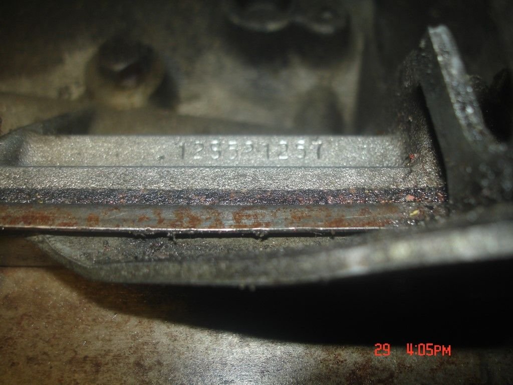

The vin number is stamped into the edge of the casting just above the pan on the drivers side sort of in front / on top of the shifter cable bracket

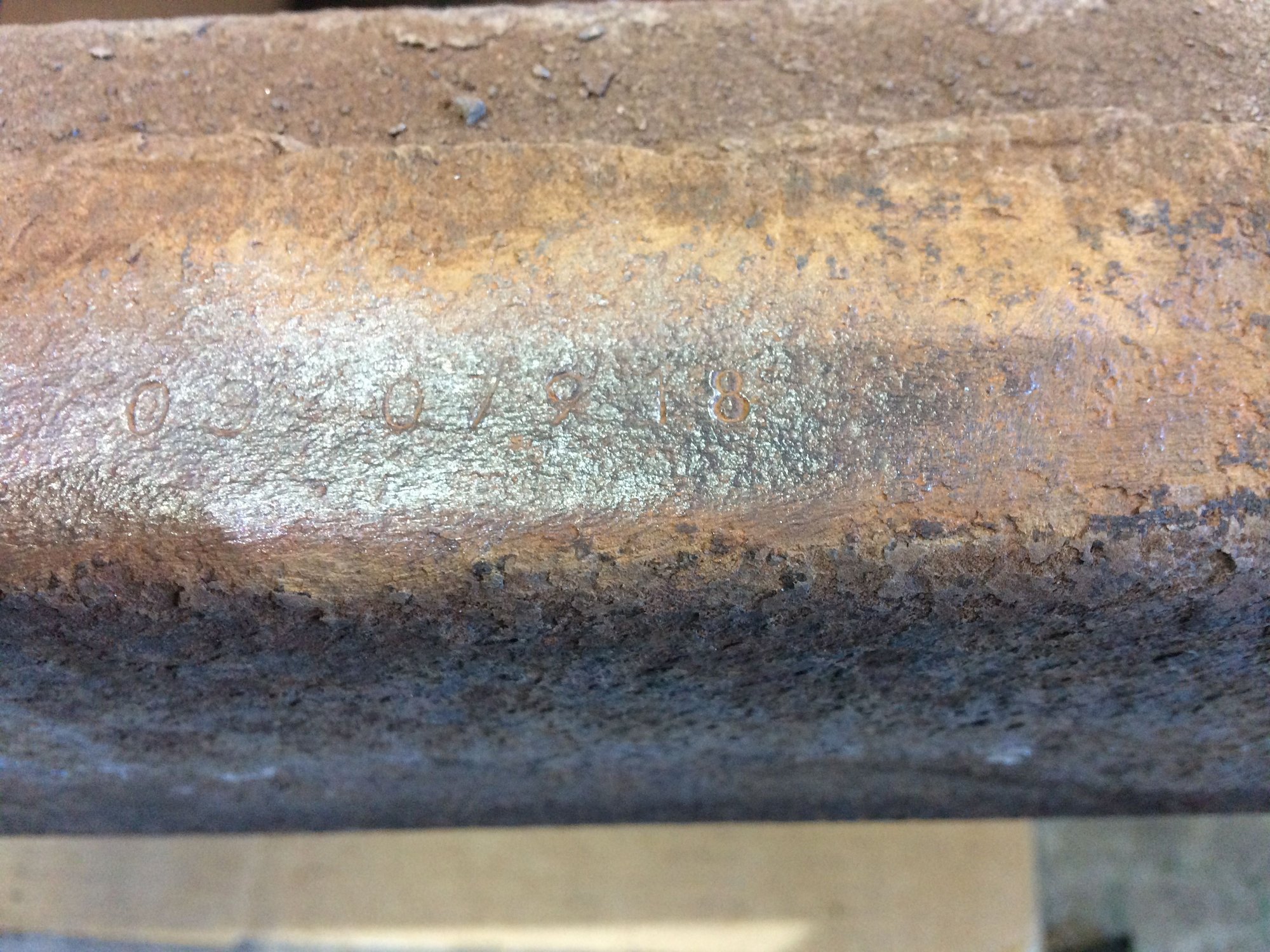

The VIN stamp on a 1970 is located on the top of the drivers side frame rail below the door Body must be removed to see it. There is another Vin stamp on top of the drivers side rear rail around where the antenna ground is located. On the side of the frame rail under the drivers area are the date and frame numbers.
Frame, Trans and Engine will match
Just in front of the #4 mount to the front of the frame is the second vin stamp
