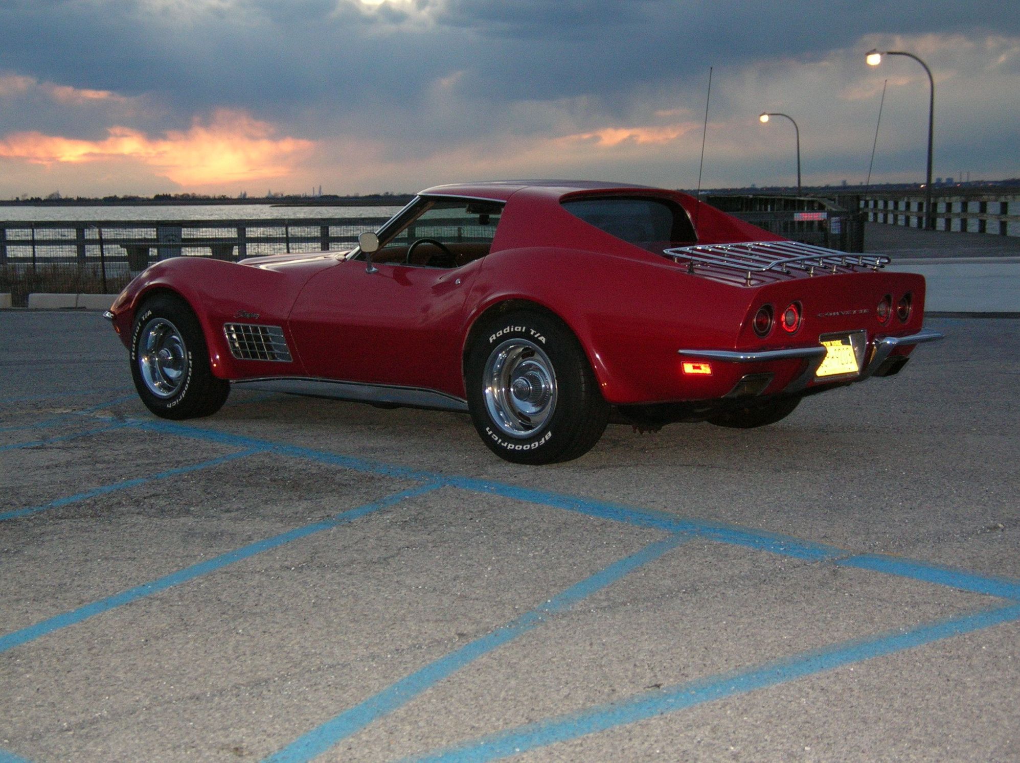

Both the 71( 1974 Porsha Red ) and 72 ( Targa Blue) tires letters have stayed white. My friends 60 series have turned brown. I wash them with Awesome from the Dollar store . Then Maguaris tire shine from Wally World.
Gliptone wax on both cars. Been using it since 1968.

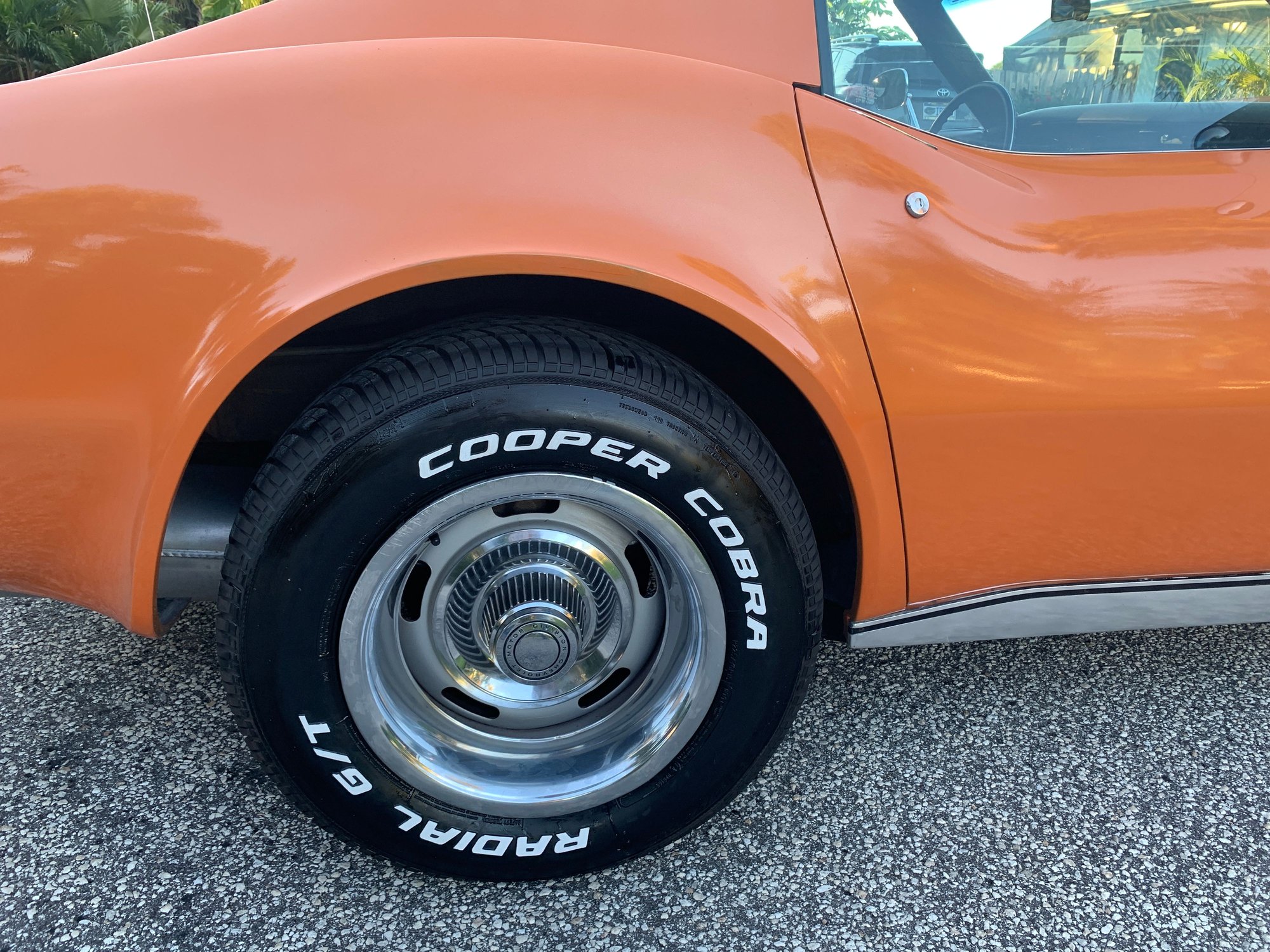

So if anyone is still around; here's what I used on my Cooper Cobras. Seemed to work pretty well, but still labor intensive. The TireInk pen seemed to have delivery issues at the point of the pen, so I went with Sharpie markers. I used a medium point to out line the edges, then came back with a bold point to complete the fill in.

I used Acetone and paper towels on the letters. The sponge (with brillo-like green side) sitting there is what I used to apply the Meguiars Endurance Gel to sidewalls after I was done with the lettering.
