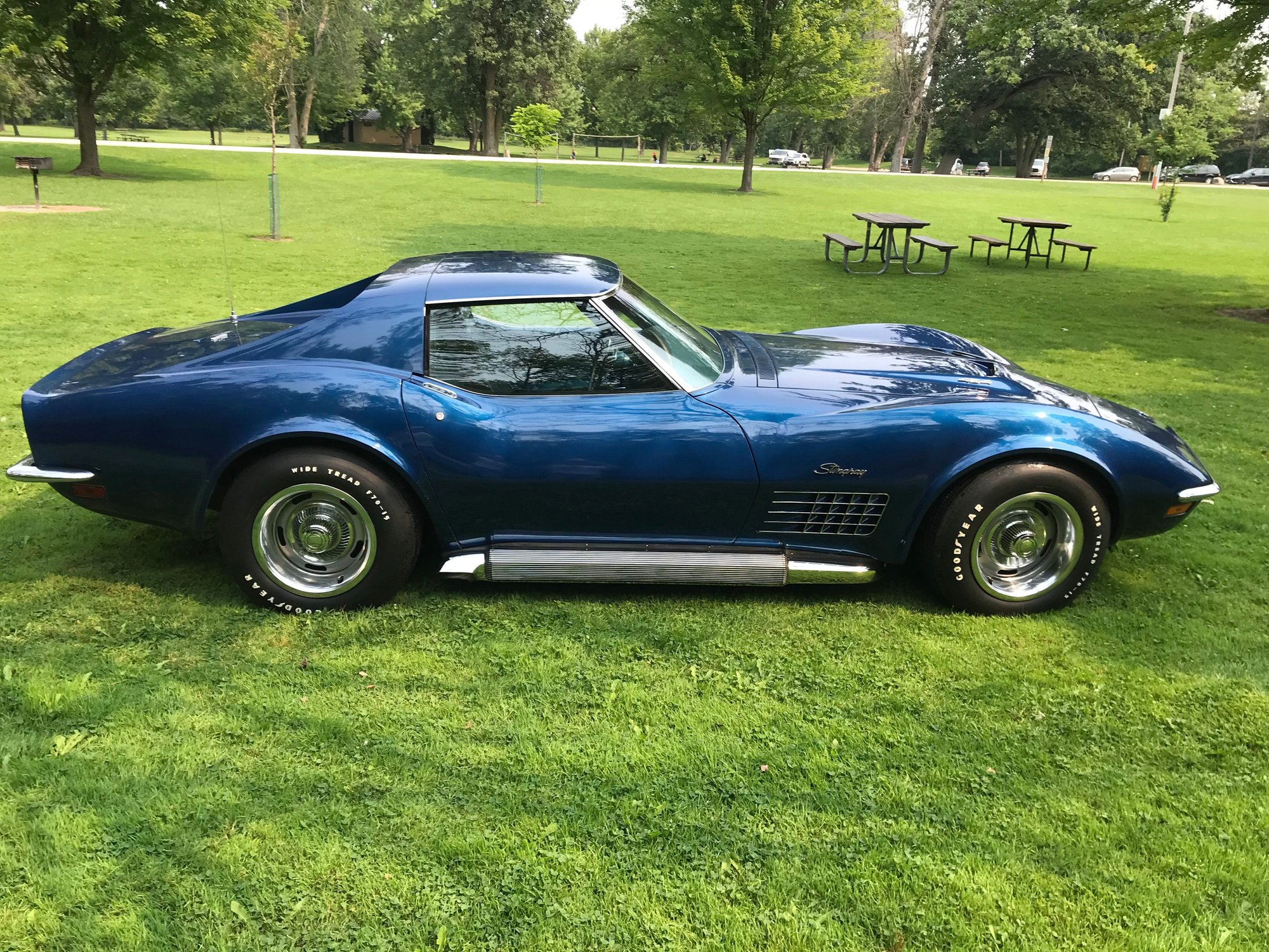

fieldsjkk 72 IS a great lookin' car !
had a 71 coupe in OE Bridgehampton Blue; it looked similar.

That is a 'dead-ringer' for Bridgehampton Blue exterior.

Thanks. Color is Targa Blue. One year color in 1972.
You are a Poet & don't know it!
Sweet car
