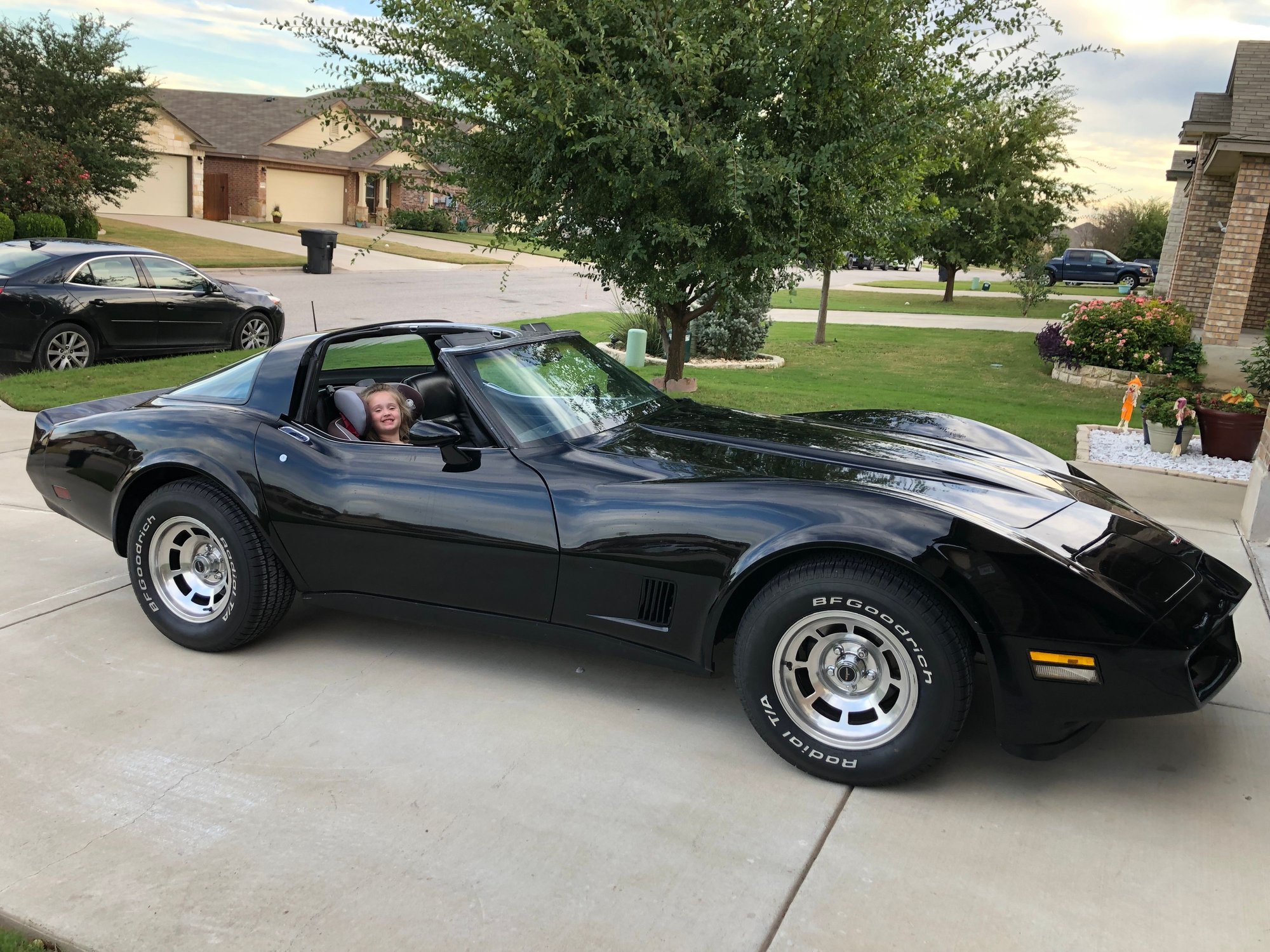

I had the white letters turned out on my '80 on Tuesday and they still had the blue caked on them. The tires are 4 years old, but only had 300 miles on them. I was able to scrub some of the blue off but most of it was very stubbornly stuck on. I used some of my McKee's37 Cargo Liner and Floor Mat Rejuvenator/Cleaner spray on a cloth to wipe off the letters and it took the blue/brown right off. This stuff works great on rubber floor mats so I thought I'd try it on the white letters. Be warned, this stuff will burn like hell if you don't wear gloves, but it does a good job with minimal effort.

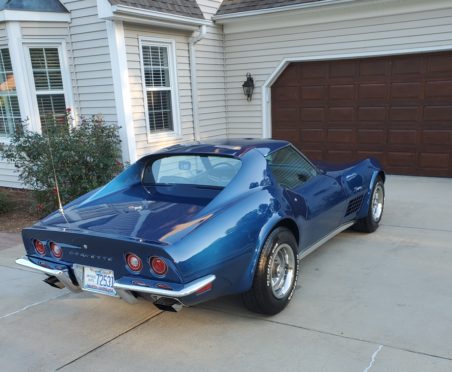

Originally Posted by fieldsjkk
I have had several vehicles with the BFG white letter tires throughout the years. Currently on my 72 Corvette and also my Ford Truck. I like LA's Totally Awesome All Purpose Concentrated Cleaner. I spray it on the dry tire (undiluted) and let it sit a few minutes, Scrub with a brush. Then do the same thing one more time. Then rinse off and wash thoroughly with soap and water. I only have to do this about twice a year. Try to keep it off your paint though. Rinse and wash with soap if it gets on the car body. You can buy this off amazon but it can be a little expensive. Dollar General in our town carries it and it is much cheaper. Good Luck.
That's a nice blue - what's it called? Nice deep, rich shine - is that a clearcoat?
