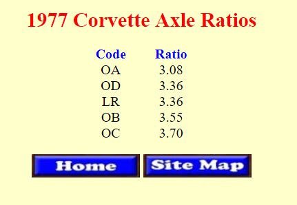

Here are the 77 Axle codes

The standard ratio for a 77 L48 auto was 3.08. As stated above, changing the ring and pinion is definitely not a job for a beginner.
