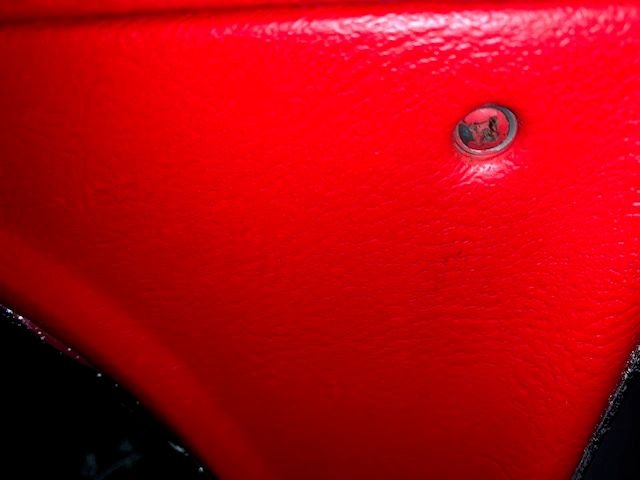

They should be black phosphate screws with washers and painted interior color. Here is a pic of my drivers side upper dash screw, never removed.
