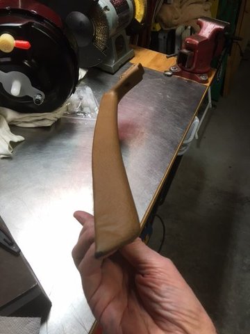

tmny, when you first put the A-pillar trim in place, the direction and forming efforts necessary to achieve a good fit will become obvious. IIRC, I bent the trim over my legs while I was sitting. Just don’t push it hard enough to kink it. It also requires a bit of twisting. I would imagine that any supplier’s trim would need to be worked to achieve a good fit.

These will give you an idea of where you need to be.
Note the twist.

Chuck those pictures are great!
I had not anticipated having to massage this part so much to get a nice fit.

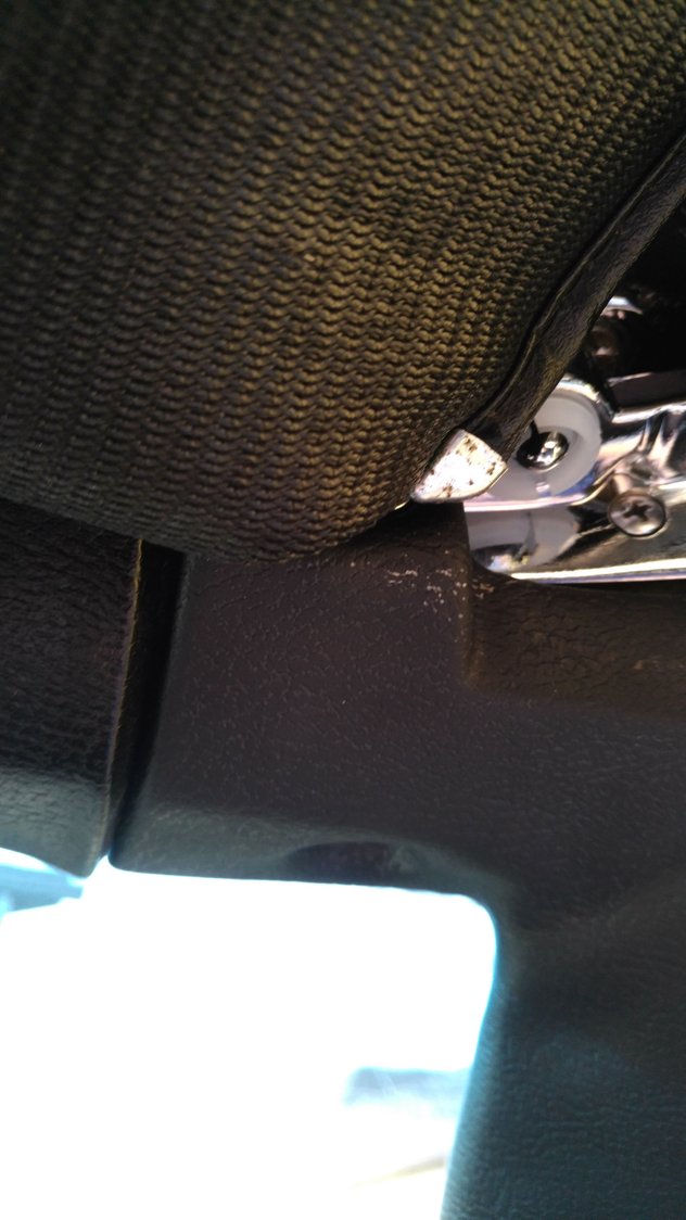

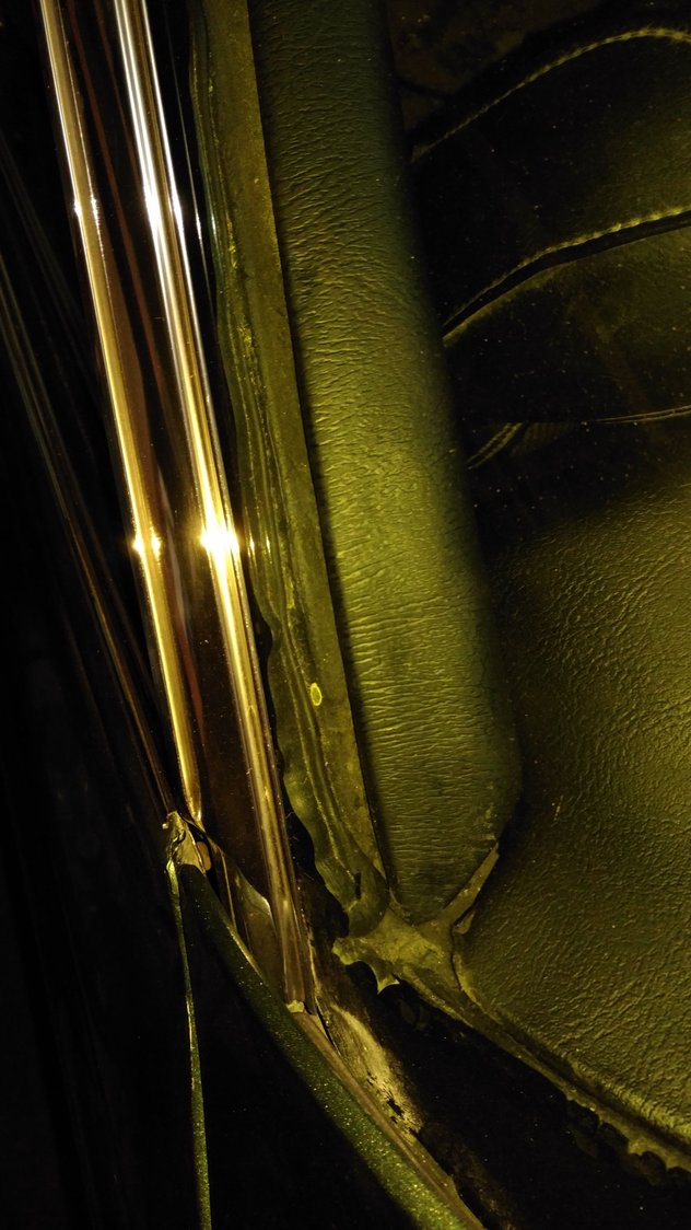

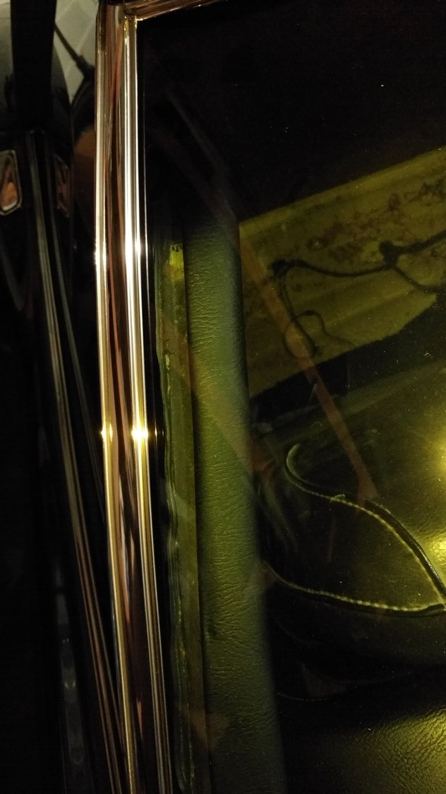

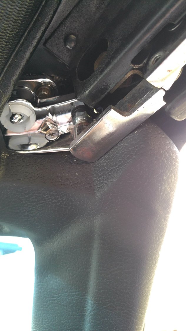

Default Finally Installed Al Knoch Pillar Post
I installed the Al Knoch post (passenger side). I'm not overly impressed with the fit. There is still a large gap between the trim and the windshield which shows the frame.This is the best I could get it with quite a bit of massaging and adjusting. It is also very close to the T-Tiop latch on the inside. This part will do for now. But I'll be keeping my eye out for a good used original to replace it.

I noticed rubbing from my t-top locks on the new a-pillars also after installing. I pretty much leave my t-tops off all the time so have just been careful when using....
