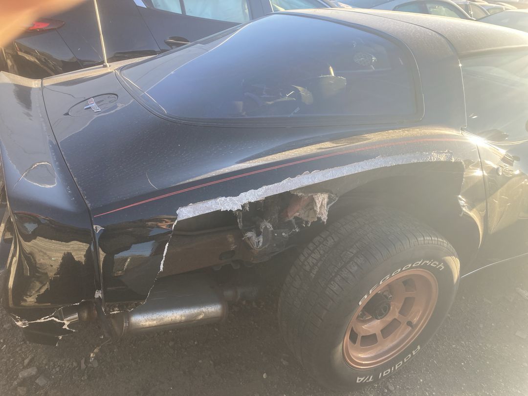

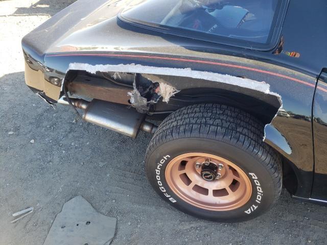

Looks like an easy fix. New rear fender/bumper. They're easy to replace!! Looks like someone put some time into that car.
Ecklers sells SMC fenders which are made on original GM tooling. (or you can buy original). I've purchased SMC restoration body parts from them. The quality was great.

For the price of shipping a car to Europe and the cost of shipping parts, buy a good car. If people won’t pay more than 2 or 3k for a hit corvette it is because it is not worth the money. At their 3 to 600 ship cost for a few hundred miles.

If you can conrfirm that the rear bumper is a fiberglass replacement, any experienced fiberglass body man should be able to rebuild that end with a new quarter as a guide.
might be something to consider for the price of buying a new one, since that usually involves extra work to fit it properly anyway. Also, toss a quart or 2 of vette panel adhesive to the parts list.

That right rear tire looks pretty fresh. I’m thinking blowout shredded the fender and someone grabbed the flopping ‘glass and ripped it off at the bonding strip. Most body shops wouldn’t want to tackle it (not in their money-making wheelhouse), so they probably quoted it real high to scare it away, resulting in it being totaled.
It depends on the buyers wishes. To me, this is a great looking C3, and if someone just wants to get into a driver C3 for cheap, and can do some of the work, this would be a decent candidate at sub- $4k. (assuming solid frame, birdcage, and the rest of the car).

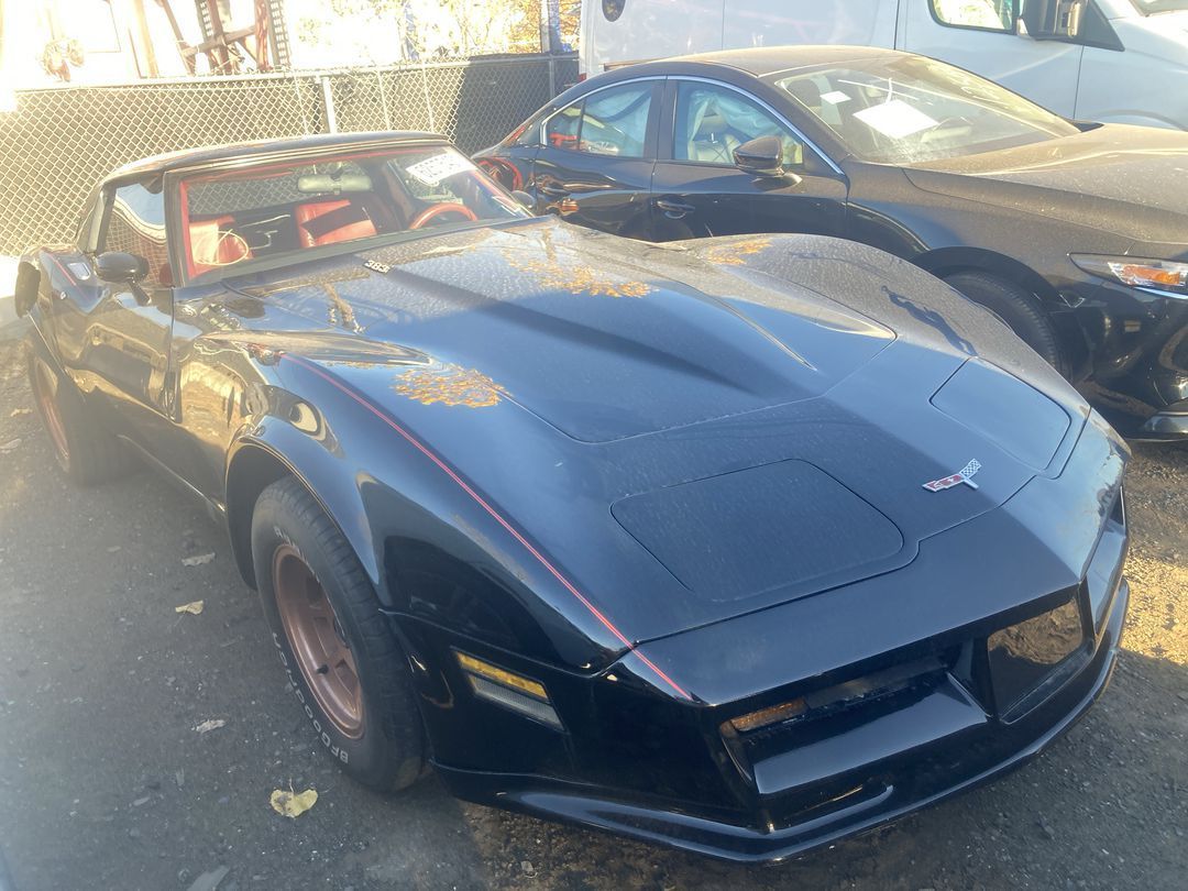

Anyone notice the “383” on the air cleaner? Might this car have a nice motor in it?
Yea,,, but my cars have markings and stickers and badges on them that are NOT what it looks like,,,
BUT,,, one NEVER knows unless you investigate deeper,,,,,,
Hopeing this has a happy ending,,,,
Thats exactly what i HOPE for:-)) it has 383 badges on the hood too, hopefully previous owner was not just a ricer:-D
