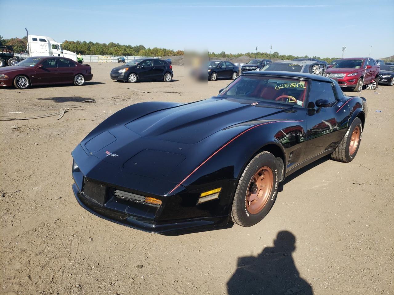

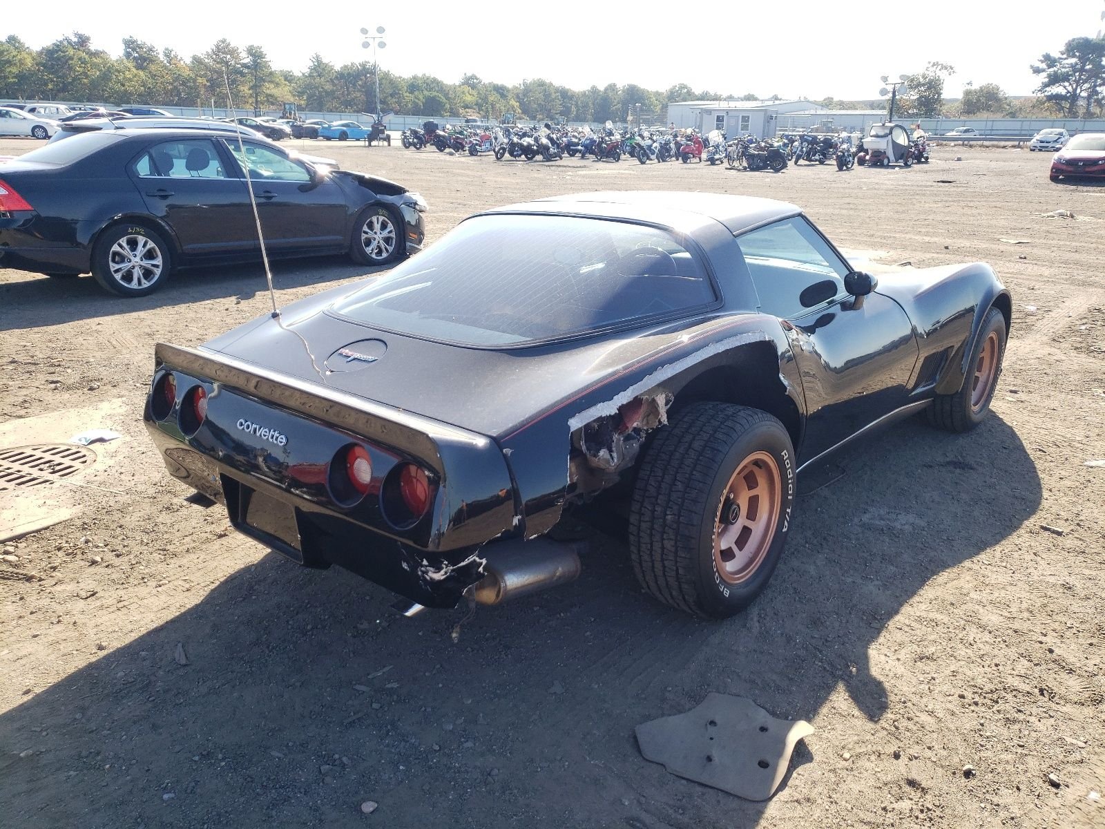

Hello guys, i would like to purchase and import to EU cheap C3..

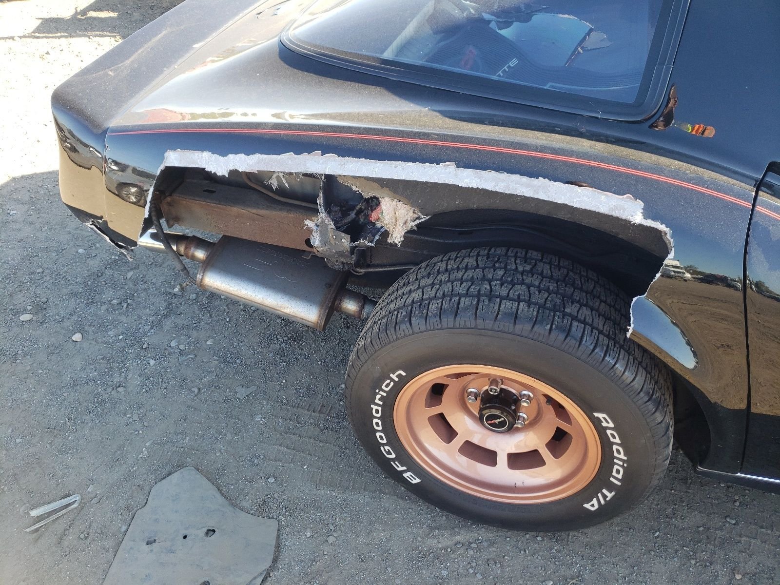

Looking at this one, little crashed, i would love to purchase parts in US and ship them with the car at once, could you C3 experts help me identify which parts would i need? I know it is impossible to tell from the picture:-) just rougly..
Of course rear fender panel and rear bumper cover, what else do you think will be necessary?
And, by any accident, anybody at NY - Long Island who would check it for me for some beer money?-)​​​​​​​

I would probably walk away from that car even if it was free.

I would not go just based on those photos. lot of rusty cars in that part of the USA
you have the right idea, if you can get someone to check out the car, look at the birdcage rust and any other damage.
and send you a bunch of photos.
looks like a splash shield and fender.
Is it from a blown tire? or crash? look at differnetial frame for damage.
otherwise it looks like its been taken care of.
Post a Help wanted ad in the REgional forum, northeast.

it depends from US state to US state. but generally you can re title after going thru some inspections and proper rebuild. unless the car is so bad its titled parts only/not rebuildable.
Most cars are salvaged because repair cars exceed the value of what insurance co want to pay/worth.
The damage doesnt look too significant at first glance. so maybe theres some more underlying issues?(although bodywork is very expensive). theres been a lot of flooding around there, toasted wiring of flooded engine could salvage a car.
Sometimes the cars end up at these auction and salvage lots beacuse they were stolen or used in a crime lol. so it coulda been in a pursuit and jumped some curbs, used to haul drugs, or stolen and stripped for parts haha. who knows.
I dont know the asking price. But if the price is too good, and someone hasnt already scooped it up, there might be something fishy
-oh yeah also missing the red rear parking lamp and wiring

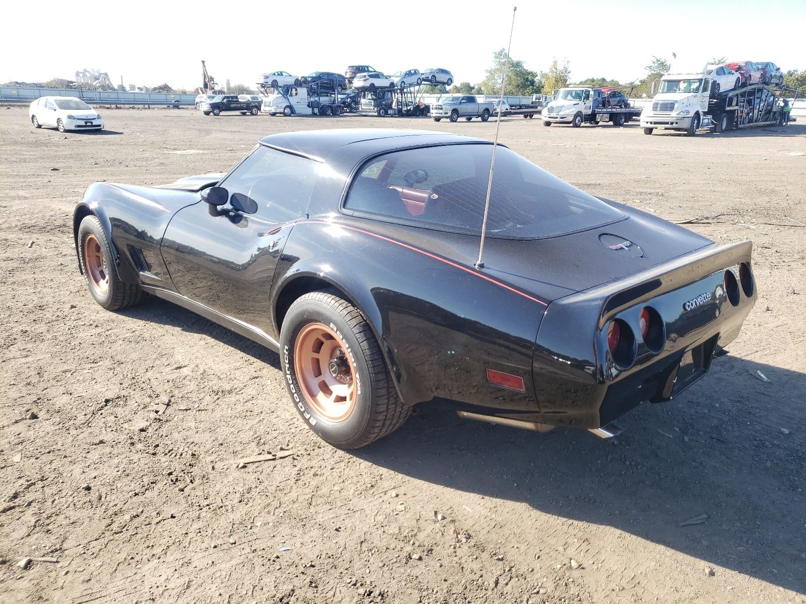

Actually, I'll take the restorers position...YOU MAY BE ON TO SOMETHING,HERE!
1. Impact did not hit the rim (matching rims, no scrapes) .
2. Rear tire is in the correct attitude, so no visible impacts to trailing arm or AT WORST you'll probably have to replace the lower strut. = Cheap!
3. This really looks like a 'backing-in incident' (off side of car bumper cover caught the corner.) or a minor 'side-swipe')
4. Parts are readily available.
5. Body work in the EU is equivalent the world over...esp. in GB, where MANY indigenous cars were fiberglas.
6. Once you check for rust...the rest is straight-forward.
7. Black is the easiest color to match.
8 Car should be cheap...like $5- $6000 USD.
I say go!
Cheers Unkahal

You should get someone to go there and check it out. It MUST run and drive or forget it. Body work is one thing, but other mechanicals should work. Maybe a 3k car, maybe less. Labor charges here are through the roof. Make sure you can get the parts to ship with the car. Good luck. It is a way to get a car not available at your home. PS. How much to ship overseas?

I like the old adage "Buy the best car you can afford", sometimes even a free car will cost you more in the long run. $6K for a smashed bubble window car? Hell no. You could probably get a rough '68-'72 for that money. Definitely a '74-'77.

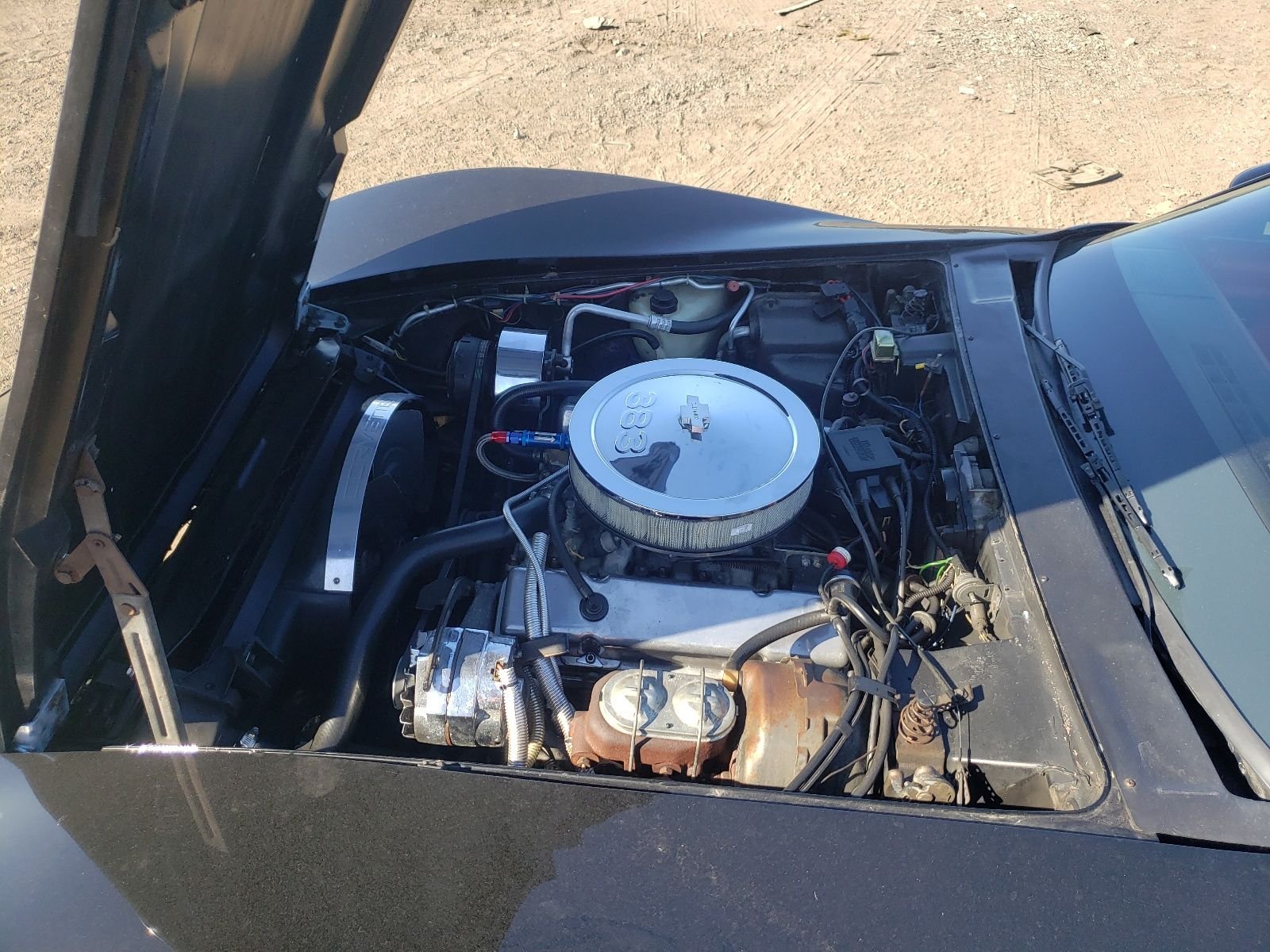

Anyway, many thanks to all for replies, i just cant help myself and purchased the car.. It is running and driving, really looks preserved and its actually the greates combo and looking car for me, so i just bought and we will see.. As i said i have very good workshop here in EU with low labour cost, something mechanical wont be big issue, of course the rusted frame would be the worst case, so lets hope.. But to be honest, cheapest C3 (which even from pictures looks way worse then this one) here in my my country at the moment is for 16k usd, so it could be resold for the purchasing prize immediatelly.. Hopefully it wont be needed and we will make it great again:-D
Btw it SEEMS like it could have the 383 poweplant in it, can you guys confirm from the picture, please?:-)

Is it it..?:-)

ANd i need to pucrchase the broken parts (at least the quarter panel and bumper cover) ASAP so it could be shipped with the car to avoid extra shipping costs for the parts, unfortunately i can not find those anywhere in stock, what do you think about used original parts from ebay..?
https://www.ebay.com/itm/15463792047...IAAOSwpFphWxAp
https://www.ebay.com/itm/20328076546...IAAOSw8UNgK-xz
Old Nov 17, 2021 | 02:20 PM
Richard Daugird's Avatar
Richard Daugird
Joined: Dec 2015
Posts: 3,181
Likes: 732
From: Texas City, TX Texas
A 383 is a small block like what you have, can't tell by looking at the outside. A 383 has .030 oversized pistons, and a 3.75 stroke crank from a 400 small block Chevy. Gotta take it all apart to know for sure. As far as those eBay parts, the fender looks like it will work, but I would get a fiberglass rear bumper cover, not the urethane, they deteriorate over time.

In fact it looks like the rear cover has been replaced with 'glass, I bet the front has as well, very common on these cars.
