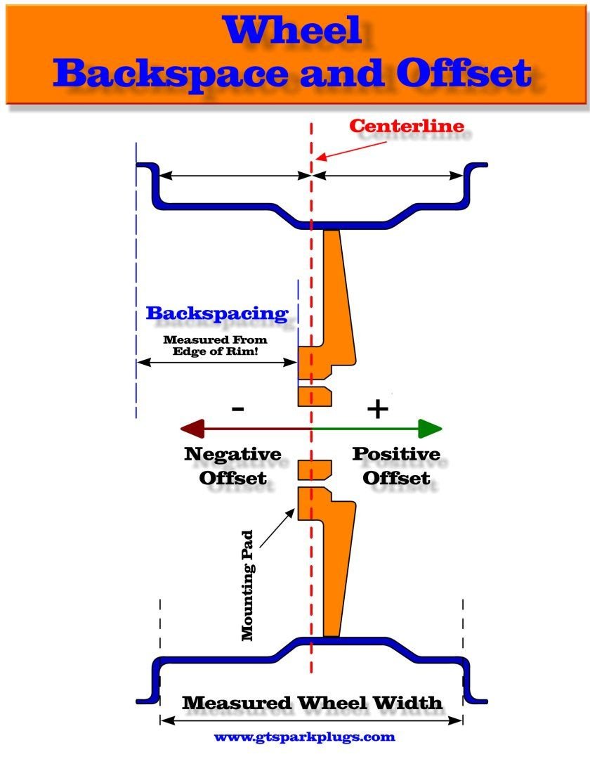

I'm confused somewhere along the line....
My logic.... 8" wheel, 4" back spacing = mounting face perfectly central within the wheel width, therefore Zero offset?
Yet on wheel websites etc I see 8" wheels with 4" back spacing showing as having 12mm offset.
What am I missing?

Just a terminology thing. The width of the wheel is the inside width at the tire lip. The offset and backspacing are measured from the outside edge, which typically adds 1/2" on either side. So the backspacing is based off of a 9" wheel, hence the non-zero offset.

Backspacing is measured from the inside, outer lip of the wheel to the mounting flange, while offset is measured from the center of the wheel to the mounting face. That 12mm (1/2”) is the difference between the outer lip of the wheel and the inner lip where the tire mounts.

As my previous question - if looking at aftermarket wheels, to maintain and not exceed current and tight inner clearances, I need a maximum of 4" back spacing, irrespective of width and offset?

Sounds right to me.

If you move to a larger diameter wheel, look may find more room. Look for posts by @cagotzmann, I think he has 18x9.5 wheels with 4.75" backspacing.
Otherwise, 4" max. You can remount the parking brake cable to the top of the arm to get more room.
