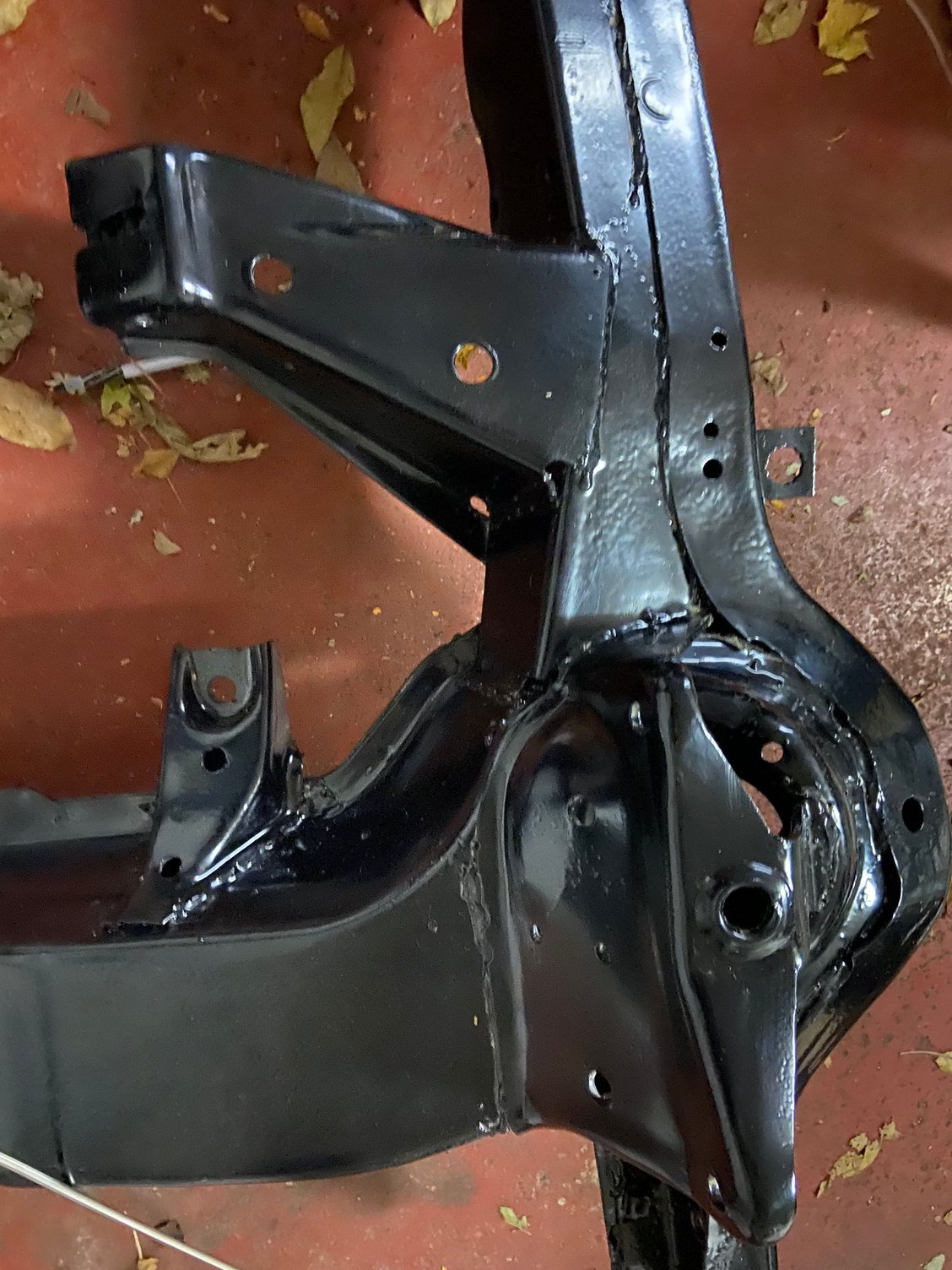

Old Nov 28, 2021 | 08:49 PM
vette68's Avatar
vette68
Joined: Dec 2000
Posts: 296
Likes: 190
From: North Olmsted Oh
Originally Posted by hunt4cleanair
Sounds quite reasonable. What gloss level did they use with the powder coat? Flat? Satin? Semi-gloss? And can you post a closeup of the frame to show the gloss level? Much appreciated.
The guy called it semi gloss black. This is the closeup. Looks really similar to the other powder coated parts I have (from numerous other vendors).

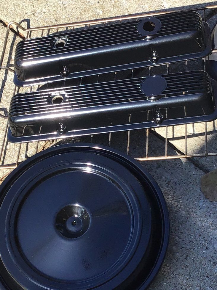

Old Nov 28, 2021 | 08:56 PM
interpon's Avatar
interpon
Joined: Jun 2019
Posts: 7,658
Likes: 2,470
From: Indiana
Looks nice!
current factory underbody powder coatings are epoxies ~60 gloss units +/- ~ 10 -20 units.
Gm black I’m pretty sure is still ‘848’ black.
i can find the exact number if needed..pic is that powder on valve covers and air cleaner top and 6 mile 79 frame which is not powder but for color gloss reference
