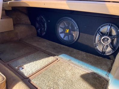

I'm looking for anyone that might have or know where I can find some plans for building a speaker cabinet for the rear of my 77. I might even be interested in buying one already built if someone has one for sale. I'm attaching a picture of what I'm looking for.

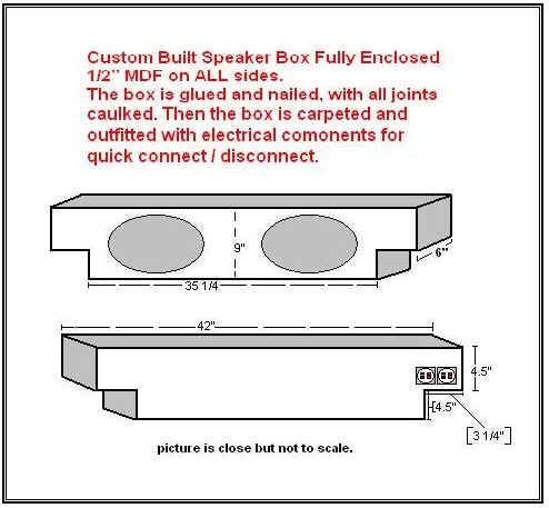

These were floating around the net a while ago, never checked the accuracy but a quick look should verify them
