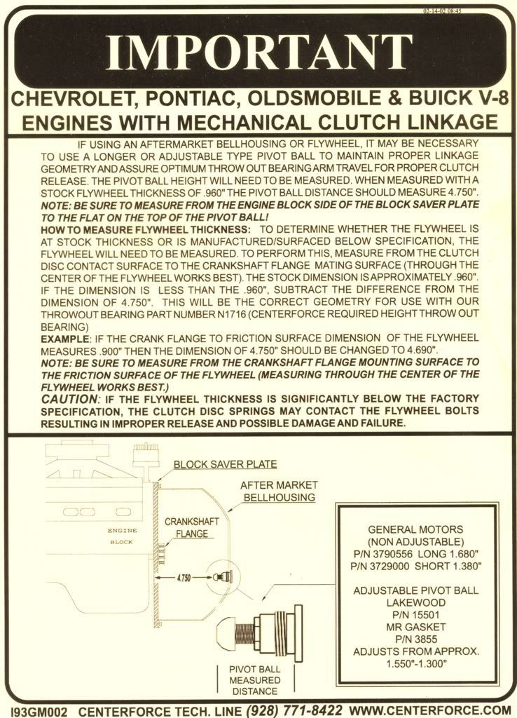

If the flywheel has been milled several time. There will be insufficient adjustment left on the adjustment rod with the original pivot ball on the bell housing. You will ether need an new flywheel or a longer pivot ball.

This thread may have some useful information.
https://www.corvetteforum.com/forums...and-specs.html

talked to a few guys who had same problem after changing fly wheel and all the had to adjust pivot ball so ill try that thanks
