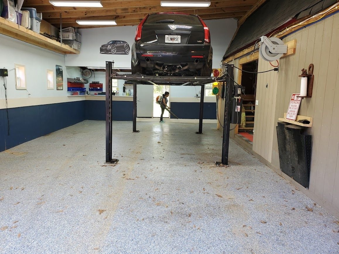

...this is my BackYard Buddy which was/were made in Niles, Ohio. Bought direct from the factory, had them load it right onto my 16ft car trailer with an overhead crane. I believe I paid $3600 for it back in '96. My garage ceiling is 9'8". I use mine mainly for storage though, don't use it for hardly any work.
