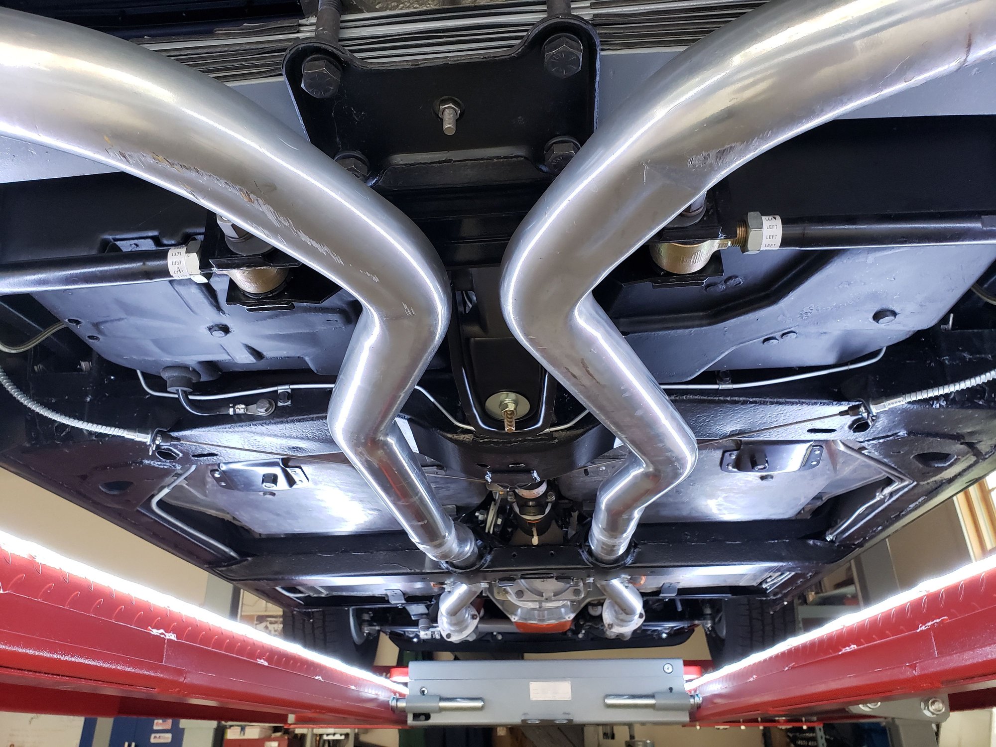

I have two BendPak HD-9's. Really like them. Get the 'wide' version - lots more flexibility if/when you put a wider car on it.
Rule of thumb: You need the height of both cars plus 10" to safely get your cars stacked.....
  • 4" for the ramps
  • 2" to get it on/off the stops (you can adjust the stops to your needs)
  • 2" clearance over the car that will be below it (again, you can adjust the stops)
  • 2" clearance between the stacked car and the ceiling for a little extra safety margin.
Don't let anyone tell you that you can do more work on your car with a 2 post vs. a 4 post. 2 post lifts are great, but I much prefer a 4 post lift. Stability, bridge jacks, etc. and you can do anything with a 4 poster.
I recommend letting someone set it up for you. Cost me around $400ish each to set them up. They delivered, set up, took waste away, etc.
Several good brands around. I researched and am glad I got the BendPak's. They make them in 110 or 220v. I got 220v because I had 220 in both side of my garage and wanted a faster lift. You need air to operate the stops - I prefer that over the 'rods', but that's a personal choice.

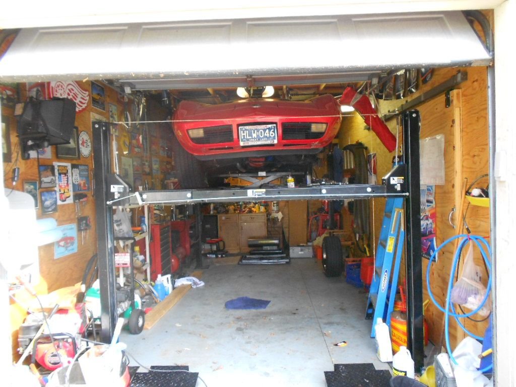

I have a Direct-Lift from Derek Weaver, ATL certified. I've had both, a nice 2-poster and now the 4-poster. I believe the 4-poster is the better lift, by a large margin. Stability and the ability to actually move the lift with the car on it. I always used stabilizing posts on the car with the 2-poster, the 4-post is as stable as they come. I used my tractor to unload the unit from my trailer, put the large pieces on 4-wheel dollies, and assembled it totally by myself (and I'm 66).

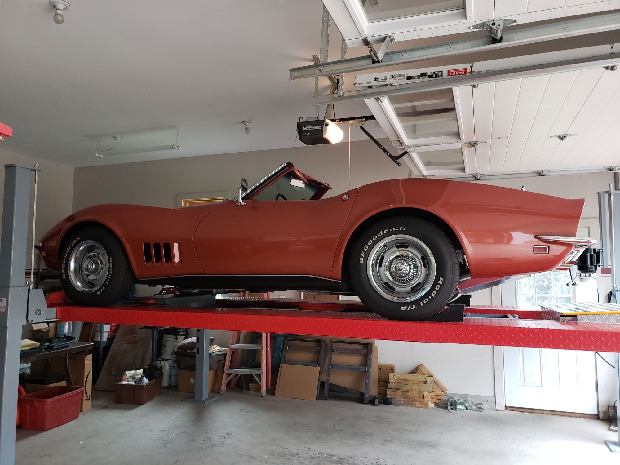

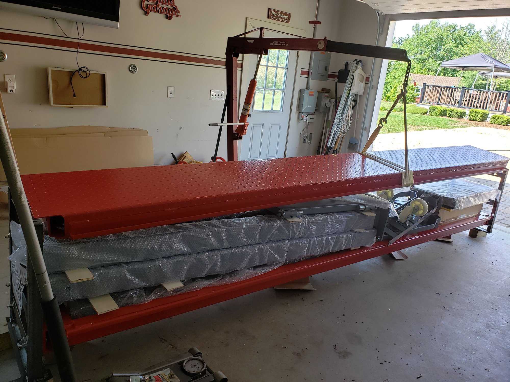

Not sure if you purchased or not. Here are a couple pictures of my Advantage Lift DX9000HD. I bought the air bridge jack, it comes with a sliding jack try also. I also added the LED lighting package. It comes with aluminum ramps standard. These ramps are a big plus being aluminum. My ceilings are 11 feet. I am converting to high lift door tracks with a side winder opener. I'm 5'7" and can stand under the car. It lifts the car 6' to the bottom of the ramp. I live in MA and picked it up to save on deliver and installed it myself with the use of my cherry picker. They have a warehouse in RI. What sold me on this lift is the fact the corners are totally incased by the crossmember. It's not a C channel design. I wrench pretty hard and this thing does not move. Very stable.

Thanks, what's your garage ceiling height?

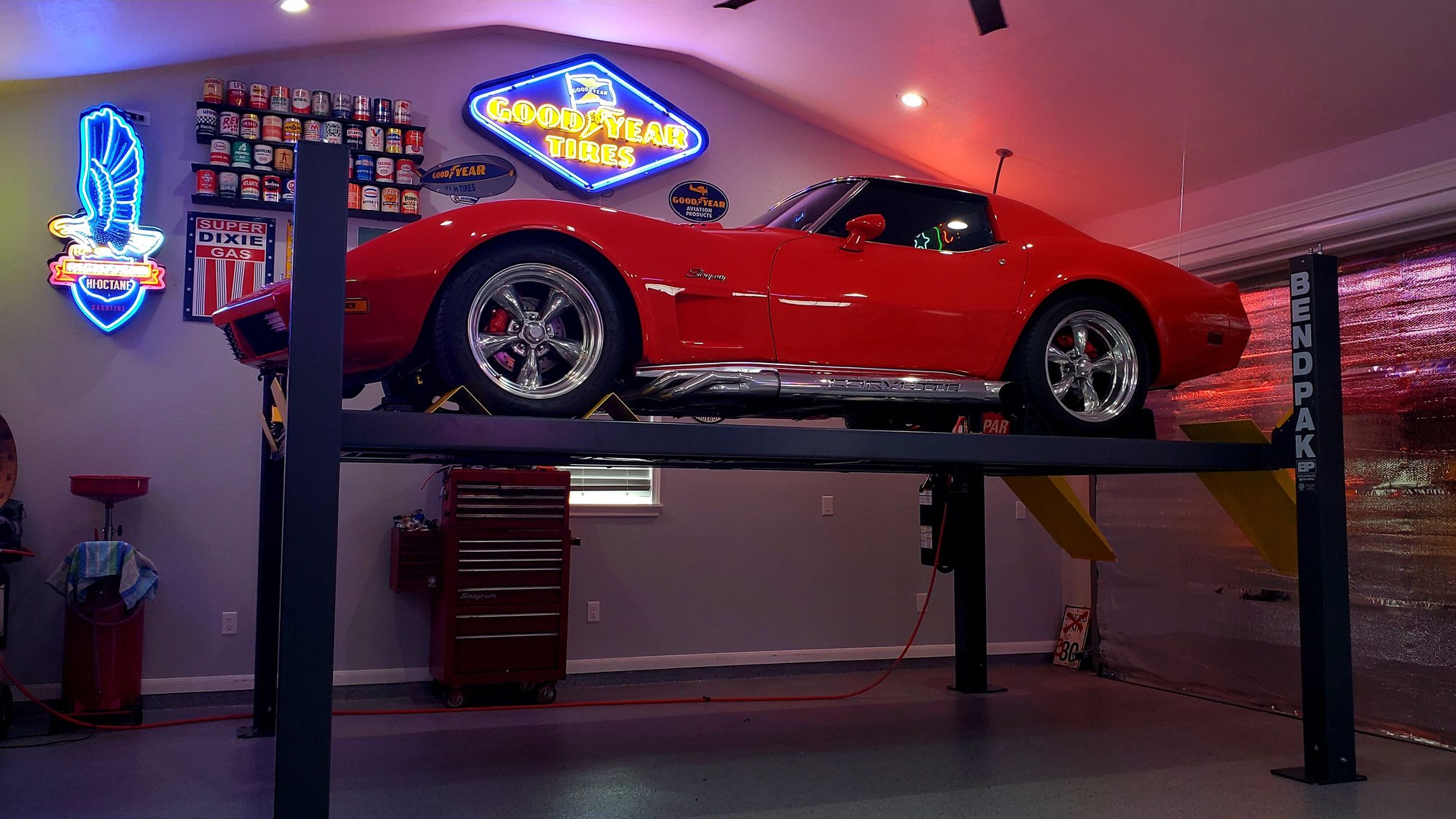

I have a 10ft ceiling with my 4-post lift
I have done a lot of work on my 73.
Brakes, exhaust, tire rotations plus others.
Best investment I made. I can clearly walk under the car when I have it up
You are most welcome. It's 10' 4" on the side with our son's Terrain under it. That allows his Terrain and a C3 or C7 on top of it (height of either is around 48"). It's 10' 6" on the other side.
Hope that helps. Paul

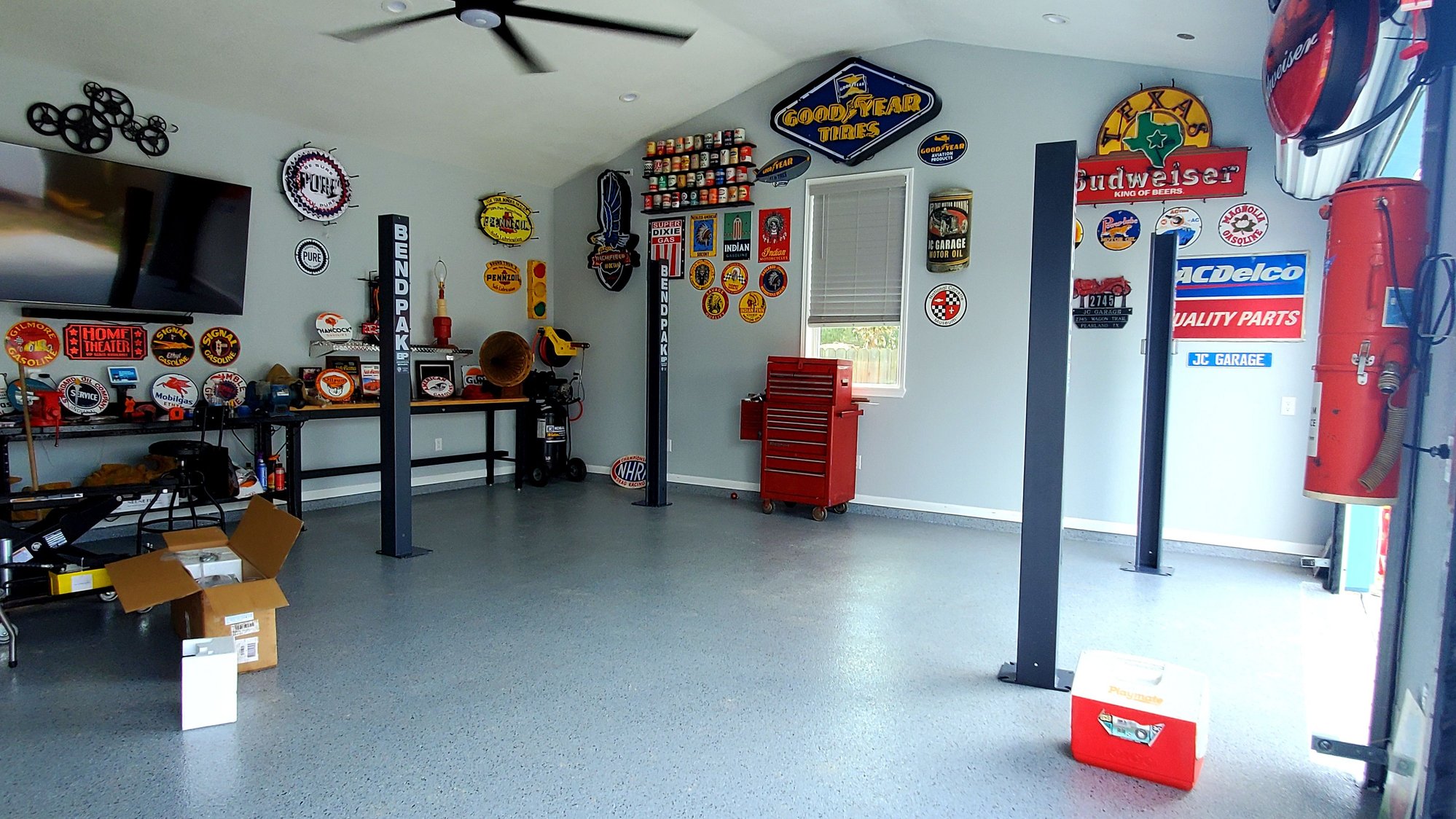

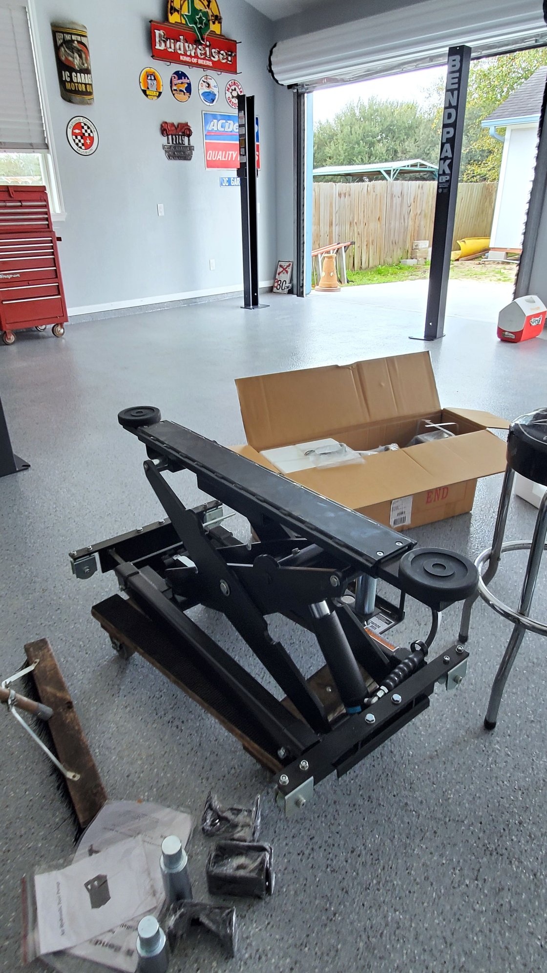

Bendpak HD9 with a low profile rolling Jack 220V. its about a month old tho and it's a game changer around here! I have 14 ft ceilings at the center just for extra assurance. it is too a new build. I had to hurry up and buy it even before
garage was finished just to lock it in at current price! Shipping was free and I had it shipped directly to my installer which he checked for shipping damages if any prior to signing off on it!

Holy cow Redcruz1120! I was getting excited about my plans for a somewhat modified pole building but now:
But you did give me some good ideas for the inside of the garage.

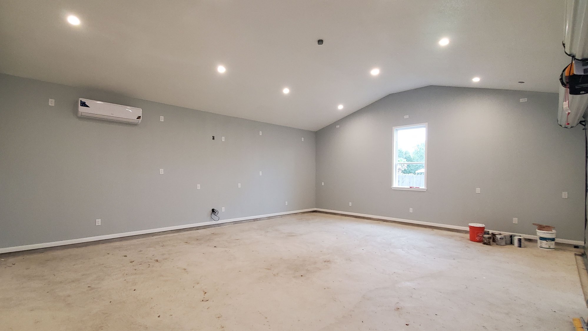

So, when we moved I went from having a big metal building for a shop to an attached garage. When building our house I told my wife I would compromise,if I had a 3 car front load vs the builder's typical L shaped. I was originally planning for a bendpak gran prix 2 post, but there was a structural wall required between the 2 bay and the 3rd single bay, and the 2 post would cause me to just lose too much floor space. I found the smallest profile 4 post instead: a cheap amazon lift, branded triumph. Its not fancy but it works great, runs off 110v (even though I had dedicated 220v installed), and the posts fit under a standard garage door track. I then picked up 2 sliding bridge jacks (definitely recommend). I like the setup better than working off a 2 post.
