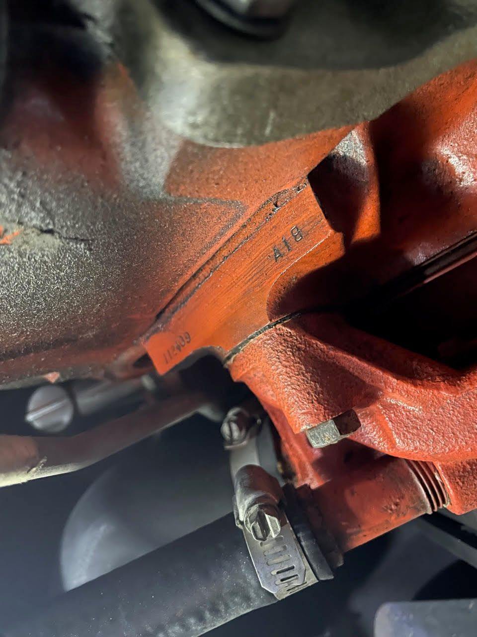

Hi all,
My first query:
Strongly considering buying this 1970 "L46". It's on the other side of the (ok, small) country.
Seller admits that it's not a numbers matching car, but what the heck kind of engine code is "A18"???? I can't find it anywhere on the 'net. Wouldn't've believed it if he hadn't sent a photo (see attached).

A18 is not a Corvette code. My guess would be a rebuilder's stamp. FWIW: looks a little like a backwards alpha B to me.

"...a rebuilder's stamp..."
How does that work - do some rebuilders grind off the original and then put their own stamp on it?
Seriously, I really have no idea.

Basically when you rebuild an engine, they remove the heads and 'deck the block'...meaning they machine all the way across the head mounting plane...which continues onto the stamping pad area...where they, ignorantly or on purpose removed the numbers by machining them off to true up the block.
'Camels humps' is an expression...it refers to the casting marks on the ends of the heads, plainly visible, which looks like two camels humps. This signifys the 2.02 and 1.60 valve sizes showing high performance (big valve) heads which were part of the L-46 specification.
The Harmonic damper is the round thing on the end of the crank shaft behind the radiator. Low power engines generally have 6.5" and the L-46 should be 8" in diameter.
L-46 has 4 bolt main 'saddles' which can't be seen easily.
I'm sure one of our forum members can post up the picture of the camels humps... all indications of a true L-46 350hp/ 350Cu.in, engine (which is highly desirable.)

I wouldn't be asking what it is if it were a readily-recognizable Corvette code... ;-)
But, indeed, I wonder if it is a real Corvette block or a truck block or a Pontiac/Buick/whatever block.
The pictures provided look like an LT-1 from above, but that's all cosmetic.
Thanks,
Steve

At the end of the day, A Chevy block is a Chevy block.
What it came in originally makes little difference.
How it was rebuilt makes a huge difference.
is it a 4 bolt main block? What crank and rods are in it?
Pistons? But the block is just that, a block. they are all the same. Truck, Impala, Camaro. Whatever.

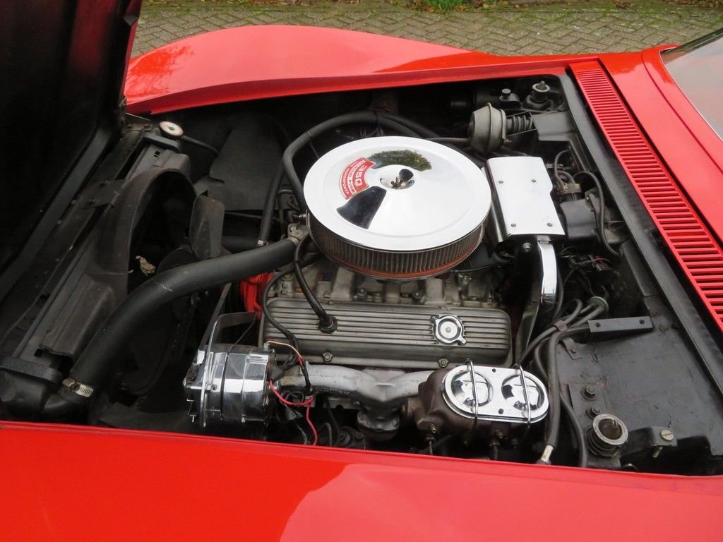

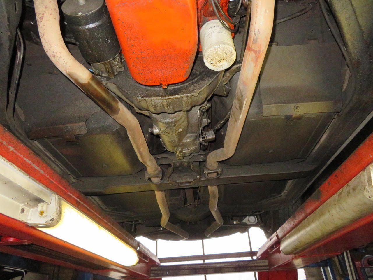

Thanks! The only engine pix I have are thus:

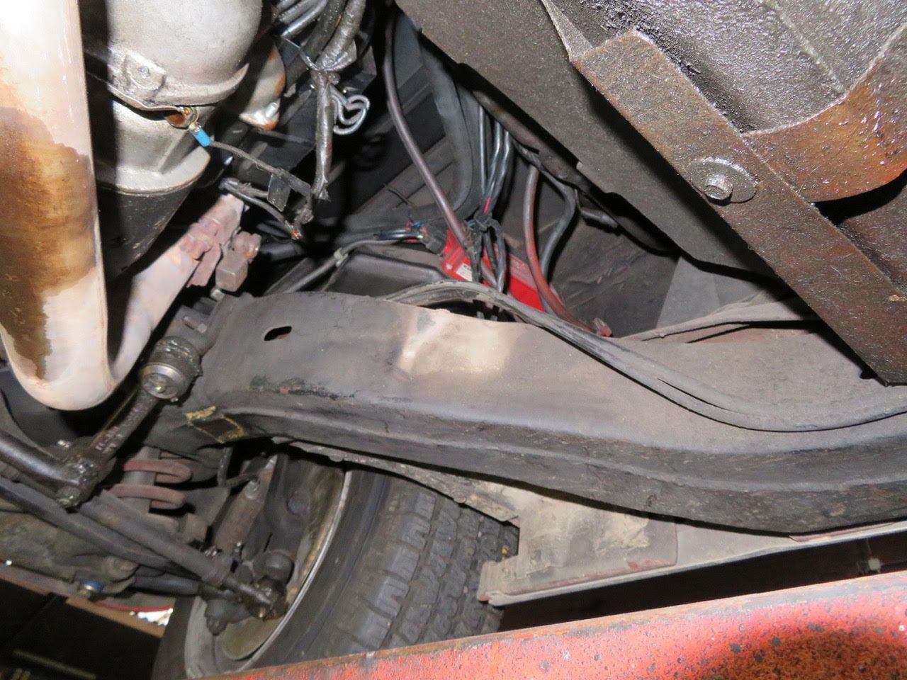

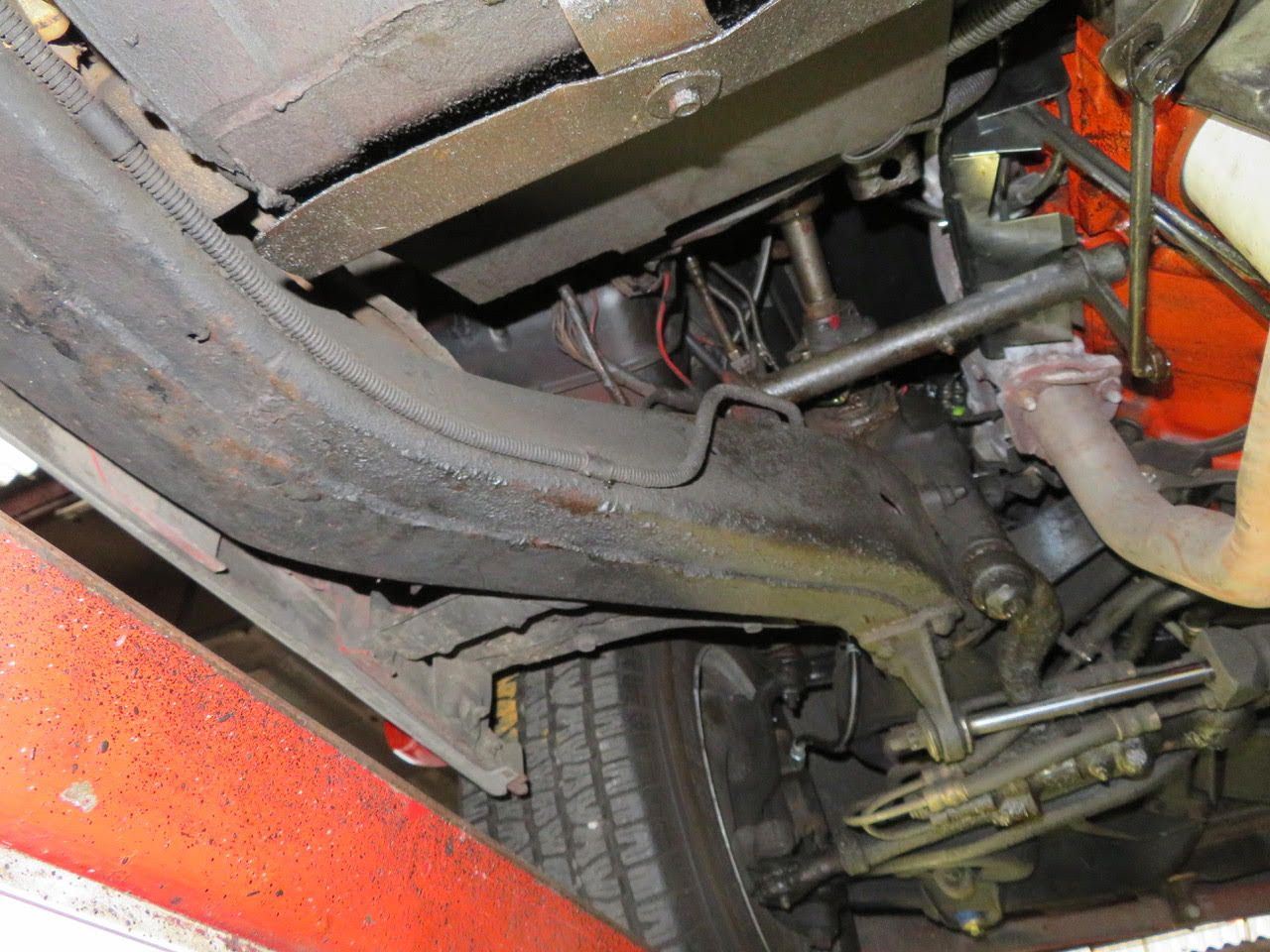

While the car looks great, on the surface, if I had to prioritize my concerns, I'd be far more concerned about the condition of the "birdcage" (the steel structure that includes the windshield frame, as well as the steel that surrounds the cockpit), than I would be about the engine block. A bad birdcage is somewhat impossible to repair/replace, at least economically, yet it's a common problem with Corvettes of this era. In other words, a non numbers matching engine is a very minor hiccup, compared to a bad birdcage.

1970 350s use cylinder head 3927186, for 350hp and 300hp. 300hp motor used 1.94 intake valve, so theres no indication of valve size form the camel humps.

it MAYBE WAS an L46. now it could be a 283-400. check the block casting number and date codes on back of block. check head casting numbers under valve cover. get a borescope and pull a plug and drain the oil. stick borescope in bottom to check for forged crand and 4 bolt mains. through plug hole to see whether dome-flat or dished pistons. and STILL you won't know everything about this engine. but 40k euros? i think a little high with correct orig engine. frame and underside looks pretty good. here is a more in-depth write-up on what to look for. roll down to post 107. https://www.corvetteforum.com/forums...orvette-6.html

If the seller thinks that underside pics will satisfy you on condition of the birdcage be very careful dealing with him . I see a car that's had multiple oil leaks for a long time , missing or moved elsewhere wiper door actuator relay , Also see that the fan shroud has been smashed ! just to start with . He couldn't be bothered fixing it or at least cleaning it to sell , but now he wants to sell it , its worth a fortune !

It does not have L-46 heads for sure. That engine is just an engine. That is not an L-46 so it is not worth L-46 money. Ignore the engine and look behind the kick panels for corrosion. Price accordingly.
