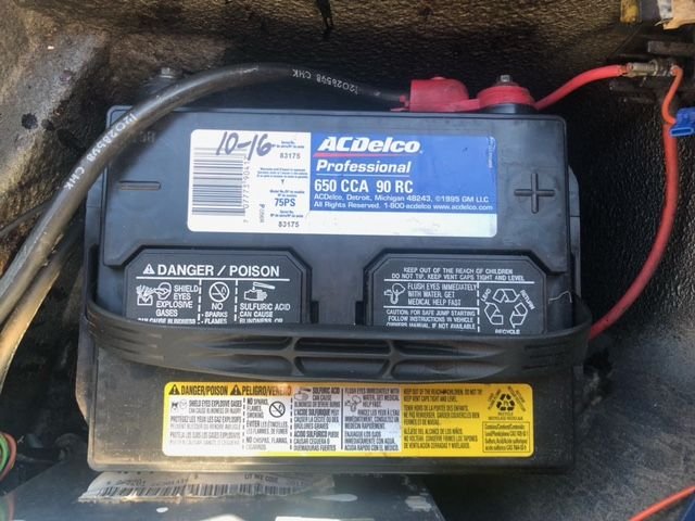

The battery seems to be in good condition (see image below)
Here is a video of my last startup attempt (see video below)

If that battery is october 2016.. i would change it as 5 year is about lifespan for most reliable imo
at least see if there is water in battery
what is a 750 amp charger????? That would boil a battery

I just had to replace a 2016 battery in my 1991 yesterday. An interior light drained it pretty quick then it failed a load test after charging. I would start by load testing that battery - it is easy and free at a local auto parts store. You just need to charge it first. I like to check easy and inexpensive first.

When I hear clicking like that its usually the battery.

get that battery load tested. it's probably shot. that clicking indicates that it is not providing the necessary power. It's way old. When you get the new battery, start the car, and take a voltage reading at the terminals at idle. If your alternator is not working adequately it will kill your new battery.
Check your battery terminals (I know they are side mounted, but just to ensure they're not corroded badly under there), clean the contact surfaces as best possible. After that, you can try jumping it again but make sure that let the cables be hooked up for 5 minutes before going to START.

What He said. Clean the battery cable ends. Even if they look good they can have corrosion you can't see that will stop electrical flow. Disconnect the cables and jump the car. This will eliminate the old battery from robbing energy from the jump.
