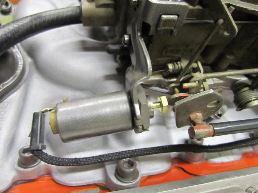

Run-on after ignition shut-off is caused by the throttle opening being excessive at idle/shutdown. You need to lower your idle speed and decrease the throttle opening. Excessive throttle opening is often caused by retarded timing, which requires the idle speed to be set higher in order to maintain engine idle rpm. Make sure your timing is far enough advanced, and run your vacuum advance off of a manifold vacuum port to allow you to back off your idle speed screw. If this does not fix the problem, you need to install an idle solenoid. This was the factory fix for the run-on issue. The solenoid establishes the idle speed you desire, and the carb's idle speed screw is set to a very low idle speed (about 600-650). Upon ignition shutoff, the solenoid collapses, and closes the throttle to prevent the run-on, as Mooser correctly stated in his first post to you above. Again: The problem is caused by excessive throttle opening at shutdown. Mark (stingr69) nailed it correctly in his post above - everything he stated is correct.

Since you're not sure, here's the idle stop solenoid, when the key is on, that brass colored hex plunger sticking out the right end would press against the plate in front of it that the throttle cable is hooked to and raise the idle higher than where it is on the screw stop down below it in the background there
(ignore the colors and everything else that's not "correct")
M
