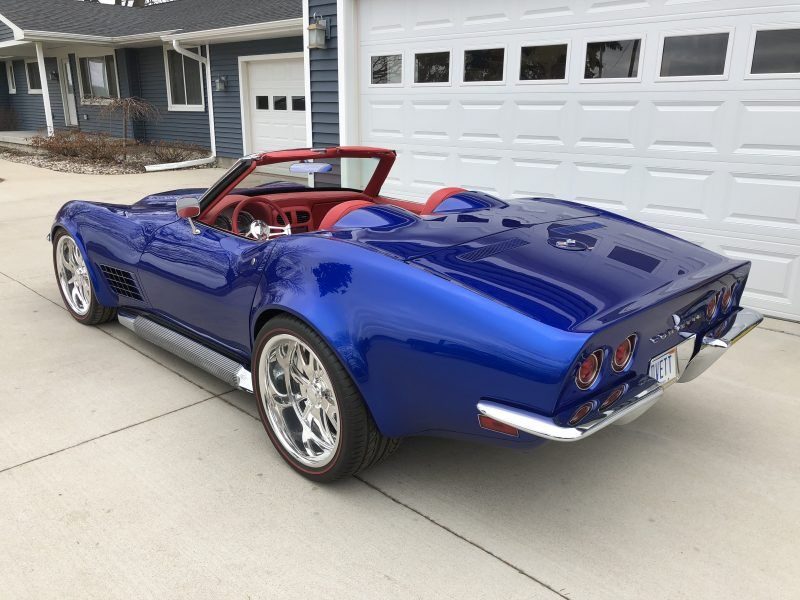

The CIC 2" flares look great!
You can barely tell they are on there, until you realize the wheel is too wide! LOL
Here's one. It's even blue.

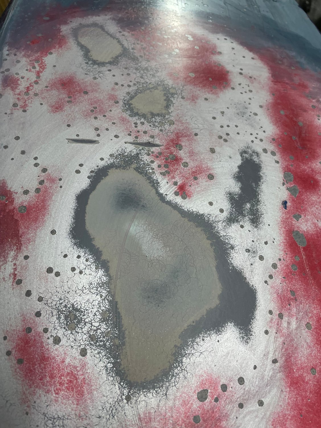

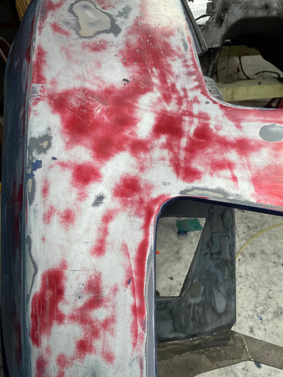

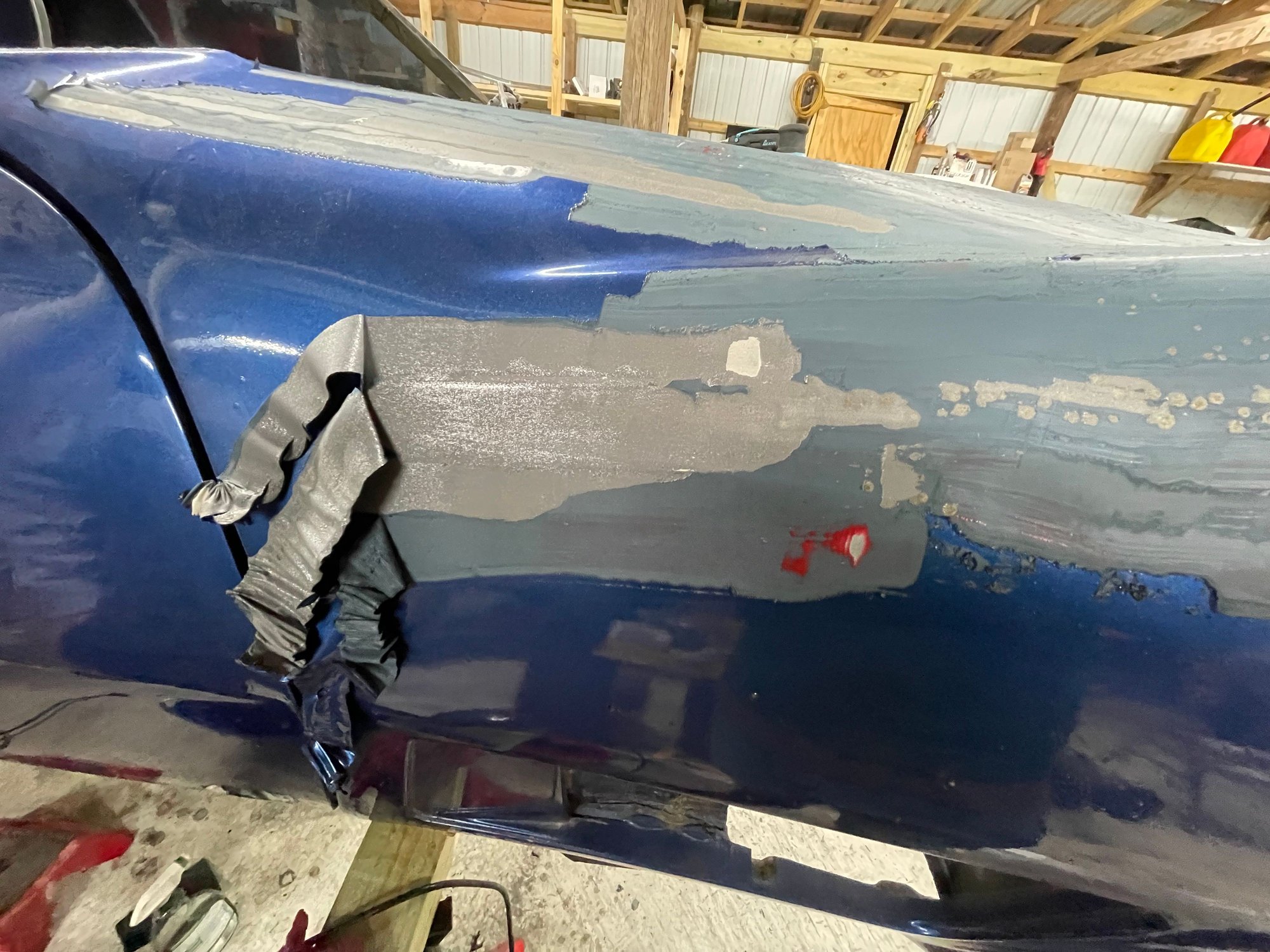

Did an another experiment tonight that produced good results: Since there was a thick mucky later of 1K primer under the several paint jobs i'm scraping off, I tested out how easy it would be to wipe off with acetone. This worked great, and it exposed what's left of the final paint job on my car that I'll have to block out. I may stick with this, because whatever containment is in the paint causing the pimples is cleaned away by doing this before is sanded into the car. Hitting it with the DA isn't exactly hard either and does quick work, so I'll keep experimenting.
Here's what's left after scraping two blue paint jobs off the top, and cleaning with acetone:
The good news is that I've been seeing that these pimple spots dont go to the fiberglass anywhere, and stop at the primer below the silver layer. This is a relief that there's not oil soaked into my fiberglass!
I think I'll put some paint stripper on what's left tomorrow and see what happens. Slowly but surely, I'll have all this paint off this car!!!

Would those pimples be solvent pop?

It could be solvent pop or water or something? Whatever is was, it happened on the first repaint. Looks like after it would pop back up, they would scuff and repaint the car until it'd pop up again! three re-paints total. I'm going to get it down to glass and scrub with dawn and water , then lots of acetone to ensure it's clean! First layer will be epoxy primer to seal it as well.

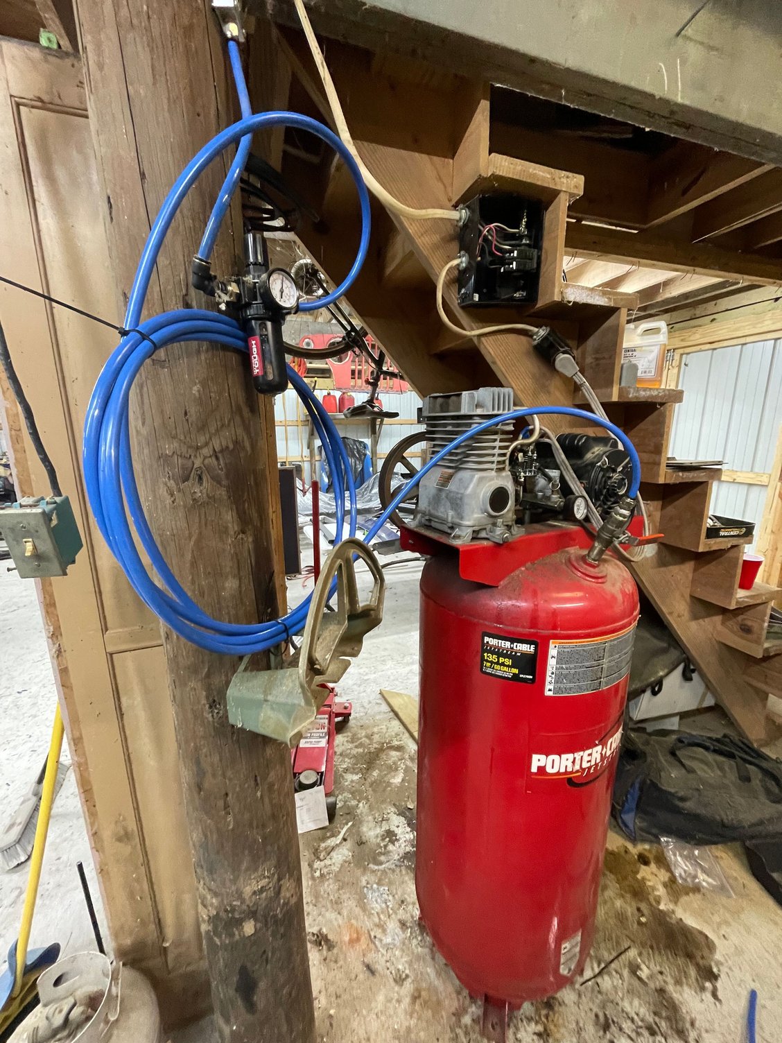

Tonight started with some maintenance in the shop on my compressor. The pressure switch had gone out last week, and the new one finally came in today. I took advantage of this opportunity to do a full tune up and mods to m shop compressor:
  1. New pressure switch and resealed the other lines
  2. changed the oil in the pump
  3. installed a long drain with ball valve so I can easily drain the tank frequently
  4. Put in a roll of air line to allow water to condensate before the water separator

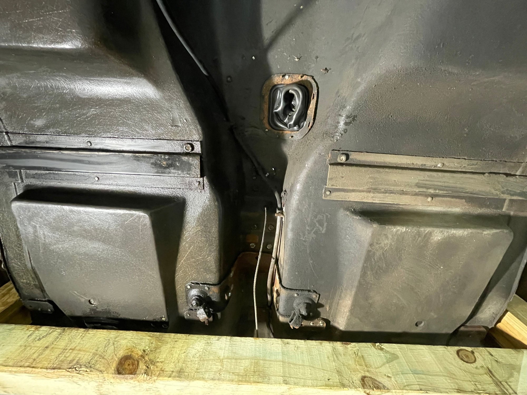

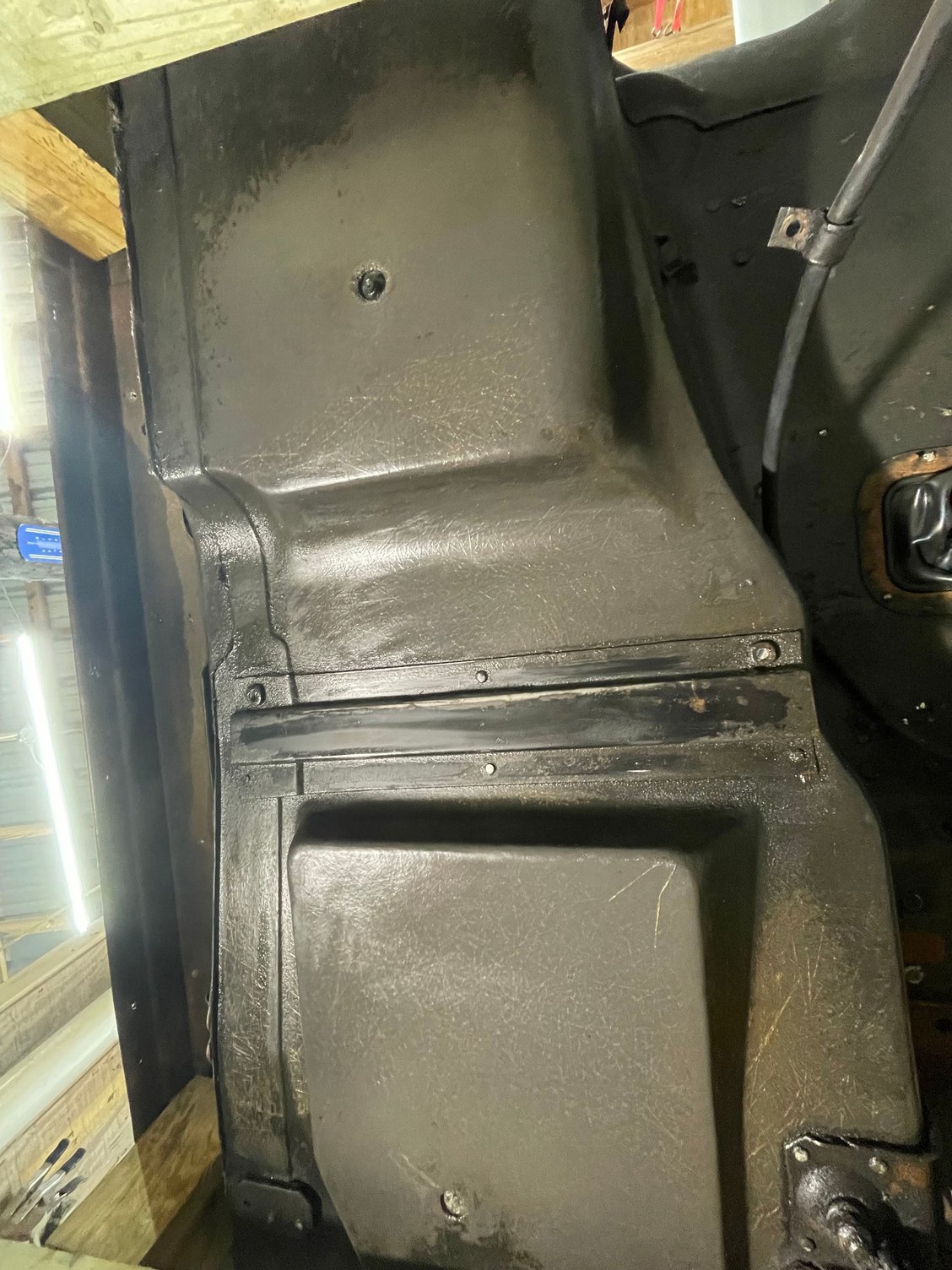

I think went into my once a week routine work of degreasing and scrubbing the underside of the body.. It's not fun and it's messy, but that 50 years of grime has got to go! Here you can see on the left side it went from grimey black to clean exposed fiberglass as it should be. Still have more to do, but making progress on the underside!

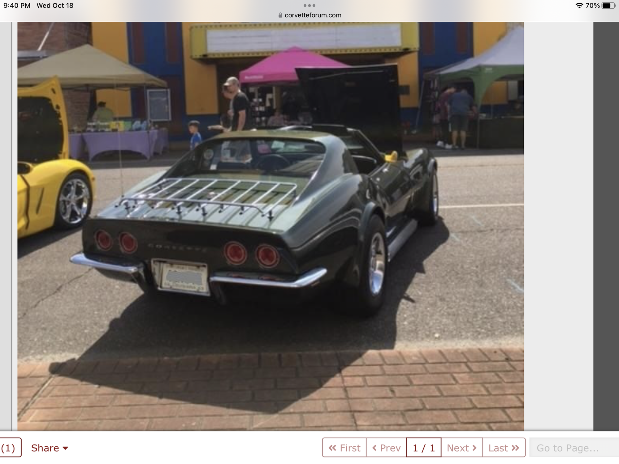

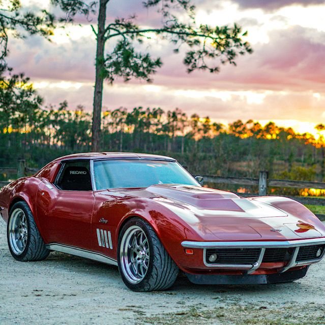

Here is a picture of a 69 that was entered in the 2023 C3 of the year, modified competition and it has 2” flares all around. Looks super nice.

This is Justin's C3, and that car is GORGEOUS in person! We meet at the St Jude Spring car show every year. I believe the story on those flares is the PO grafted on 70-72 flares when it was getting painted. The Fathom green on that car is impressive!

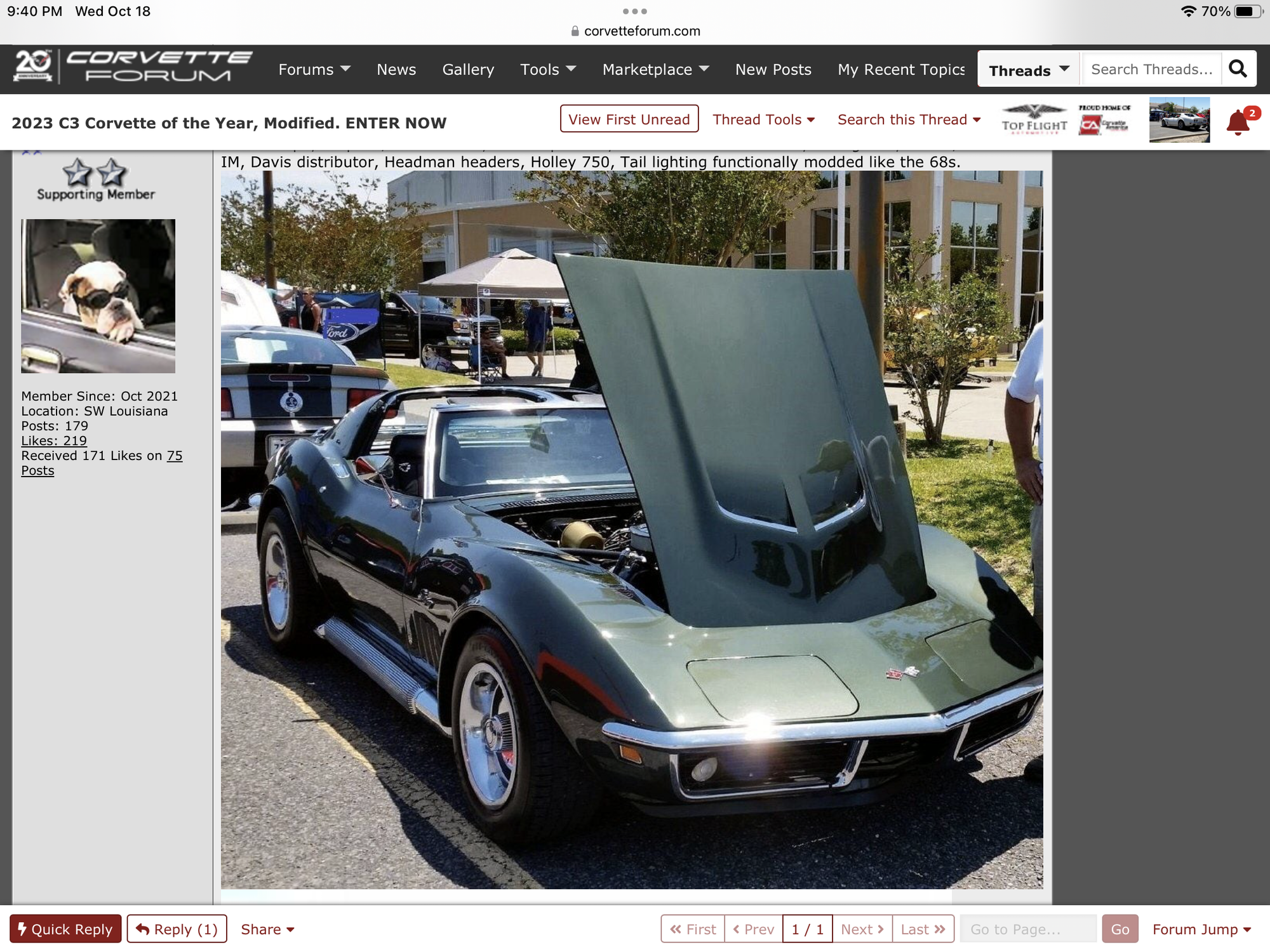

My painter suggested that I paint mine fathom green.
I think I’m going for it especially after he painted a panel for me.

I never paid much attention to that color until I saw it in person and it's absolutely stunning! I think you'd love it!

Fathom green is close to the F8 Dodge green that I was set on, but it’s a little darker and without as much bling.
I’m glad my painter suggested it and painted a panel.

Thanks for the kind words, Gentlemen! As most already know, GM went to 8" rims on the '69. It wasn't long after, owners began complaining about damage to paint on the sides and rear due to road debris. His car was no different and experienced the same problems. This issue was resolved by extending the fenders on the '70 and later years. When he had the car repainted (same original color) 25 years ago, the extended flares were installed at the same time and his road rash issue disappeared. I don't know who the manufacturer of flares are, but they are well made pieces and the installation was very well done.
OCB, I think you will like the color. It is very sensitive to sunlight and it really wakes it up. Not overbearing, but just enough to grab your attention from the reds, yellows and blacks that are always on hand at car shows. And, as my painter friend said, it is an easy color to match for touch ups.
