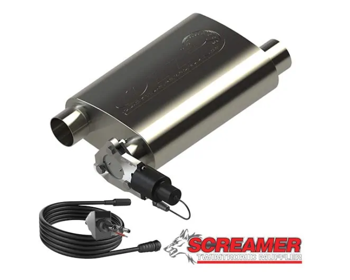

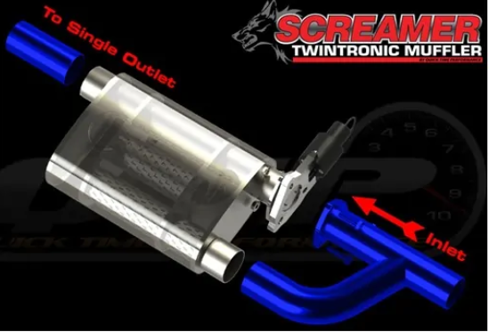

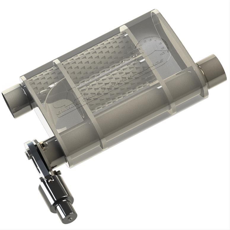

Here's you go-
Made by QTP. I've used their cut-outs before- good product.
My wife's mustang has a very similar exhaust/ muffler and she loves it!!!
Straight pipe with the flick of a switch
https://www.summitracing.com/parts/qtp-13251c

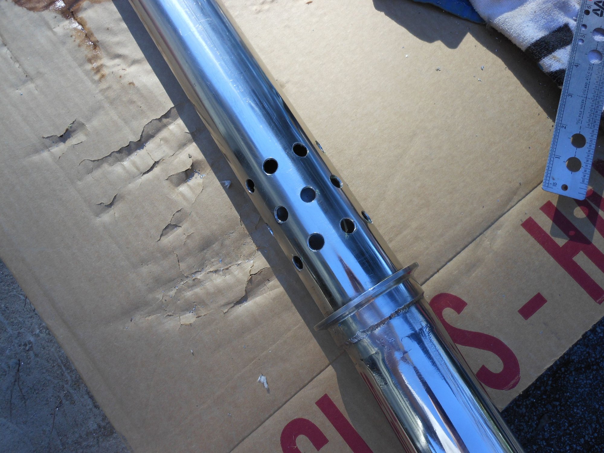

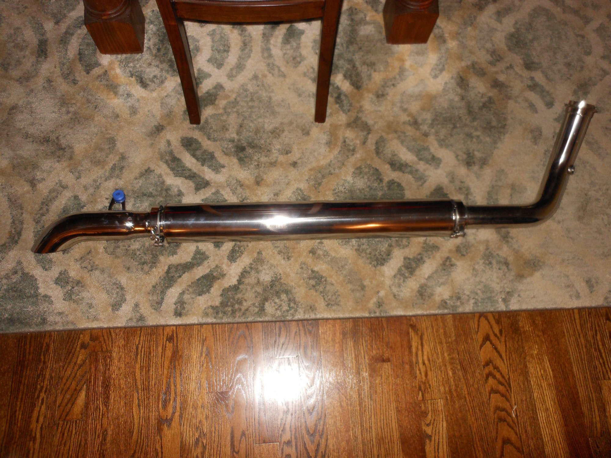

I made my own- but did it with sidepipes.
I have 2½" straight pipe- and when I close (variable) the straight pipe the exhaust will flow through the outer muffler. So I have the best of both world at the flick of a switch.

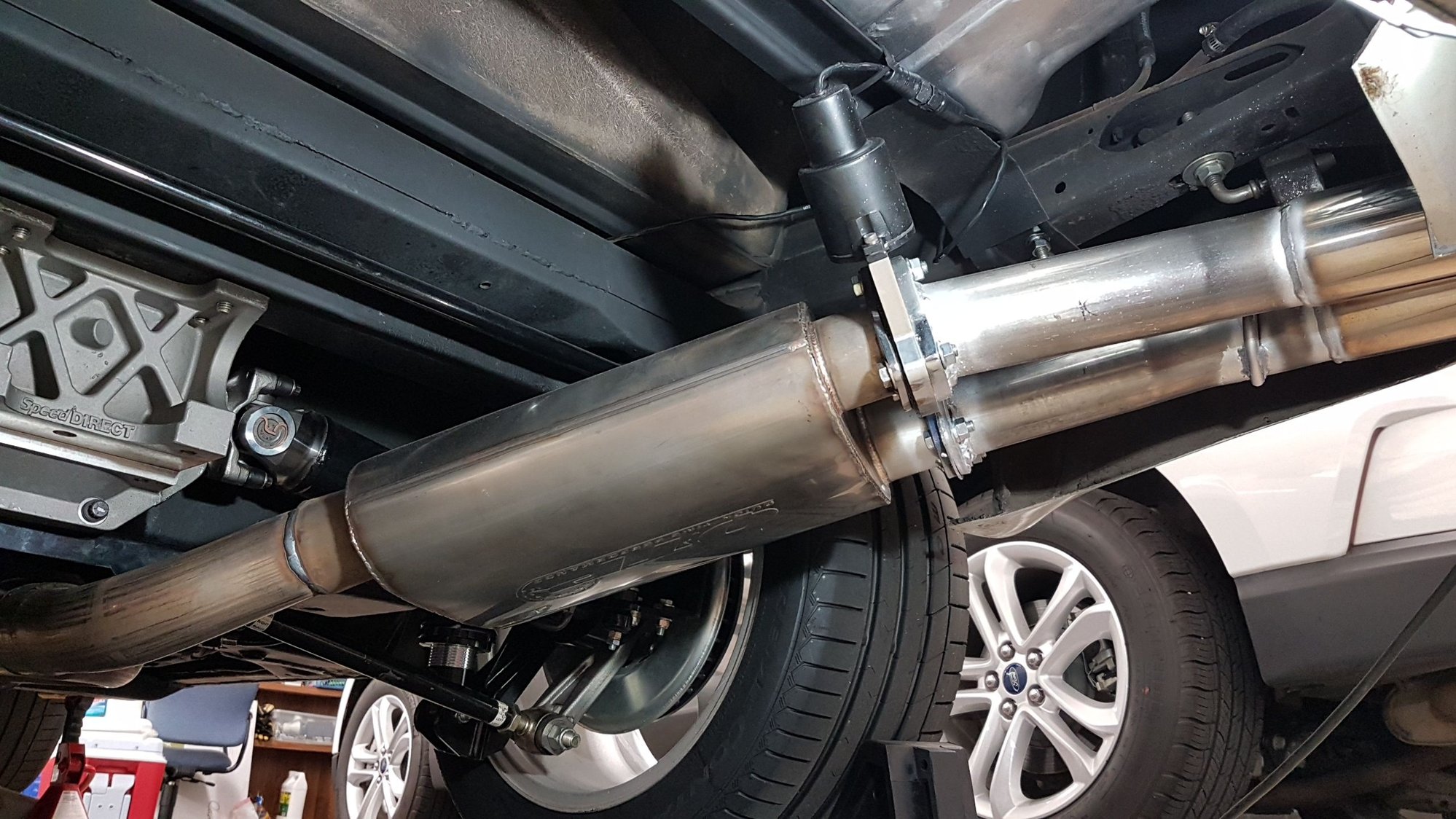

And fellow member "JohnRR"

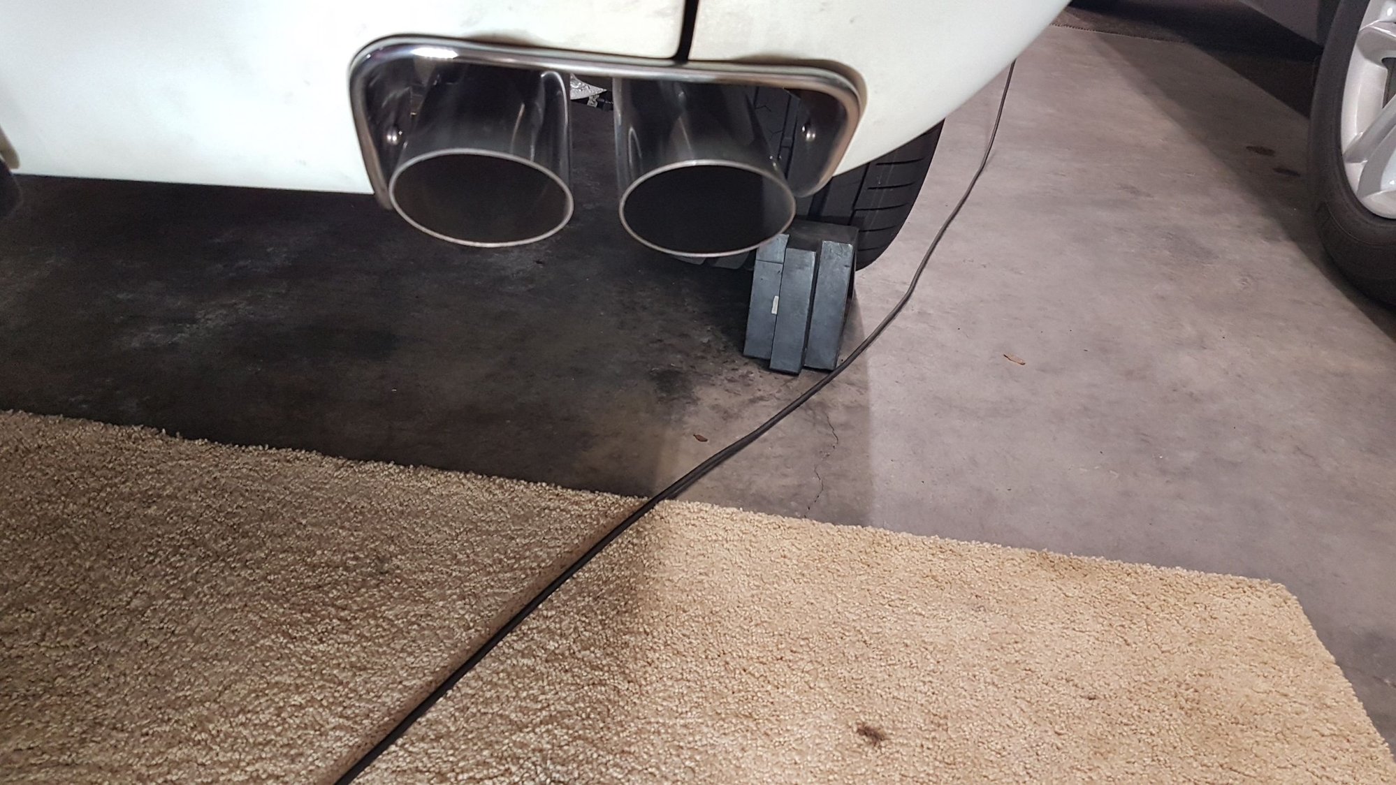

I finally got the QTP Screamer Mufflers installed with a key fob remote. I'm very happy with the sound. It has a nice aggressive tone when cruising without any drone. It's a bit louder with the valves open, but not too loud.
2.5" long case QTP Screamer Muffler.

looks good and must sound good but where did you get the 2 Exhaust tips
Old Feb 18, 2022 | 09:37 AM
derekderek's Avatar
derekderek
Posts: 13,082
Likes: 3,399
From: SW Florida.
these are all over the place in the boat world. these are the least pricey. https://www.spelabautoparts.com/prod...UaAlpiEALw_wcB
