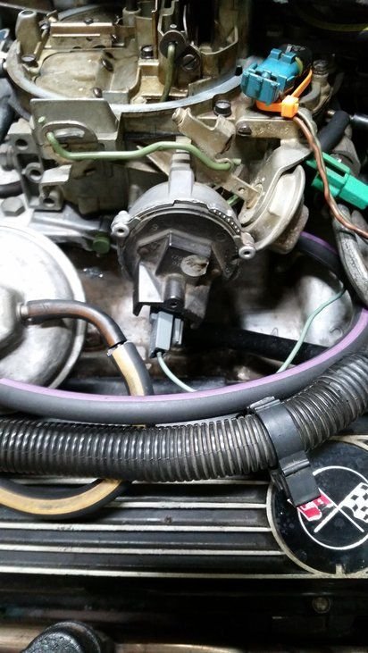

Could someone please send me a picture of your automatic electric choke on a 1981,or similar, mine has no wire to it,and I see several wires close to it,but see no way they could fit,and on the choke itself looks like it would be a wide clip to fit it,but would appreciate a picture,Thanks.

First, identify the correct wire. I believe it is light blue, but be sure to trace it back, and make sure it is hot at the correct time.
http://wordpress.keystonestatecorvet...m/?page_id=118
Here's my 80 the day after I bought her. Someone had crimped on a flat blade connector that worked, but isn't correct.
This might be the correct connector.
https://www.rockauto.com/en/catalog/...connector,2544

thanks, someone has broke mine then,but think I know which wire it is,so I will have to make something. Thanks,
