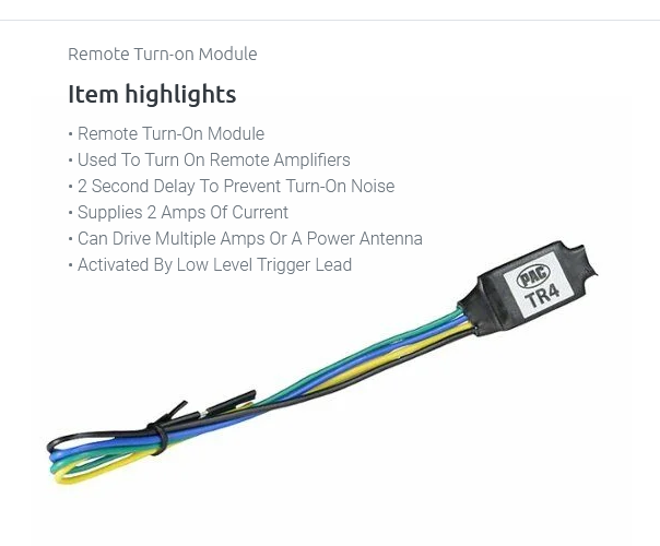

Here's a simple solution for an aftermarket universal antenna-
Black wire to ground-
Red to fused +12V constant
Blue trigger wire (+12v antenna goes up- no power goes down) to this-
https://www.sonicelectronix.com/item...-PAC-TR-4.html
This module will work with OEM radio. Can also be used for the OEM radio to turn on a amp.
