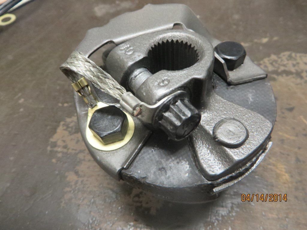

Got the box out. Removed the pitman arm from the box to pull it out. My new coupler does not have a ground strap on it. I noticed the one I pulled out does have one. What is this for?
Old May 7, 2022 | 11:50 PM
  #46
Bikespace's Avatar
Bikespace
Joined: Mar 2017
Posts: 11,953
Likes: 4,510
The horn button grounds through the steering column. Your old steering coupler had a ground strap. IIRC, some grounded through metallic fibers embedded in the rag joint.
At any rate, your new rag joint does not have embedded fibers. Use your old ground strap, or fashion a new one, if you want your horn to work.

The strap is connected under one of the pins which is not removable. Is there an alternative way anyone has used to make this ground?
Old May 8, 2022 | 06:36 PM
  #48
Bikespace's Avatar
Bikespace
Joined: Mar 2017
Posts: 11,953
Likes: 4,510
You just need to bridge across the rag joint. You could put two loop end splices on a short piece of wire. I used Flaming River U-Joints, that are metal, and conduct enough to work, but I still added a piece of wire (I can't find a picture right now, unfortunately).
https://www.corvetteforum.com/forums...post1586639592

ok thanks. That one looks great. For whatever reason my horn still works without the strap. I got the new box in along with the new coupler and took it for a short ride. So far so good. I’ll take it on higher speed tomorrow.
