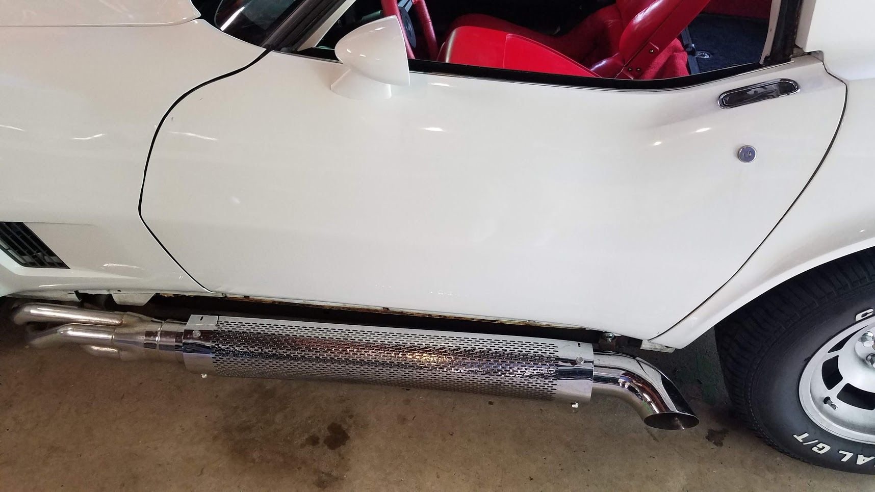

Hey Guys, I want to add side pipes to my ‘78 Anniversary Edition. I need a recommendation where to purchase. I’m running Hooker Headers with 3” out. TIA

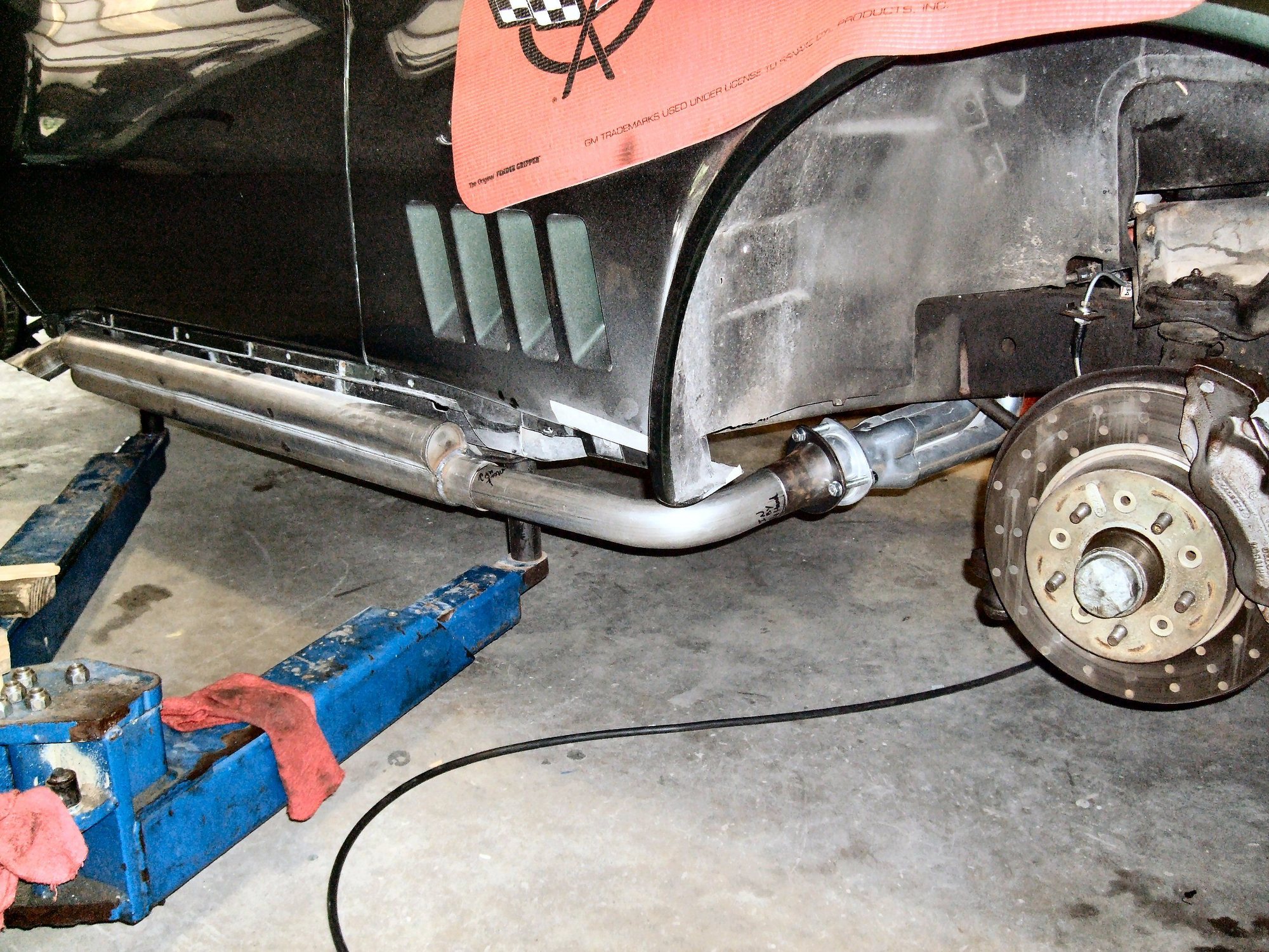

This is why a photo always helps on this Forum. I didn't realize Hooker made shorty headers, if that's what you have. Are you going for the stock (1969 only) look, or the long-tube headers to side pipes look?
FWIW, these are Hooker headers, too (with a DIY side pipe extension).

The photos help. I have the long tube headers from Hooker. I’m looking at the 60” side pipes with a shield. The single tube
connection to the side pipes is what I’m interested in. 👍

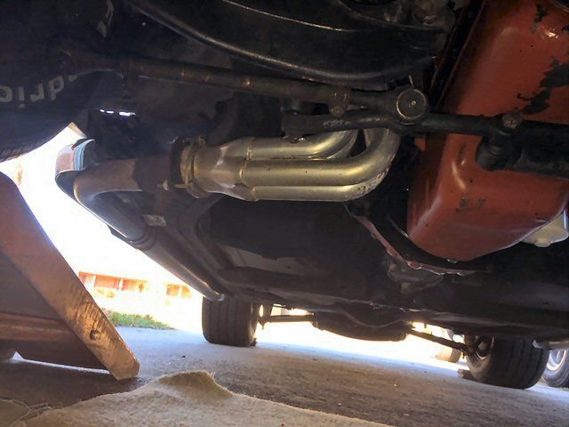

Originally Posted by FASTAZU
The factory C3 muffler hook-up would have to be modified as the are made to connect to the factory exhaust manifold.
Hedman Headers connected to factory sidepipes. Yes they have to be cut down, but not that much work for any muffler shop to connect them up.
Thanks for the picture did not know the headers were designed in this way. Just shows ya even after messing with C3's for 45 years you learn new stuff!!!
