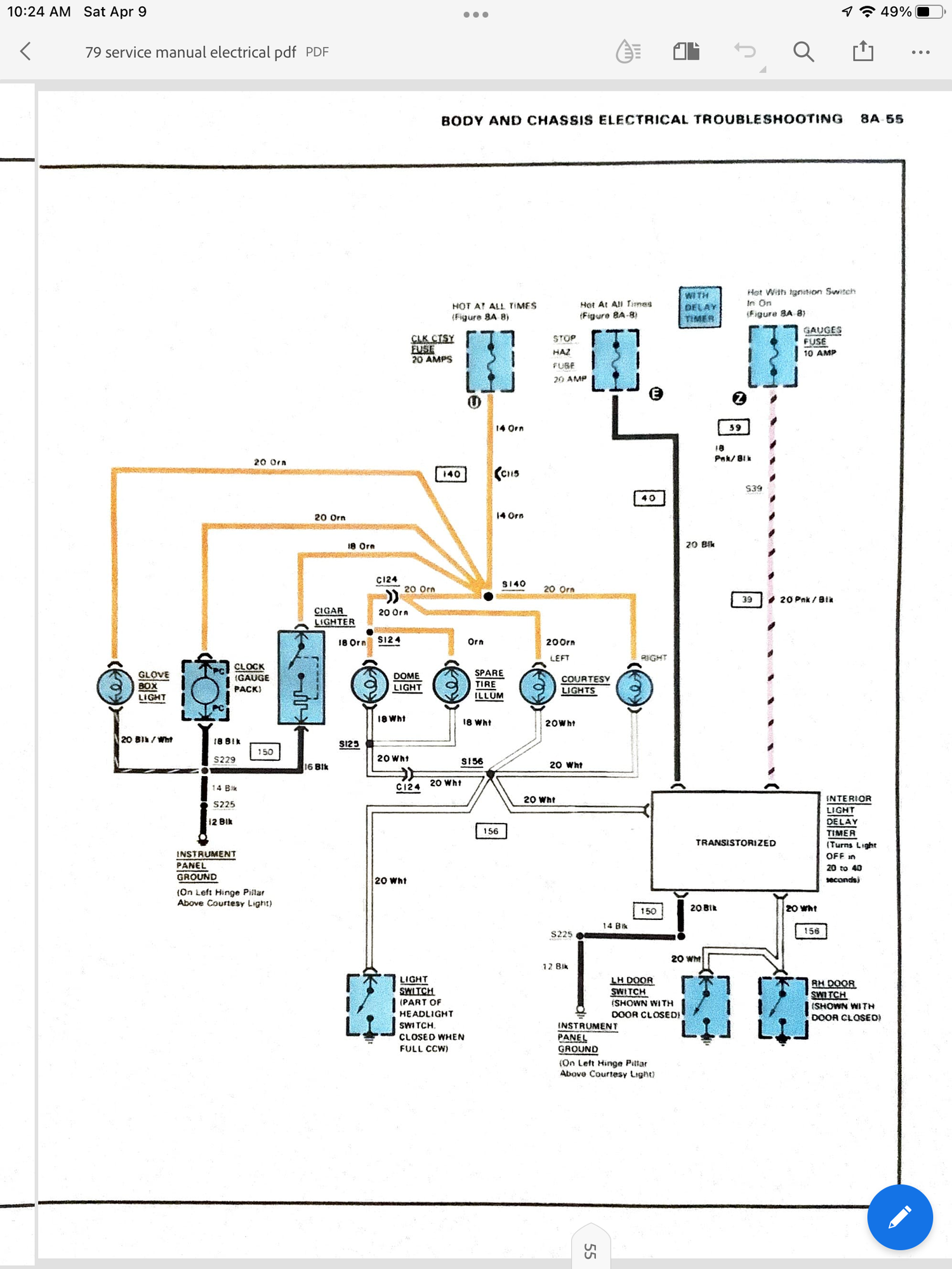

are cig lighters in shark cars fused? I know early GM cars are not.

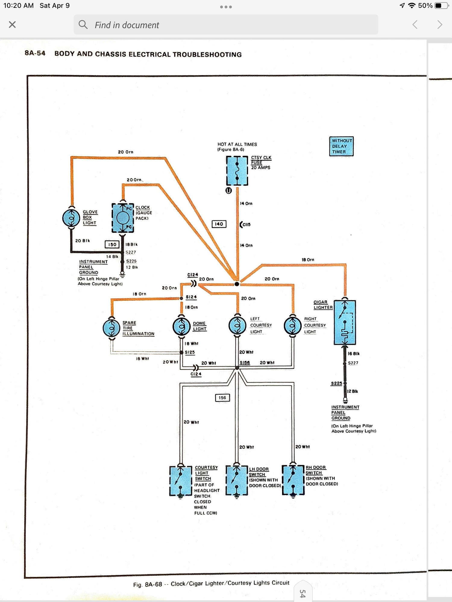

From: Seattle Area Washington
On a 77 a 20A fuse protects the CLK/LTR/CTSY circuit.

No clue what year op is..but 79 is 20 amp fused…no way are you going to out draw with a phone charger compared to heating an element.
should be no problem to use
With delay timer
that’s good for latter owners. But early ones that are not should be careful leaving things plugged in over a long time.
