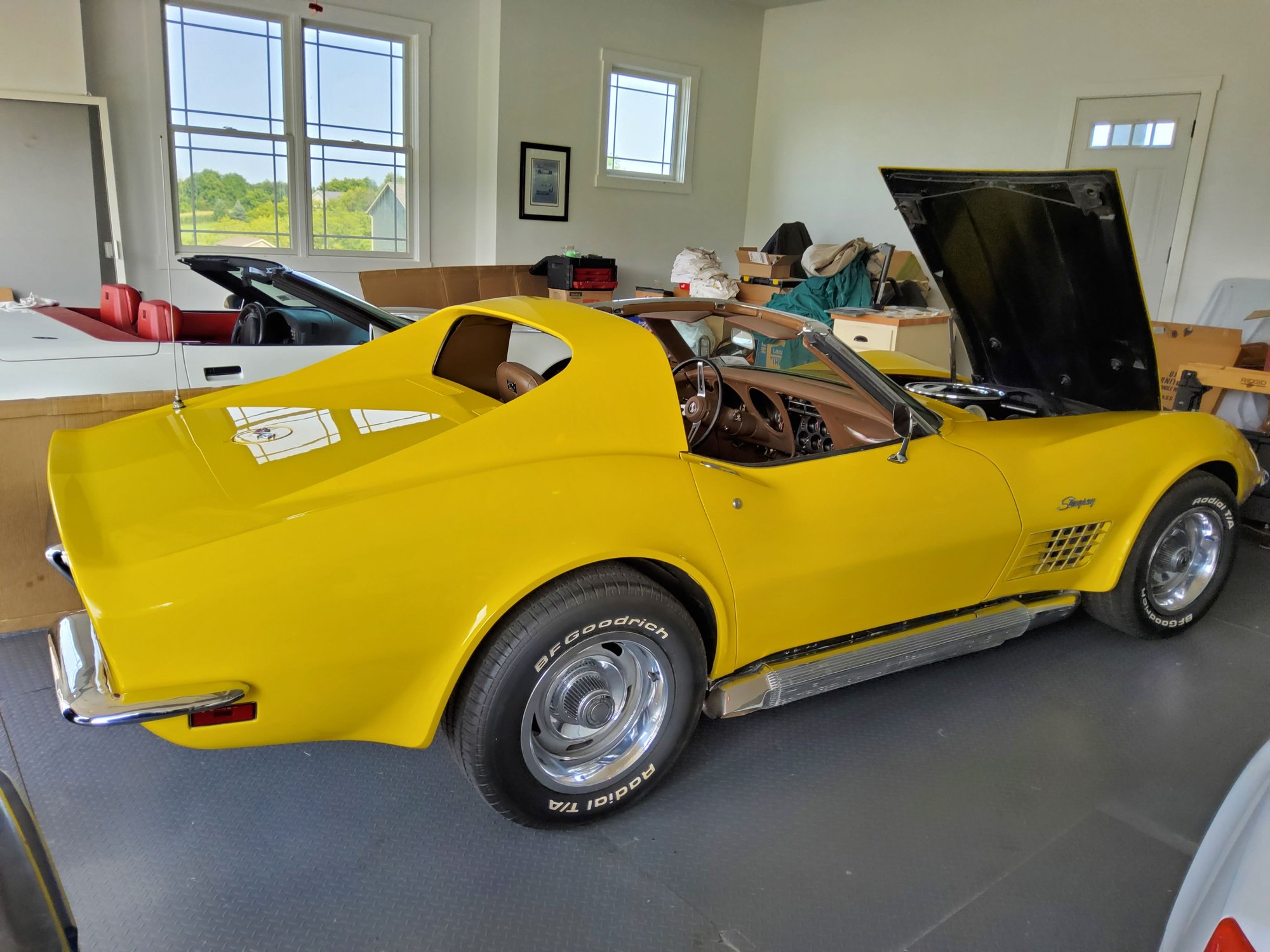

I'm finally in the market for a sports car and have always loved Corvettes. I have my eye on my neighbors car who is thinking about selling. I've looked at it acouple of times and had a corvette knowledgable friend check it out. So I'd like to know if this is a decent car for the price. Owner wants $20k and I don't think he will negociate. So between the owner and my friend here is what I have learned:
1. 1971 Coupe, 56k miles, 350/270 hp, Turbo 400 auto, PS, PB, PW, tilt, custom interior
2. Car runs good, wipers and headlights work fine
3. Matching numbers on block and tranny
4. My friend says the frame and birdcage look good
Now heres my rub
1. Not original paint - was ontario orange, repainted sunflower yellow, side pipes (look cool but loud)
2. Owner believes the seats were recovered in vinyl, not leather by a previous owner
3. Owner says the alternator and carb were replaced with Delco and Rochester appropriate ones, whatever that means
4. Owner believes that the 71 hood was replaced by a previous owner with a 69 hood because of some (3) hood insulation pins
5. There is paint chip near the passenger head light about an inch long and frint bumper looks like it pushed in about a quarter inch
Anyway, I'm on the fence thinking the owner is asking too for this car.

Hagerty values this Vette in #3 good condition at $21,400. #2 excellent $46,200.
Jump over the fence with your checkbook.

looks better than my car did when I got it for $19K

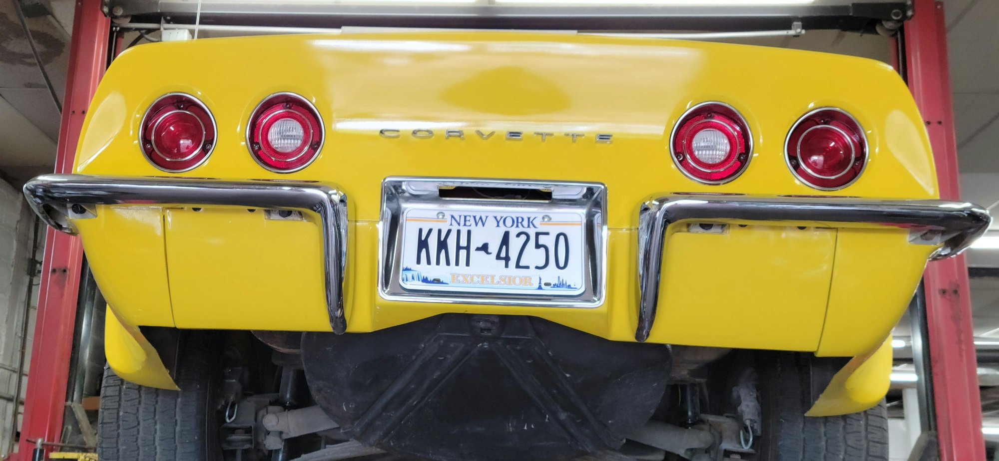

Wrong paint, hood, interior and added on sidepipes? What does the rear valence section look like… glassed in?
I can see someone paying $20k if they really love the paint color but I wouldnt jump over any fences for it.

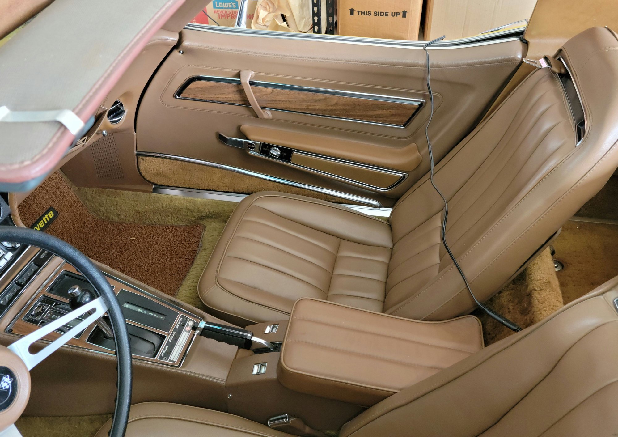

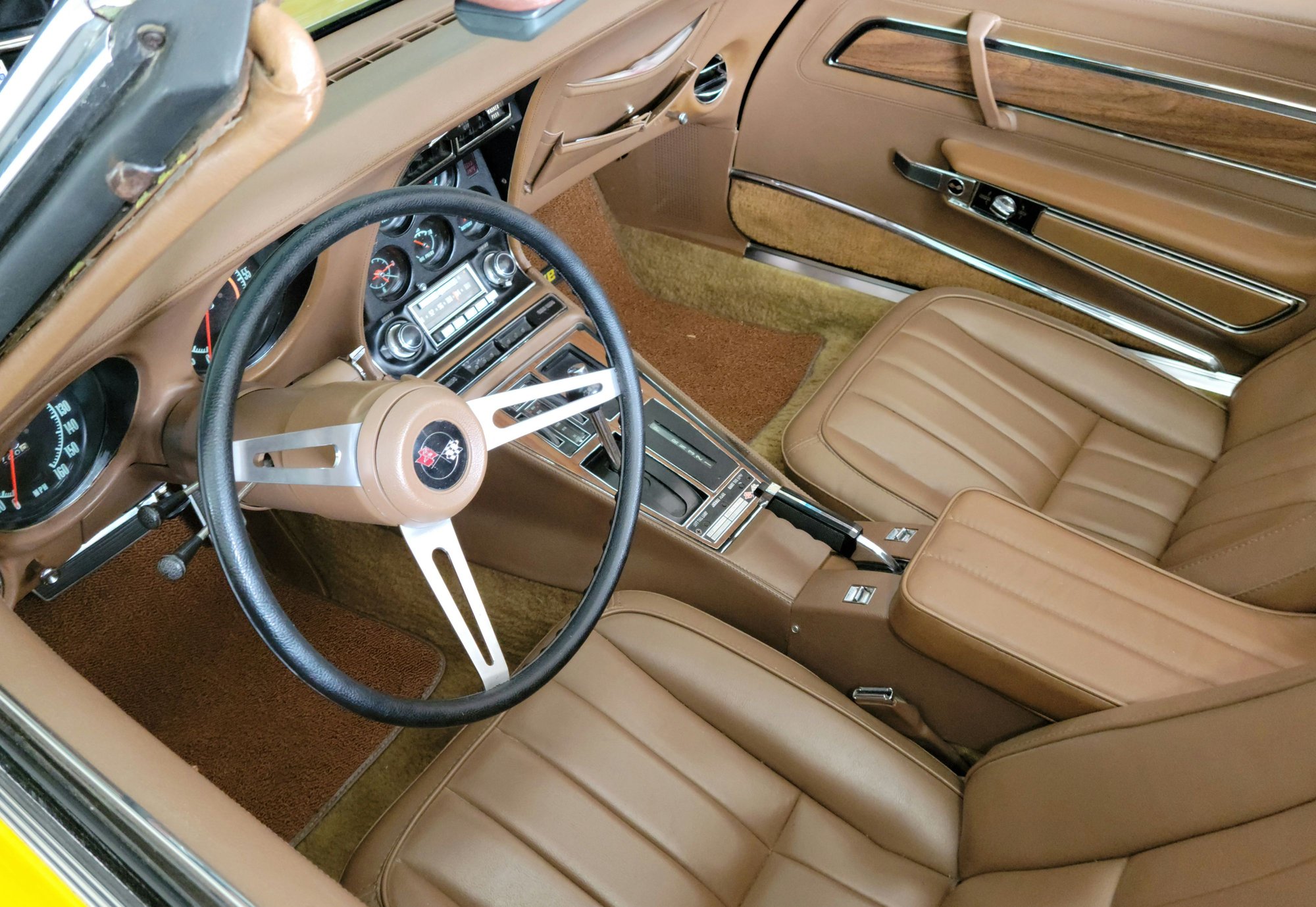

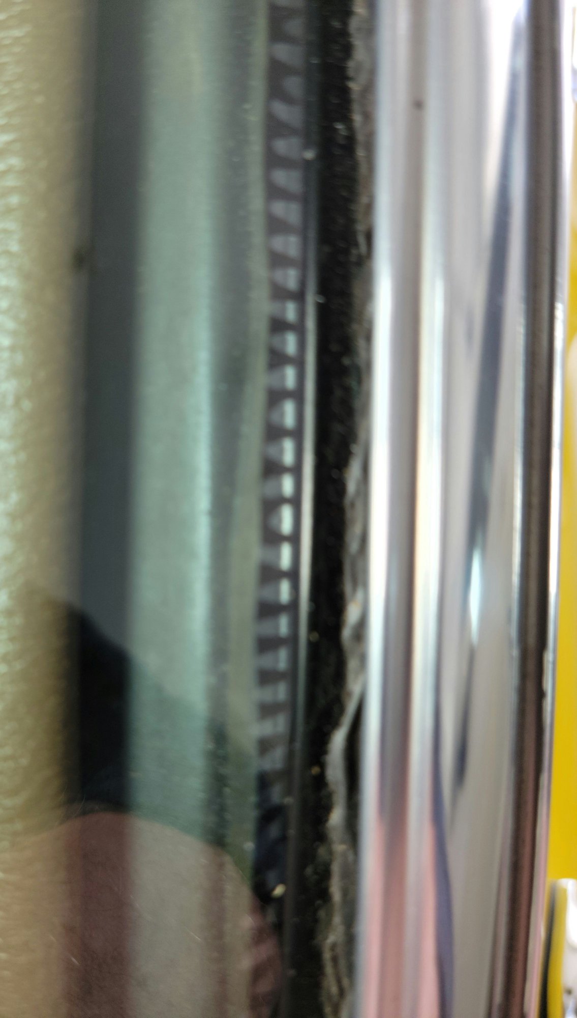

Default More Pics
you were afraid owner is asking too what for this car? it is NOT overpriced. if you don't want it, many on here will happily give him 20k for it. assuming frame and cage are good as stated. interior pics?
Interior pics. Inside door panels look like they need to be replaced.

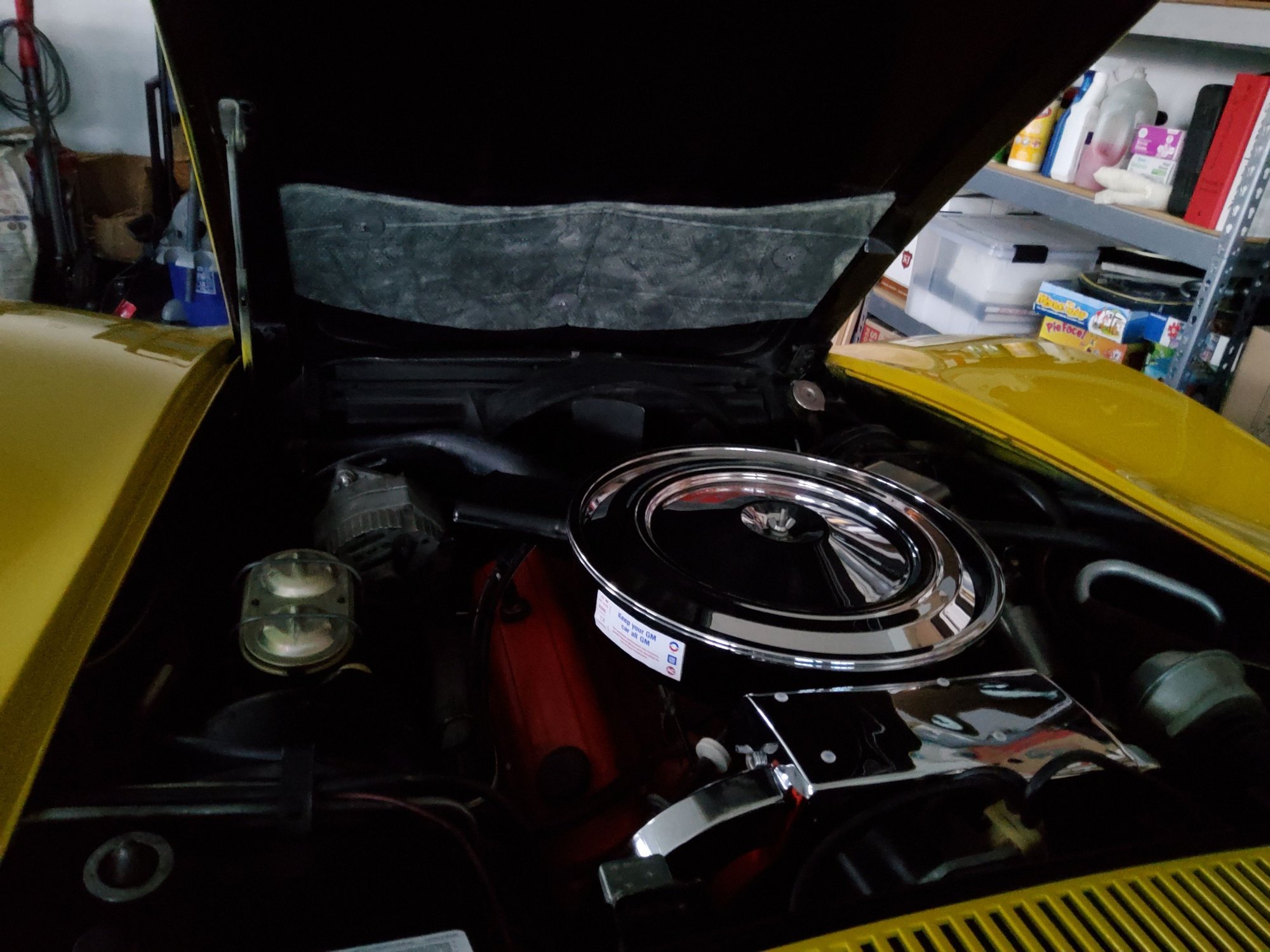

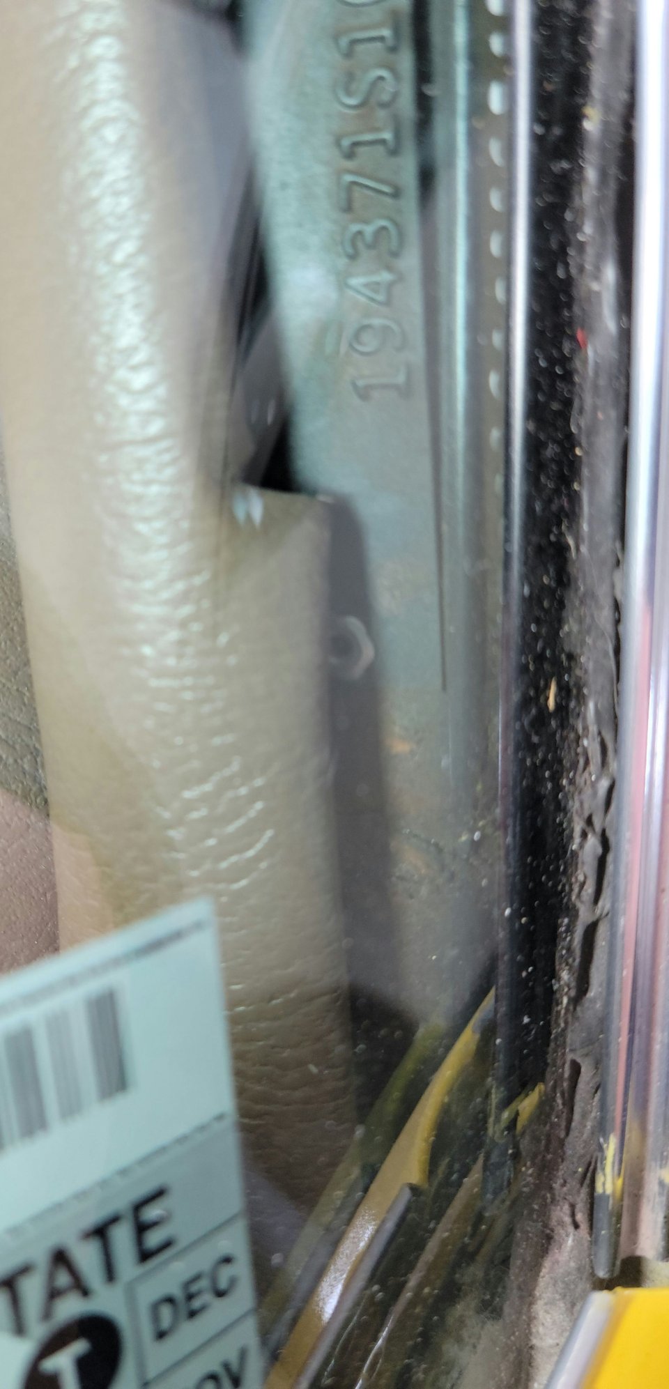

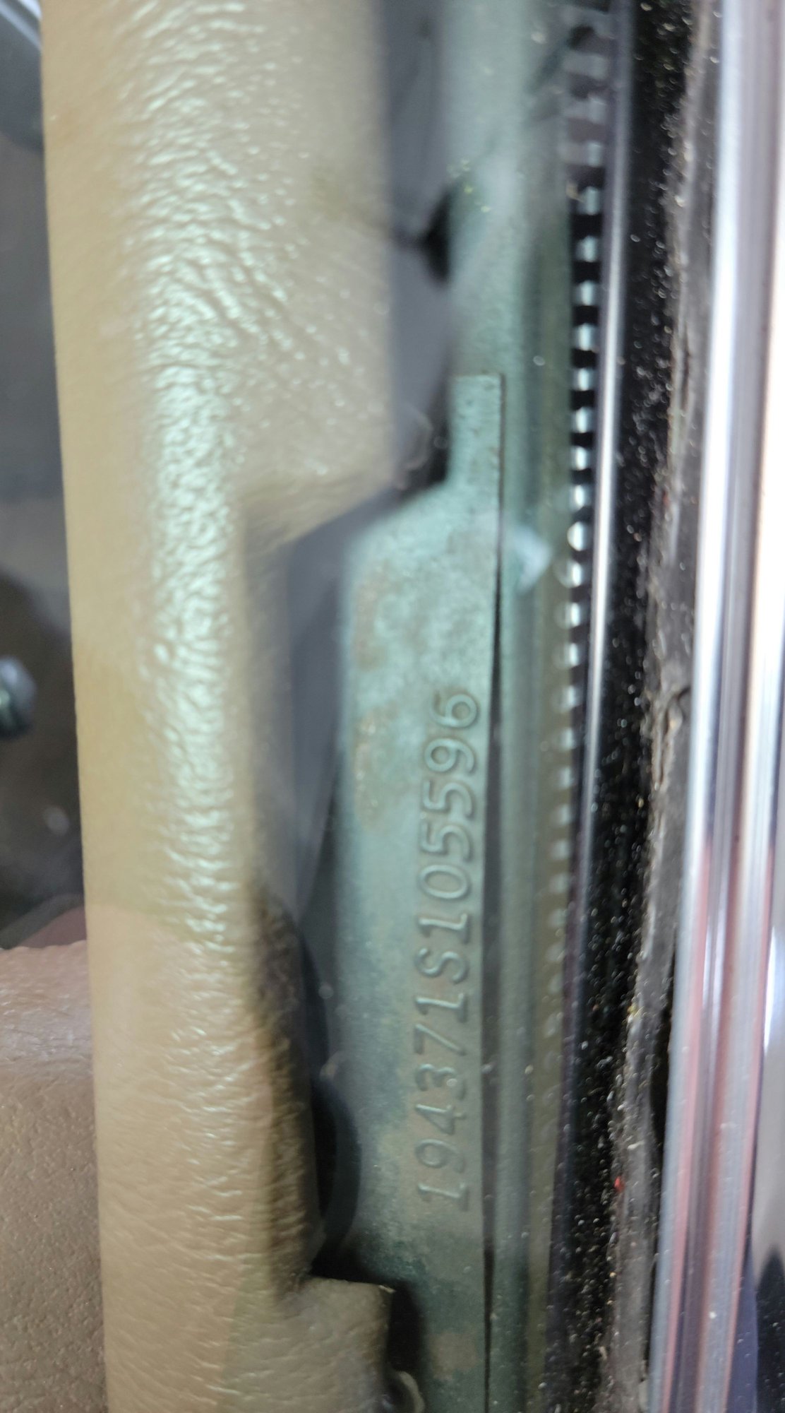

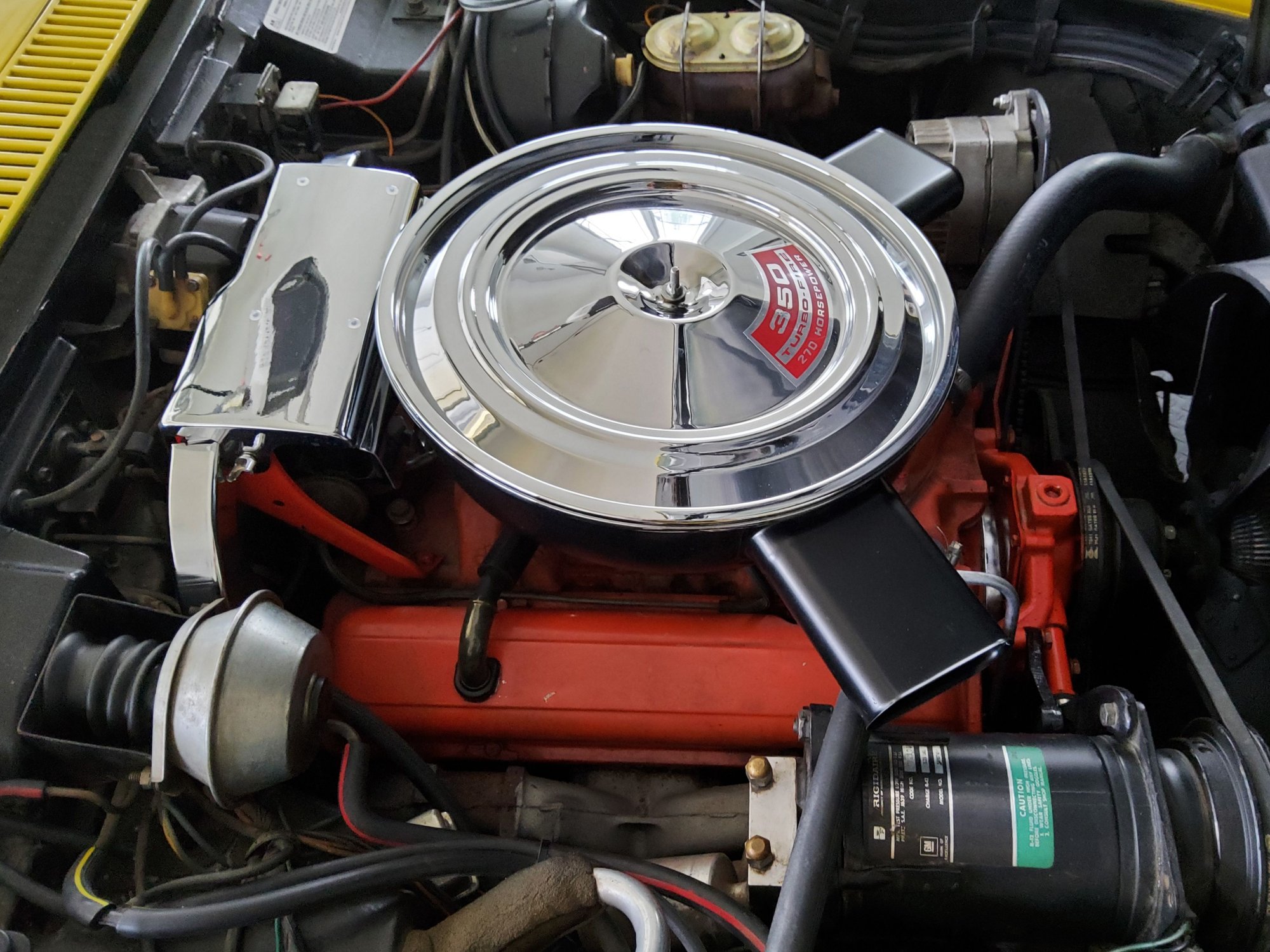

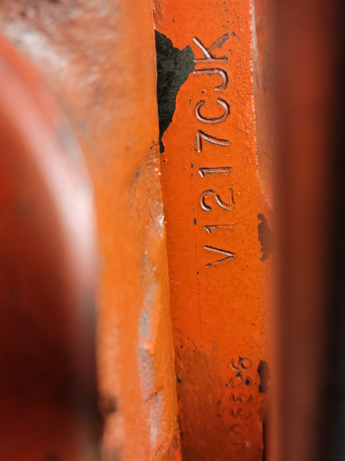

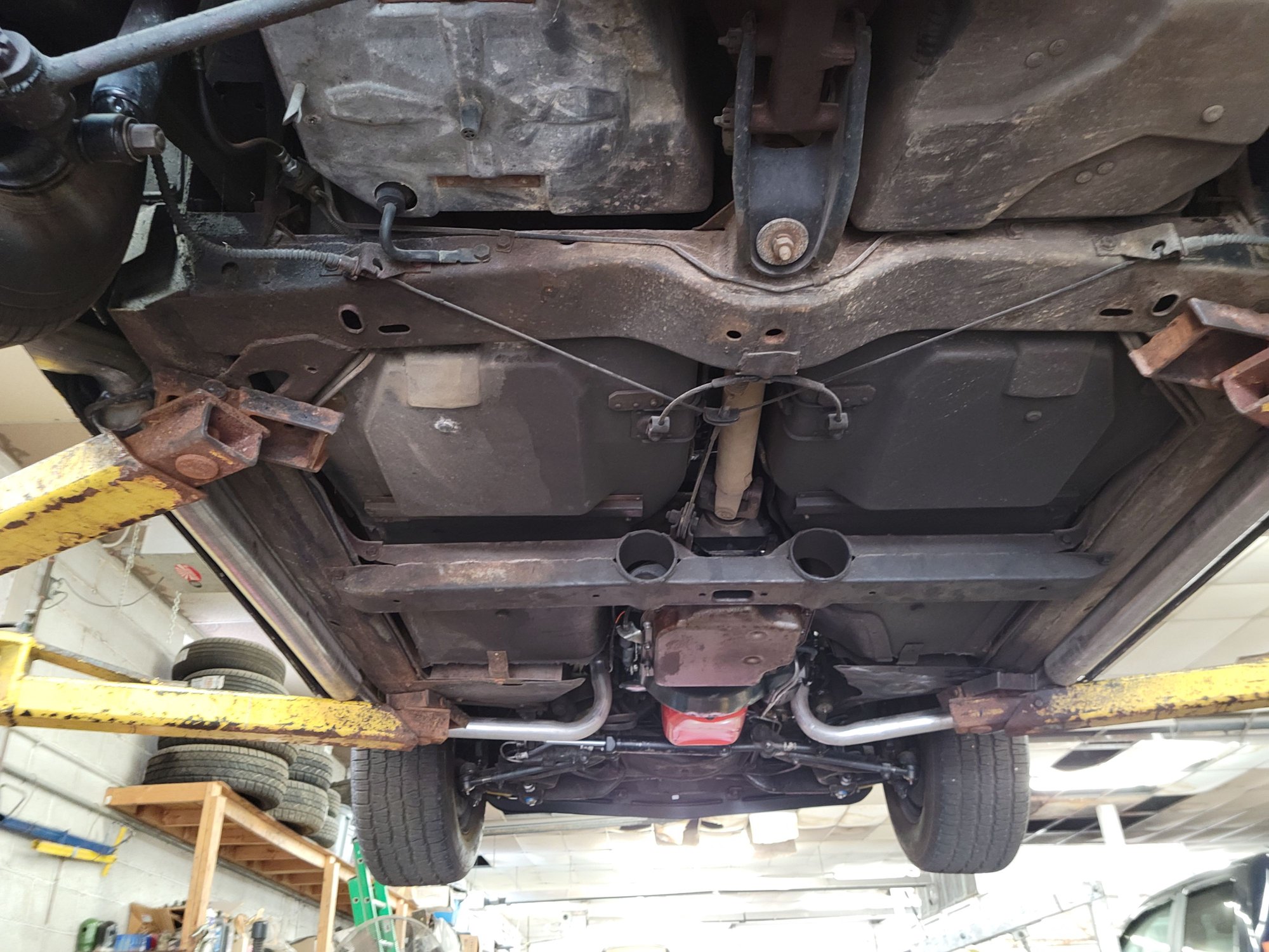

Hi Larry, welcome to the forum!! Lots of knowledgeable, helpful people in here. From the few pics you have here are some thoughts:
  • Engine code checks out for a '71 base 350/270. Looks like the rest of the engine pad matches the VIN, you likely have the born with engine.
  • The few pick from underneath look really good.
  • Lots of options, including A/C
Here are some comments on the items you mentioned:
1. Not original paint - was ontario orange, repainted sunflower yellow. Ontario orange is a great color. But - from the pics - the current paint looks good and I personally like the yellow. There is some over spray I see, but that's fixable.
side pipes (look cool but loud) I don't think side exhaust (N14) was an option in '71, but they're cool and expensive. Not too hard to go back to stock if you wanted (rear valance, etc.). Loud? Ear of the beholder.
2. Owner believes the seats were recovered in vinyl, not leather by a previous owner Meh. And from the interior pics you just loaded, the interior looks very nice. Door panels don't need replacing IMO - window felts are available and it's 50 years old.
3. Owner says the alternator and carb were replaced with Delco and Rochester appropriate ones, whatever that means Wouldn't worry about it. Does it run well? A lot of these items are available if you want/need.
4. Owner believes that the 71 hood was replaced by a previous owner with a 69 hood because of some (3) hood insulation pins Doesn't make sense to me.
5. There is paint chip near the passenger head light about an inch long and frint bumper looks like it pushed in about a quarter inch If no real body damage, easily fixed
Anyway, I'm on the fence thinking the owner is asking too for this car. As others have stated, if the frame/cage check out and it runs decent, this is a good deal. Automatic? generally not as desirable as a stick, but that's up to you - some prefer the auto. You'll need to spend some $ along the way - just the nature of owning a 50 year old car. But a bumper car in good shape for $20k? If you like the car I would write the check. If you don't want it, the owner should list it in the C3 FS section. AND....if you don't like the color (or the auto), take a pass. It will cost $10-15k+ to get it painted. Best, Paul

That's what I was thinking, so much wrong with the car from an originality standpoint. I do have a pic of the rear end. It looks normal to me. I can ask the owner if he knows where the original valance is. I was thinking if I buy it I'd put regular exhaust on it.

Here is the damage I was talking about. I looked underneath and the front looks ok to me but I'd feel better if my buddy checks it out. The car starts up and runs
great, but loud, and handles good.

Here's my cut on all this, the car is worth $20K if it presents itself in person the same way as the pictures indicates. You like $17.5K but don't like $20K, that's a difference of $2,500, I would never walk away from a chrome bumper Vette I wanted if it was the right car for me over $2,500. These cars are getting hard to find and good examples are far and few between.

That's a good looking C3
