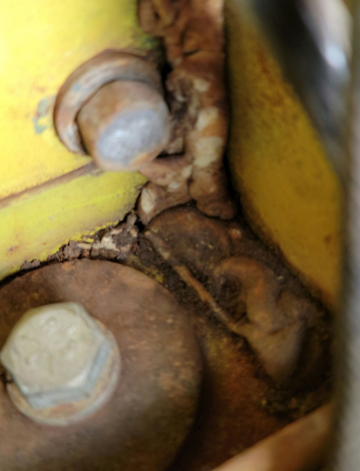

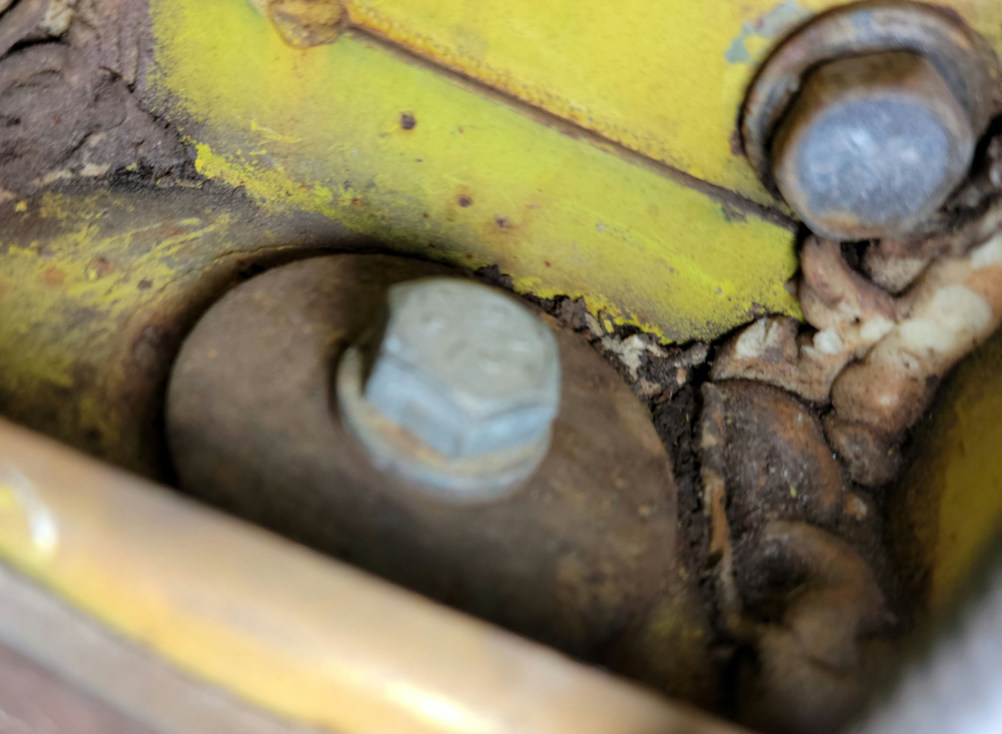

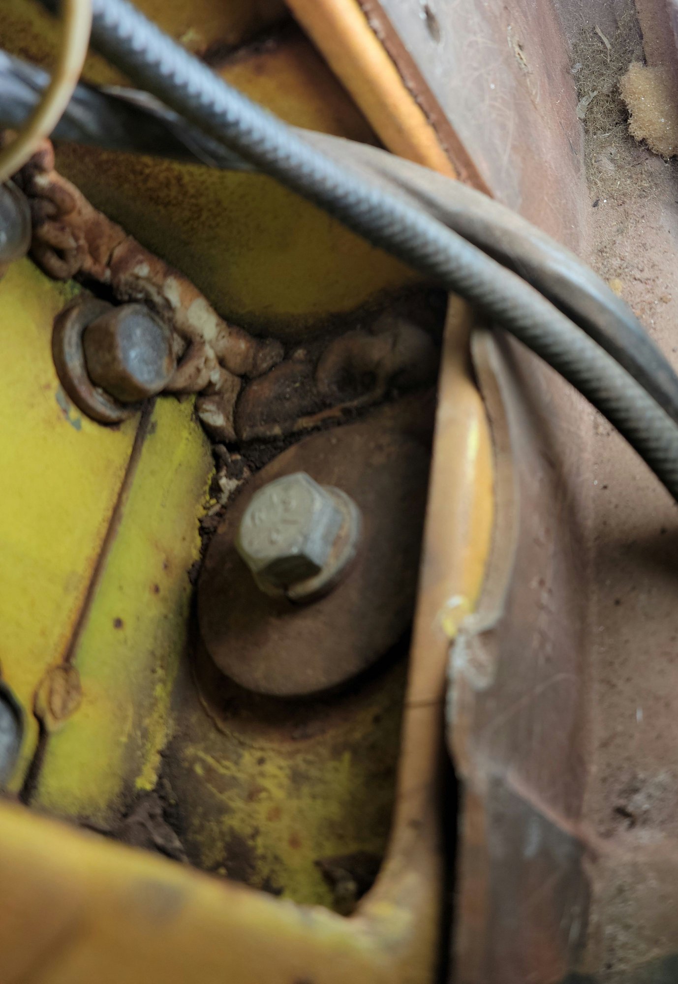

the windshield pics look good. have seller pull the 2 kick panels and chesk the #2 body mounts. i always say it is better to regret the car you passed on 6 months ago than to regret the car you bought 6 months ago. this is the exception to the rule. he did not look up the price-value of this car. he stuck a 20k price tag on it. and that is for his neighbor. also friend? he is doing you a favor. accept the favor. buy it. after posting pics of the body mounts.
Just left my neighbor, I think he is starting to wonder if I'm serious. Anyway, he was a good sport and took off the kicking panels and I took some photos. Good to be off work this week. How do they look? Is there anything to worry about?

2016 C3 of Year Finalist
They should be green primer but they are rust free. That indicates that this car was always garaged and never left out in the rain because the biggest thing Ive ever heard about T tops is that they leak. Now you have to decide if you want a car you can get in and drive for a very good price tat is chrome bumper. Whether you want to wait and see if you can find a car in the color you really desire. Whether you want a convertible or not. If you can live with the color this is a good deal by all accounts. Not all chrome bumpers were straight. Some folks have cut up a nice bumper to make it perfect and have rechromed. To me I think that after the repaint they didnt put it on straight. You may be able to loosen all the attaching brackets and shift it towards the drivers side to fix those gaps. Same with the passenger headllight door and maybe get it touched up.
Looks good to me. Car was repainted yellow. I'd be asking $28k if it was mine. Buy it.
