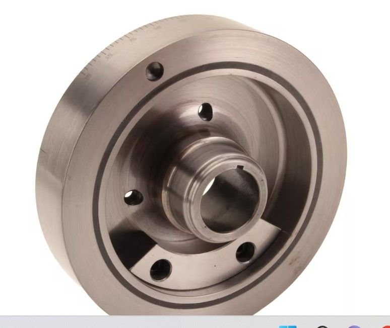

You can feel the extra size of the weight on the inside back of the front balancer with your finger, and you can see the added weight on the flywheel if you pull the inspection cover off and rotate the engine.
Verify both are there.
Most likely is some dummy replaced the clutch/flywheel at some point and used the wrong part. Or the balancer failed and the wrong part got put on.
Now depending on how original you think the car/engine is, or if it is a high performance build, it could also have been subject to an expensive high performance crank balancing job with mallory metal which would mean it is now internally balanced. It's unlikely, but you could see the mallory metal thru a borescope thru the oil pan hole.
Either way, get it wrong, and it will vibrate, and likely fail.
This is not a factory balancer, but it is a clear pic of how much extra metal should be on the backside of the front crank balancer. So you know what to "feel" for.

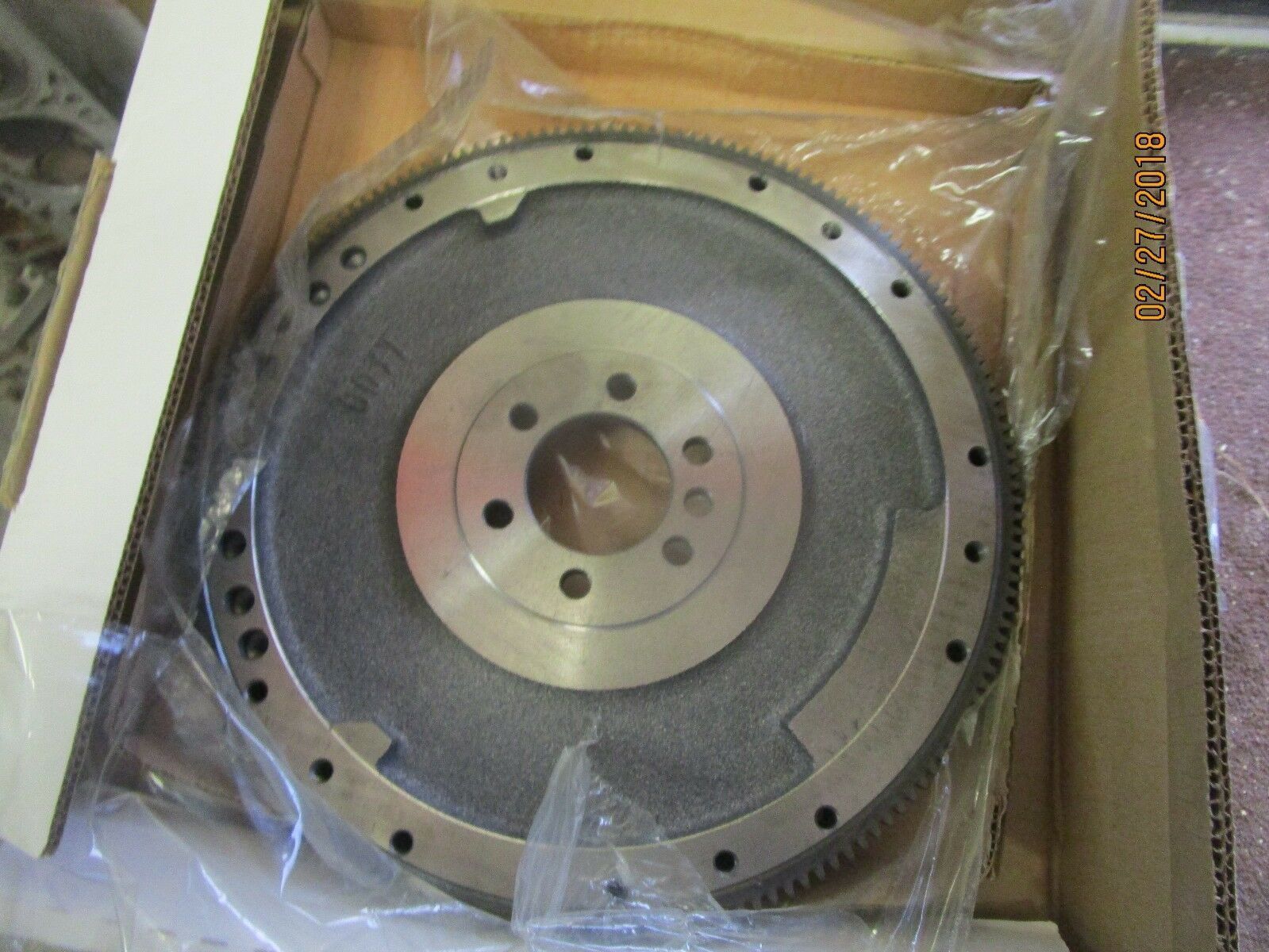

here is back side pic of a 454 flywheel.
now, are you sure it is a 454? has it done this since you got the car? or since you got the car running?

yes, the 454 is externally balanced by a special flywheel and front damper that will not work on other big blocks that are internally balanced, it it get worse as you rev, then you probably have the wrong flywheel or balancer.. or both. see the above pics for what you need.
unless it is not a 454 and is a a 427... a 427 with a 454 balancer or flywheel will cause vibration issues also..
