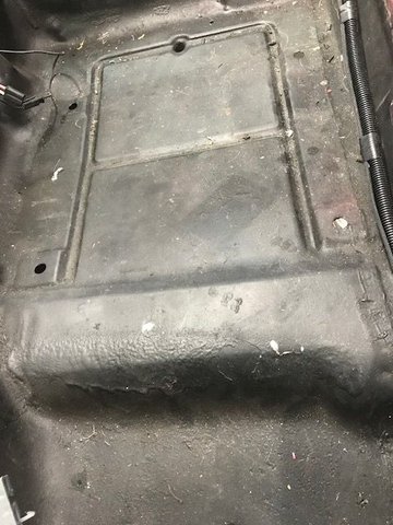

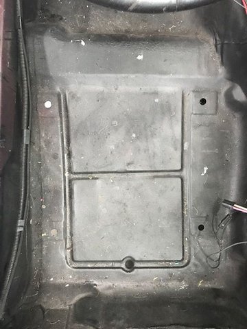

The seat pan for the 81-82 power seat is not remade yet. Here is what the power seat pan looks like in the 81-82 cars. Not the easiest to get a good picture of....LOL
Top view inside car.
Top view from inside car from the front.
Seat pan from under the car.

Mattoonvette, that is the definititive answer, thanks.
Is the passenger side similar?

The passengers side is the same as far as I can remember when compared to other years. There really wasn’t a reason to change it since there was no power seat option introduced for it.
There may be a slight difference in the track mounting bolt holes in the pans.
