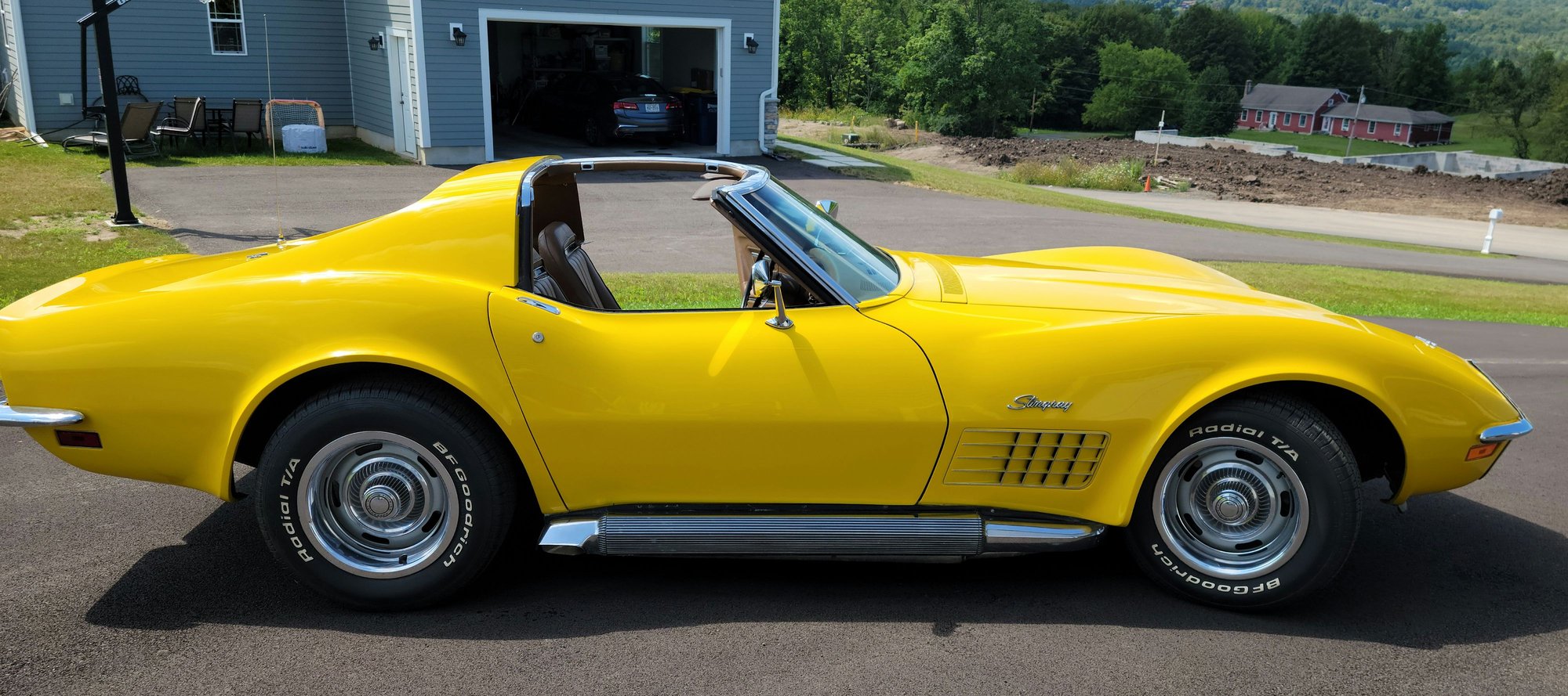

1. Straighten front bumper - see pic

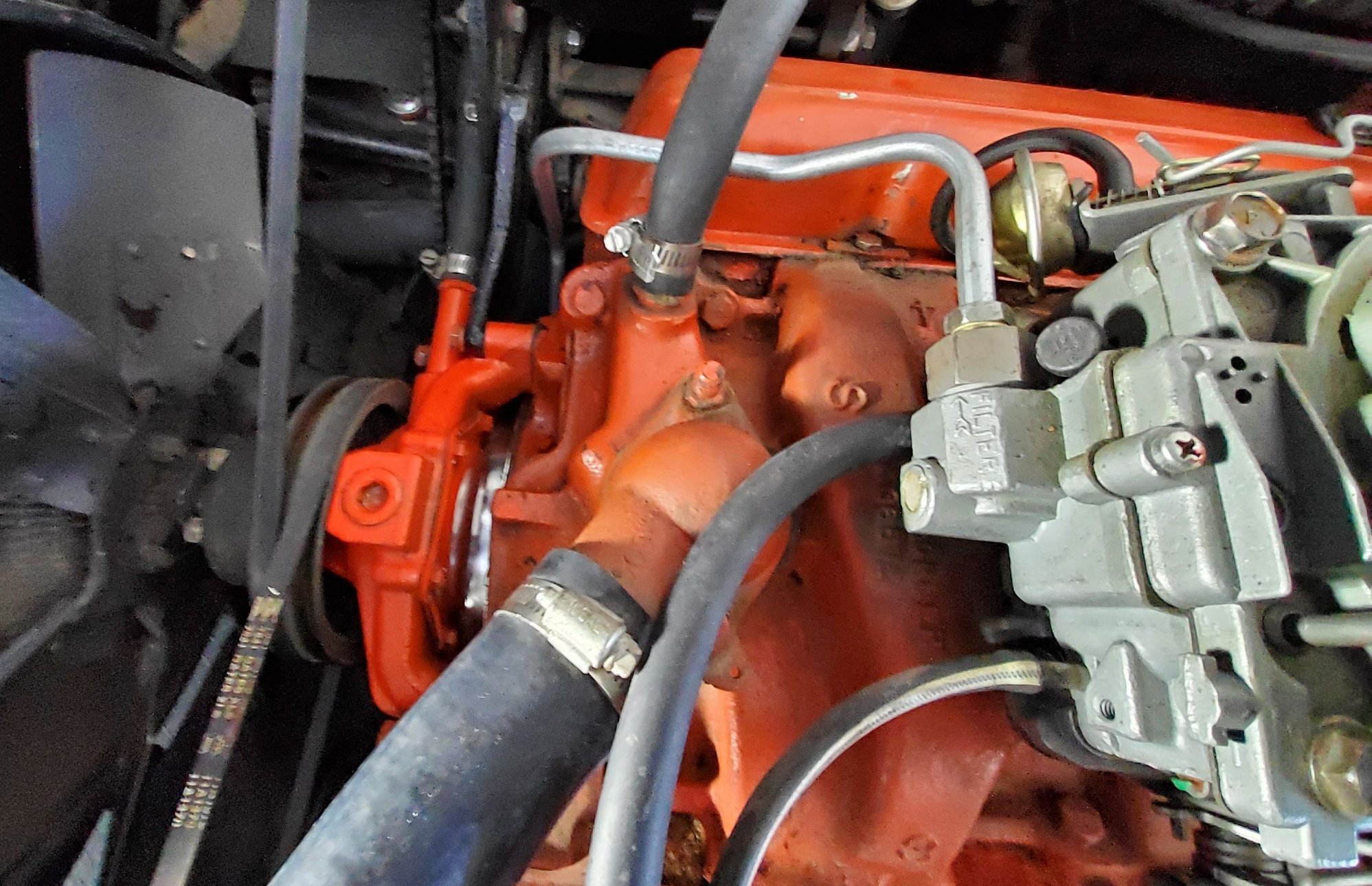

3. Find and repair carb solenoid - see pic of carb

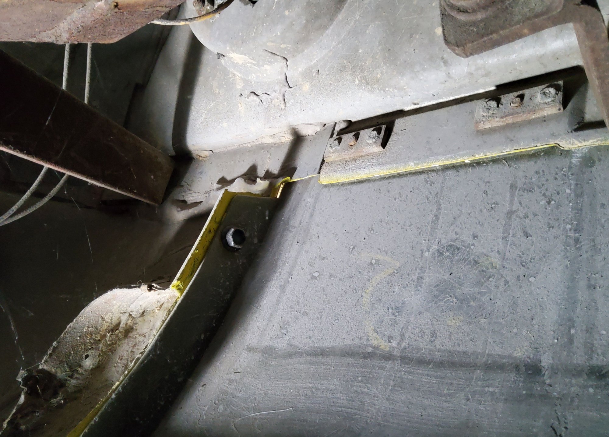

5. Remove side pipes and install stock exhausts - see pic of behind the valances

Bent bumper

Inside rear valances

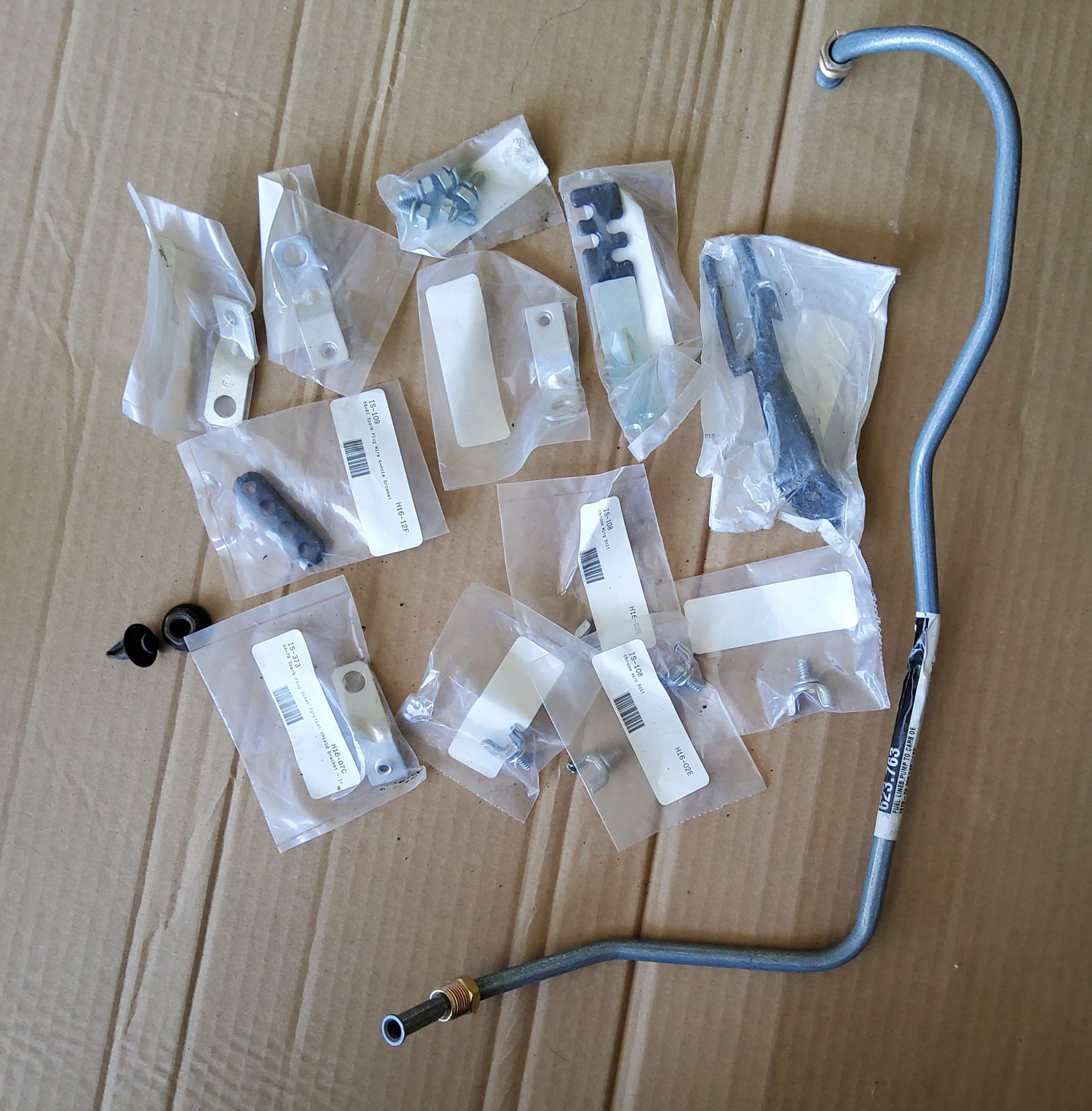

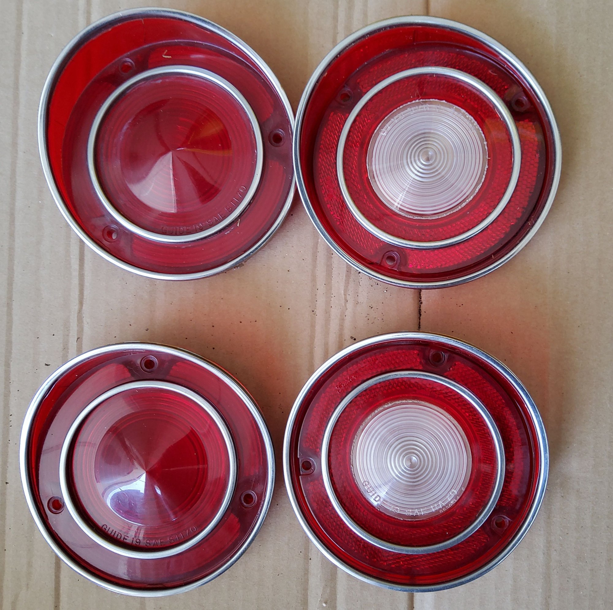

8. Sort through parts that came with the car - see pics. My neighbor said that some of these parts aren't for a 71.

You have a red circle in the picture of the front bumper, at the center point of the bumper. THAT is NOT BENT, and is the way they are made, and they way they are supposed to be.

1971 Idle Stop Solenoid
Go to this link to see pictures of an installed Idle Stop Solenoid
https://www.corvetteforum.com/forums...-solenoid.html
You will need a special screw to mount the Idle Stop Solenoid bracket to the carb, see below link for a picture of that screw.
Corvette OEM 1973 1974 454 4 speed carburetor Idle Solenoid Switch bracket and | eBay
The solenoid is GM 1114444, couple links to that chunk of gold.
https://shop.docrebuild.com/1971Corv...114444NOS.aspx
https://www.corvettecentral.com/c3-6...olenoid-353012
Best approach here is to dumpster dive the internet and look for a good used original "WORKING" solenoid, bracket and screw.

Thank you, that is good to know. It just looked funny to me. So, all I needd to do it push the driver's side in a bit to make it look normal?

Thank you. This looks doable for my skill level.

You should be able to move the F bumper over. Looks like it needs to be slid over about 1/2" - 5/8". That's quite a bit.
I guess before you start, just make sure the front mounts to the body are where they should be and you don't see any evidence of a bent frame (in the front). I mean if the frame is bent a little from a front end whack that's going to make it a little trickier. Then look at the bumper bracket bolts and if they look ok, loosen the nuts and start with the adjustment/shimming process. W/o looking at things it's going to be difficult to guide you through what needs to be done. Could be it's an aftermarket bumper where the holes were punched wrong. Or could be something else more sinister hiding back there. Which might also be why the headlight doesn't line up right. but you should be able to adjust that out a little.
Worst case scenario either: try another bumper, straighten the front frame horns (if bent), replace/bend/straighten bumper brackets (if needed) ...or take it to a bodyshop (or do yourself) and have them cut the brackets and re-weld as needed to make the bumper fit 'centered'. The last option is probably the cheapest if there isn't enough adjustment in the bolts. It's not really the 'right' way to do it, ...it's like trying to make the leaning tower of Pisa look straight by building a top section to 'look' straight ..even though the rest is bent, but it would achieve your goal probably the fastest and cheapest. If someone did a good job cutting/welding/grinding the brackets and did a good job, they could make it nearly seamless.
But somewhere behind that bumper is a root-issue story why it's not lining up. No big deal, even if things are twisted up a little under there.
Thank you for the detailed explanation. I can inspect the front end more carefully. Unfortunately, the actual bumper repair looks like it is beyond my skill level. I may have to take it to a body shop although I'm nervous about doing that.

Like I said loosen the bumper brackets and slide it over, it will look better. For everything else make a plan and do it next winter, Drive the car and enjoy it. THe feeling and joy you will gain will keep you motivated to finish any work you do during the winter...provided you have a warm garage to work in. You should ask your neighbor why he removed that idle solenoid.....I personally would not put it back on if you can tune the carb not to need it. Post some pics of you out enjoying it
I'll give that a try. So I'll loosen the bolts that support the blade part if the bumper (not the vertical bumperettes) then slide it toward the passenger side. I think I can do that. I bought an impact wrench that should make it easier.
The car runs and idles fine so I'll take your advice and not worry about replacing it. There isn't a bracket there either.
Thank you, I appreciate your help.
Edit: fix spelling

Hope this helps you to locate the proper bolts to loosen. 3-9-13 are the main ones. You can also see shims that can be added or removed at the outer corners #15.

grab the left side of the bumper and twist it upwards. see if it bows the center a bit farther away from the body. and carb. get the numbers off the left side of the carb and see if it is the correct orig carb.
