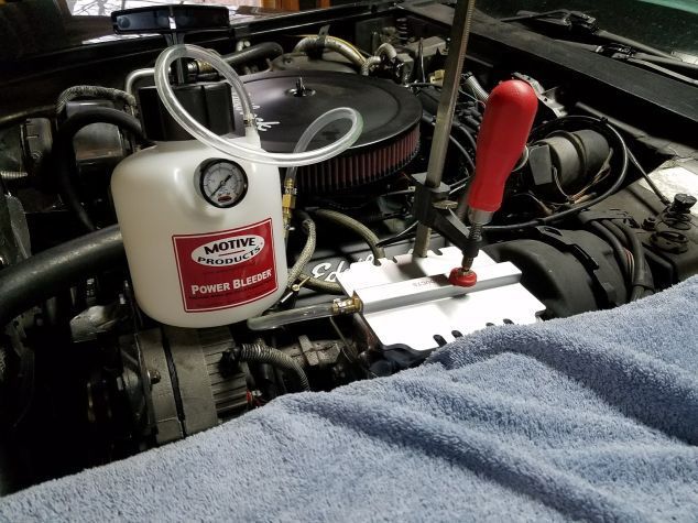

here you go..here are multiple ideas. If you have a piece of steel or aluminum lying about you can make one today since those garden sprayers are quite common at the local hardware stores:
https://www.corvetteforum.com/forums...y-version.html.
It works so well that I just use it whenever I do brakes on any of my other cars too.

I don't know how cheap you want to be. The full kit is $80- (dunno how much shipping will be), and the Motive GM MC attachment is $40-.
You can certainly fab your own pressure tank, but the cap is pretty nice. Throw the chains away, and use a clamp, like this. If you have a thick piece of Lexan, you can make your own, and, with a creatively cut gasket, see what's going on inside the MC.

The pressure pump is probably the most economical and quickest solution.
I have an electric pressure/vacuum bleeding machine. It's pressure/fill at the m/c cap and and simultaneous vacuum at the bleeder (the old fluid goes back to a catch container). Personally, I prefer skipping the pressure portion and just use the vacuum motor (pump) for drawing old brake fluid out. It's not under a lot of vacuum, it's slightly slower but more controlled. I think I tested it and it was like 12" or maybe 10" mercury vacuum. It works great that way. I've been using it that way for years. Then you don't have to screw with the pressure cap. A guy could make such a system really easy with a 12 ebay self-priming vacuum pump that can handle fluids. The one little tip is, put a drop of gear lube on the caliper bleeder screw threads. The vacuum will draw the lube in and create a seal (won't suck air) and it goes faster. If you have an A/C vacuum pump you could do the same thing ...except put a catch-can before the pump. Only issue with an AC pump is they produce too much vacuum. but I know guys who've done it. You get a lot of fluid fast ..lol.
Something along the lines of this:
