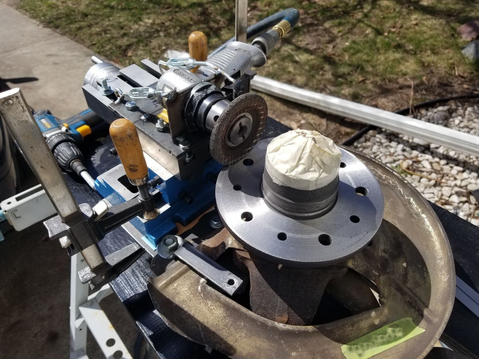

The reason I say, "Check the run-out on that rotor" is bc too much run-out on C3 rotors causes the pistons to vasillate in/out as you drive down the road. This is a phenomena of C2/C3 disc brakes that doesn't occur on other vehicle's brakes bc GM used Lip seals on C2.C3's (it was GM's first time at bat on disc brakes, and lip seals were kind of a foul ball of an attempt). As the pistons go in/out rapidly due to a slightly warped rotor, due to being 'lip' they tend to 'pump' air into the calipers. Eventually (or sometimes within a test drive), it results in spongy pedal or even a near total loss of brakes. The Rotors really need to be as close to .000" as possible, although .002" would be as far as most would recommend as the limit. No surprise the caliper on that rotor felt 'funny' ..could be because the rotor is 'out of spec' sucked in a lot of air (in that caliper) making it 'seem' like it's not braking well, or pulling. When the real culprit might be the rotor (check it).
Now ...the question you ask is ...why would the rotors be warped? Ahhh good question. History lesson: Because GM did a real quick machining on the front hubs, riveted the rotors onto the hubs, then turned (resurfaced) the rotors while ON THE HUB. That was great on the factory expensive equipment bc they could achieve a run-out of near-zero doing it that way. And the lip seals wouldn't be an issue. BUT ...but ... lol. several years down the road joe blow takes it to get new brakes and the shop says 'you gotta replace your rotors' or he does the brakes himself and slaps on new rotors out of the box onto a hub that was never machined 'true'. Therefore the rotors will never be true unless they are machined to by rotating the hub (which few shops have the equipment to do). I see one of your rotors has been replaced. I would definitely check that rotor. Just to give you an example, both hubs on my 81 measured .006" and .008" run-out at the HUB FACE! With a rotor installed, it would be amplifiied to .013" out of 'true'. I bought a couple used original hubs off ebay and they measured .005 & .006 as well. I finally made a jig to resurface them absolutely 'true'. I wasn't in a hurry, but if I was counting my time, I would have been better off buying brand new properly machined hubs.
GM quickly saw the error of their ways and went to a square-cut o-ring inside a machined groove (inside the bore) with a stainless or chrome-plated (or phenolic) piston ...which essentially is how they have been ever since. But going to o-rings on movable pistons in a C3 isn't a perfect solution either. That's another debate. Lip seals are fine and work great ..the real solution is to make sure your rotors are as close to .000 as possible and periodically during periods of non-use, go out and press the brakes a couple times to exercise the lip seals. Or buy aftermarket (re-designed) calipers which DO have an o-ring in the bore (and non corrosive piston), essentially a modern designed caliper. But either way, you need to have 'true' rotors. If you don't have an inexpensive dial indicator and magnetic base, it would be a good thing to get/borrow and check your car's rotors. Bc even if you DO get your calipers good again, 'true' rotors are a must.
https://www.ebay.com/itm/383477161951
