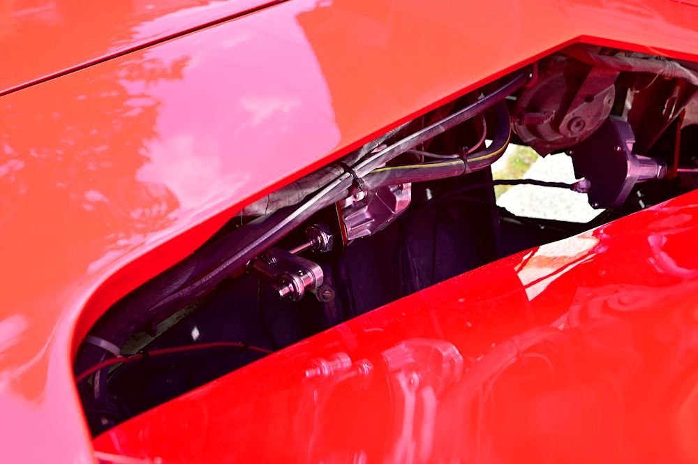

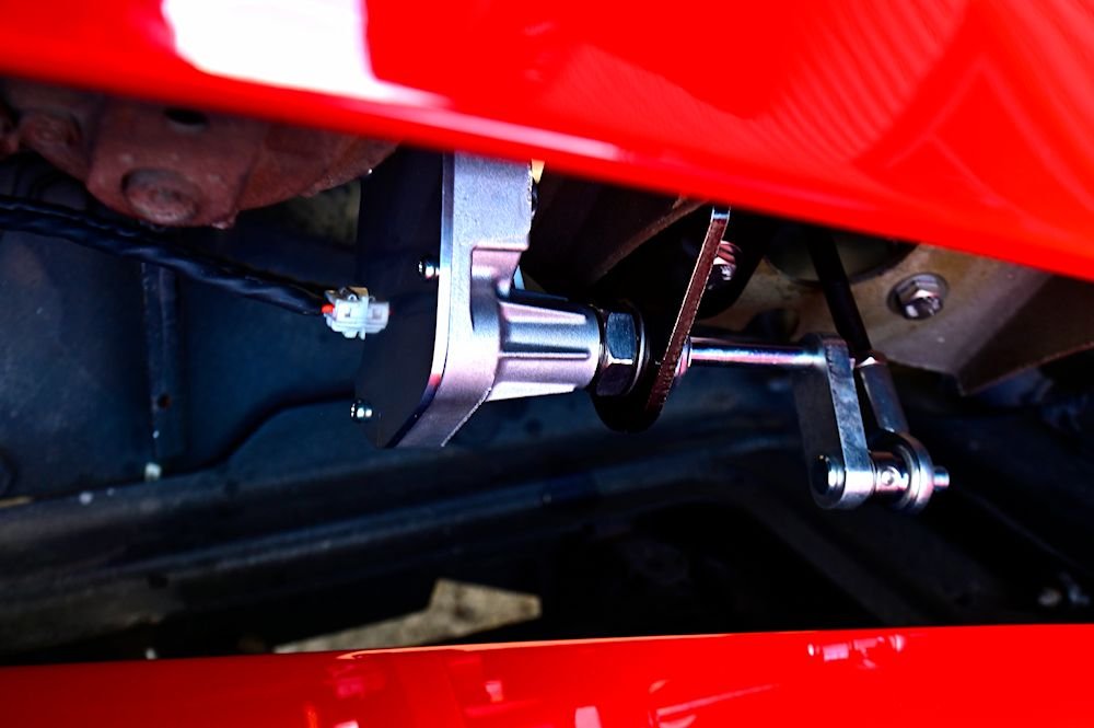

Well, the conversion kit is in and working like a charm. No, I did not do it myself (wimped out), but employed the local professionals in town at Sampson Performance. They do all performance work and specialize in modifications especially Corvettes. They had the installation done in no time (2½ hours, no hood removal needed), and I was back on the road. Purists may cry, but I think it's one of the best upgrades for a C3 Corvette. Hard to reach my camera close for good pics, but here's a couple (headlights closed).......
