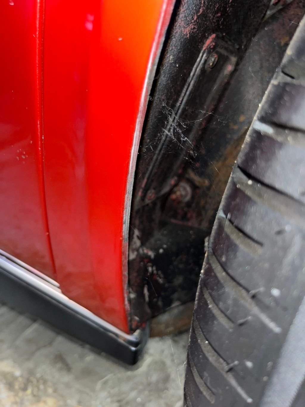

As said above rust is your worst nightmare. If the frame is rotted its gets very expensive very fast to repair. If you are not aware of where the rust could be take someone or find someone who is and have them look at it.

Also learn where the crucial rust areas are and look in them. (Ask the owner to remove the driver and passenger side kick panels, or take it to a corvette shop for an inspection

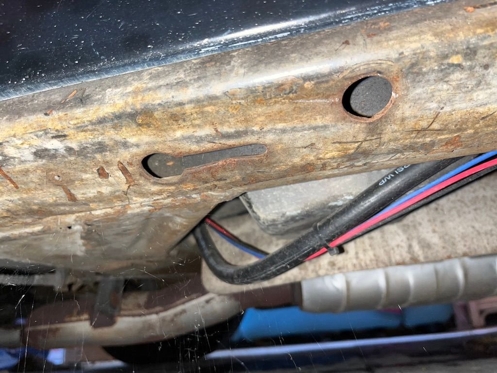

Surface rust on parts under the hood and on the talipipes means it needs a solid inspection for rust underneath. And no pictures of underneath is suspicious.

Stock suspension with 235/60/15 tires on my ‘78 had the front fender edge at 28 3/4”. Removing a kick panel to look at the area around the body mount will tell you immediately whether to spend any more time evaluating this car. If it looks good there check the rear body mount area via the access opening in the rear wheel well. If both of those areas look good take it to a mechanic for a used car check. Be ready for a major backlog on basic maintainance. One of my 78’s had 17,000 original miles, zero rust and everything except the clock worked; still took $6,000 in parts alone to get shipshape. Plenty of great C3 Vettes in SoCal to pick from and plenty that have always been kept in a garage as someone’s secondary ‘fun’ car. The sweet spot on previous owners; they’ve been driving and fixing it for ten years. 75 and older cars don’t are exempt from emission testing in California; you can still get up to about 400hp and still pass the test on newer ones.

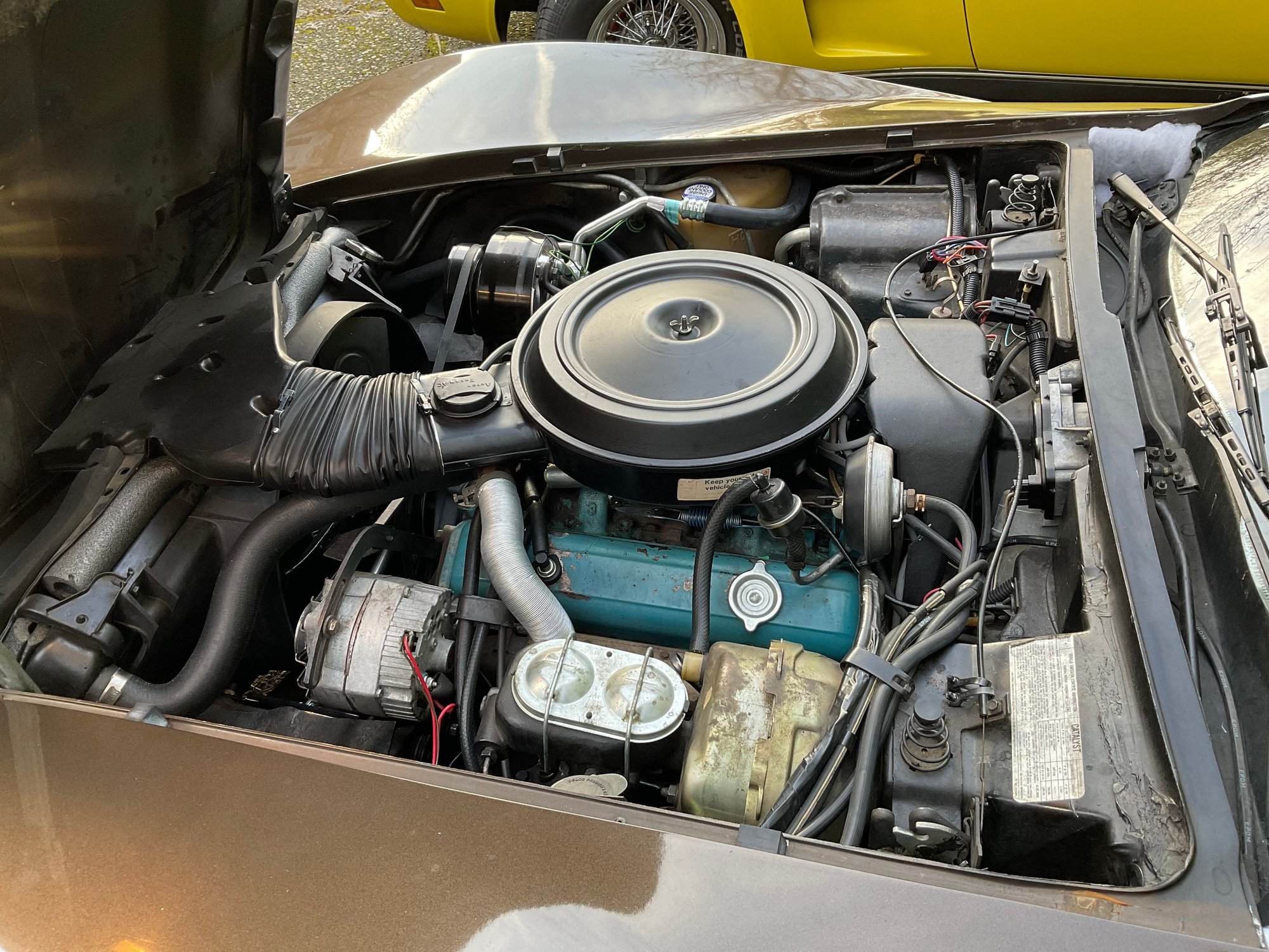

It may be the angle of the under hood shots but I don't see the AC compressor. Is it there?

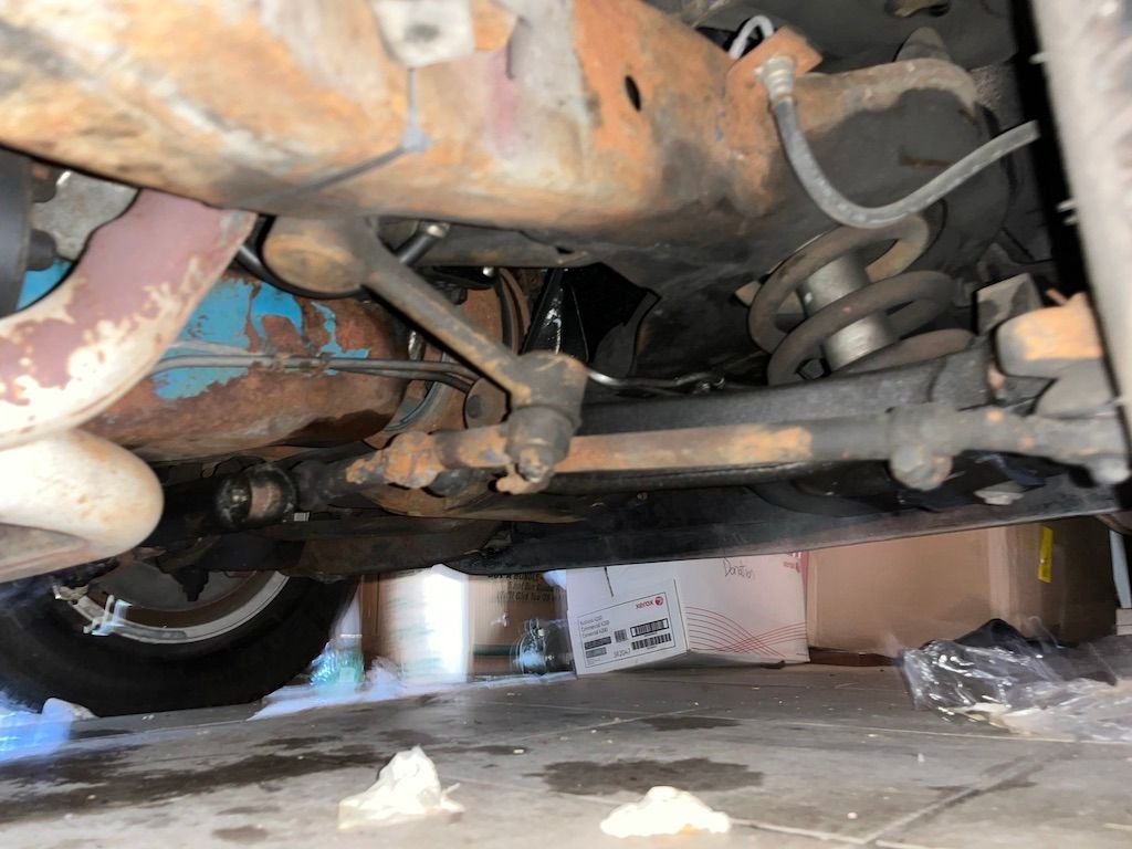

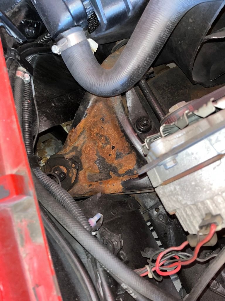

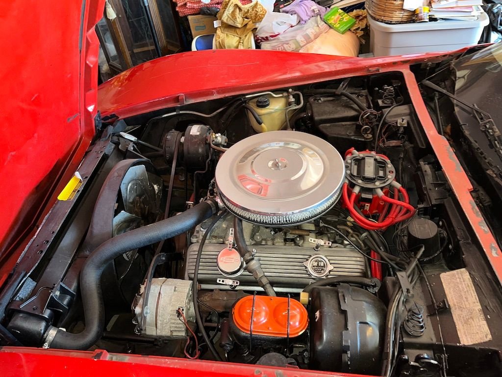

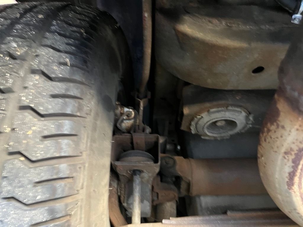

so I gave up on this, I went to take a look and it is not in good conditions.
However I went to see another one from 1978 25th anniversary. It was repainted 15 years ago. Interior is immaculate. Paint could use some TLC,
it has scratches not a show car but not even bad. It has some rust seems like surface rust and not deep. Motor is original 77000 with EFI ignition system.
I took some pictures of the underneath and engine bay.
I think for $9k it would be a good car to bring home. There is some leaking spot on the ground but these cars are old difficult to find one with no leaks at all.

Looks like it originally came with the L82 engine, FE7 Gymkhana sport suspension, tilt wheel, and D35 sport mirrors. What you show of the frame looks nice, thick, and clean. Did you check the rear frame corners where it kicks up to the trailing arm area? That's the area to be careful about and of course the bird cage. Bubba has been messing up things under the hood but what can be seen isn't expensive or hard to correct. Those soft lines on the A/C with hose clamps on the fittings should be changed to correct lines with fittings. The new rubber fuel line running front to back should be a hard line. They probably did that as a quick fix to run the EFI with an electric fuel pump. When they removed the original air cleaner and ducting they didn't re-seal the top of the radiator so it will struggle to keep the engine cool.
thanks for your comments. You mean the engine will run hot or overheat ?
The fix is to seal the top of the radiator ? is it a complicated thing to do ? the radiator seems new and be replaced. Master cylinder is new too. One of the side (passanger) of the hood does not hook. So that will have to be addressed.
Overall I think 9k can be a good deal and my daily driver to work 2 miles everyday.
Here more pictures.

Pipe insulation stuffed around radiator
Your car originally had a dual snorkel air cleaner
