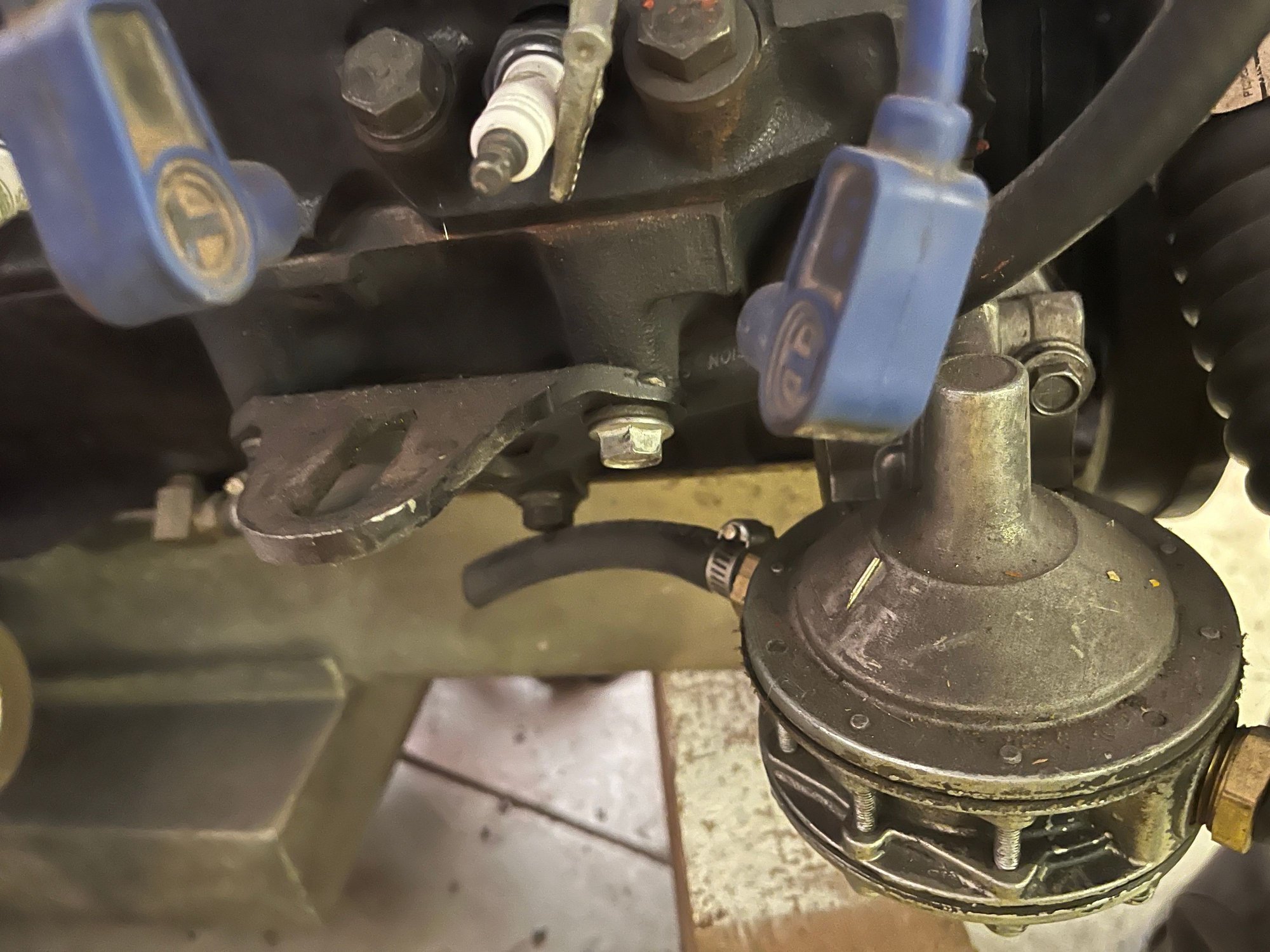

After months of weighing options & waiting for good weather, yesterday was the first day back in the saddle on this project. Out with the old (cracked block)… Father’s Day sale at Harbor Freight yielded an engine stand for a hundred clams. The first time I’ve separated a transmission separated from a block, it went nicely, thanks to the guys at The Sundae Drive on YouTube!👉🏽
Today I’ll be tearing down into little bitty pieces…
Decided against the 383 Stroker, for several reasons. Too much money for too much uncertainty. And too much engine for most people. Since I’m planning on selling the car, I didn’t want it to be too far from stock. Will secure a used block at the auto wreckers & take it to the local machine shop to be cleaned up, honed & surfaced. Thinking about powder coating the block rather than painting it silver & clear coating. Thoughts, insights & experience regarding that would be much appreciated!
This was how I left it last night. Looking forward to disassembly & labeling on a gorgeous quiet Sunday morning in Oregon, after coffee, contemplation & anticipation.
