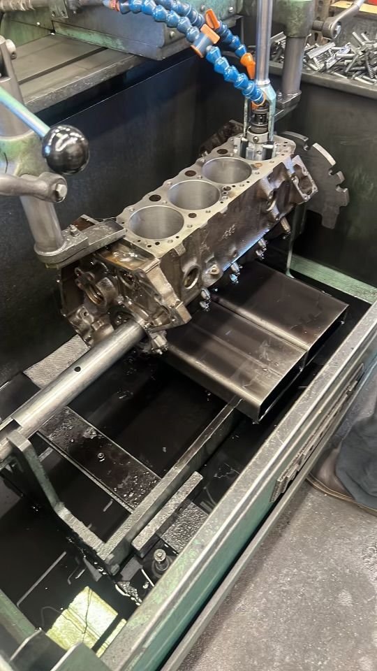

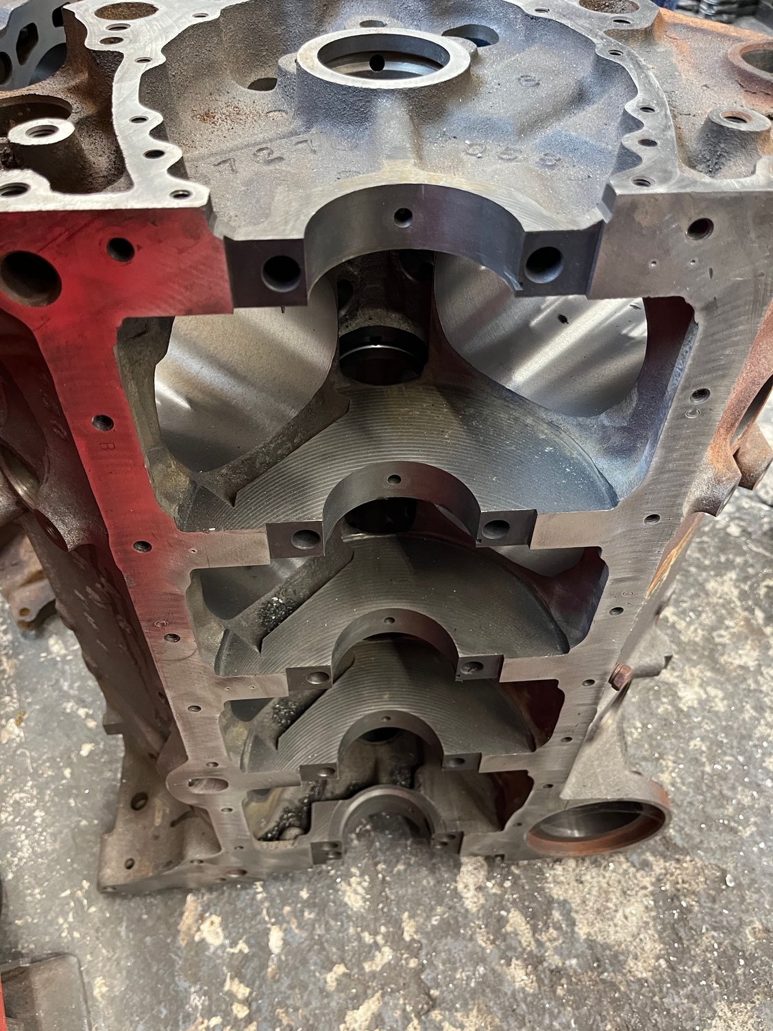

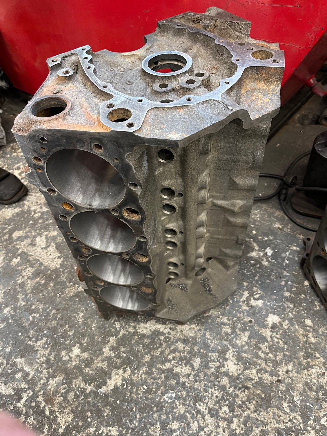

I met my new short block at the machine shop yesterday. Cleaned & ready for surfacing.
Since I’m not going to be racing, or hot-rodding, I’ve been advised that the two hole block will be okay.
Trading out the cracked four-hole for a two-hole; Switching to flat-top pistons & a different cam & crank to boost hp.

A 4-bolt block was found & has been surfaced & prepped for assembly, perhaps by the end of this week.
Though I would have been ok with the other, 2-hole block I’m glad it worked out to replace the old four-holer with one that’s similar.
As squeaky clean a ’vette block as it will evermore be.

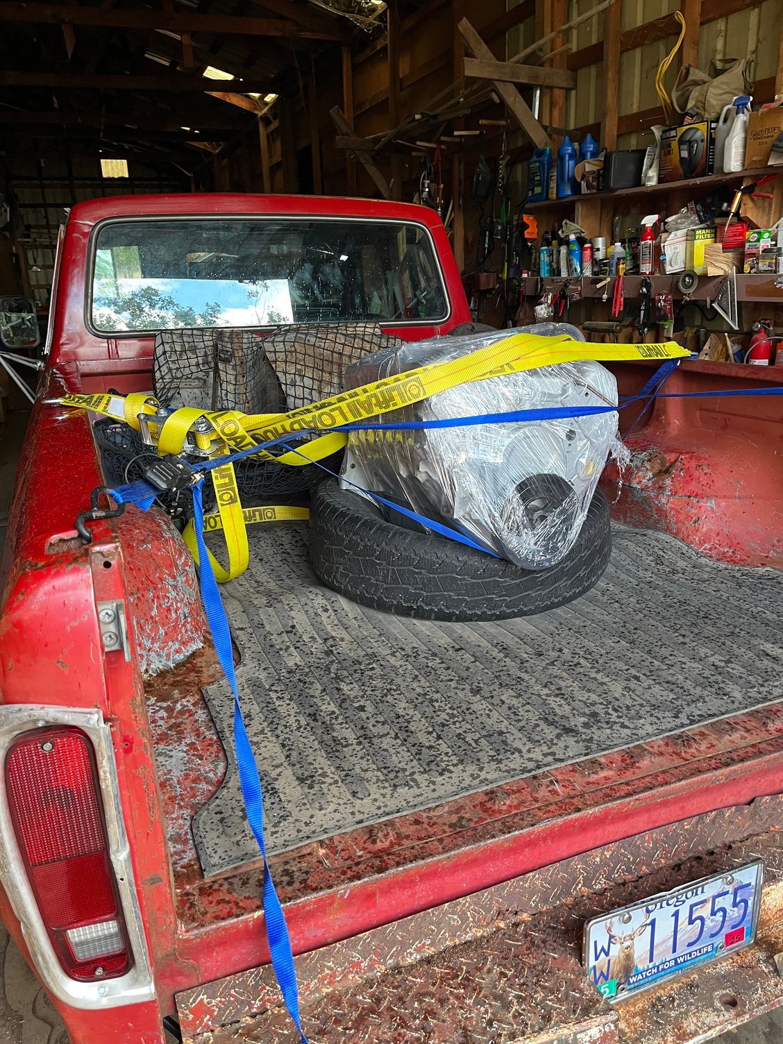

Thanks to Sauer’s Machine in Medford, Oregon for the beefy new (to me) refurbished 4-bolt block, honed & surfaced…
…washed & painted…
…assembled long block, using flat-top pistons, cleaned & polished crank & cam, new lifters, valve job, installed refurbished heads…
…wrapped, loaded, & ready to go…
…Hillbilly Garage style.

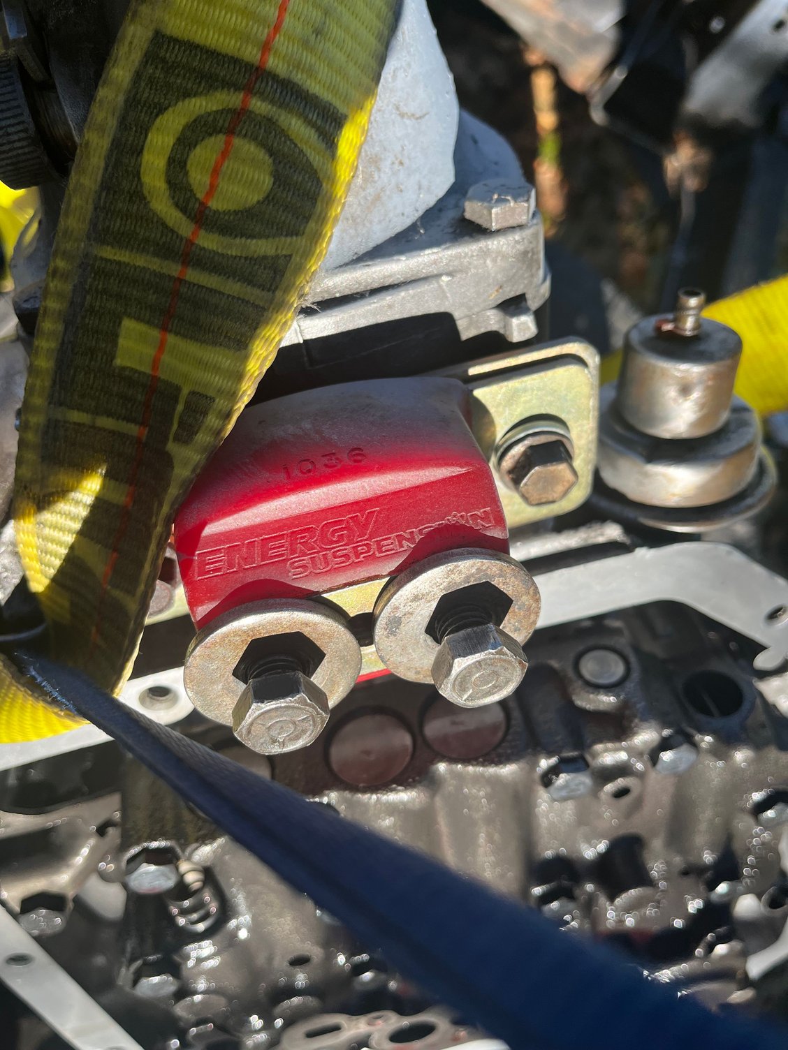

Lowering the new engine into place…
…onto new Energy Suspension motor mounts front & rear…

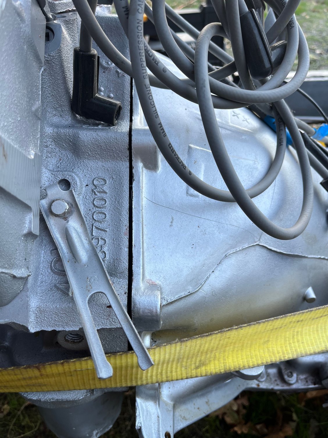

…in place, unwrapped…uh oh…
…close, but not snugging up. No Büéñô.
I’m going to remove the transmission & replace the seal. I should have done this before. 🙈 Good thing I’m not in a hurry.

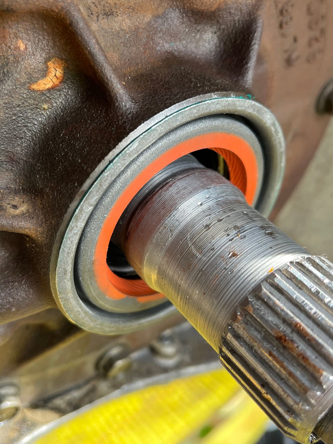

Old seal looking old.

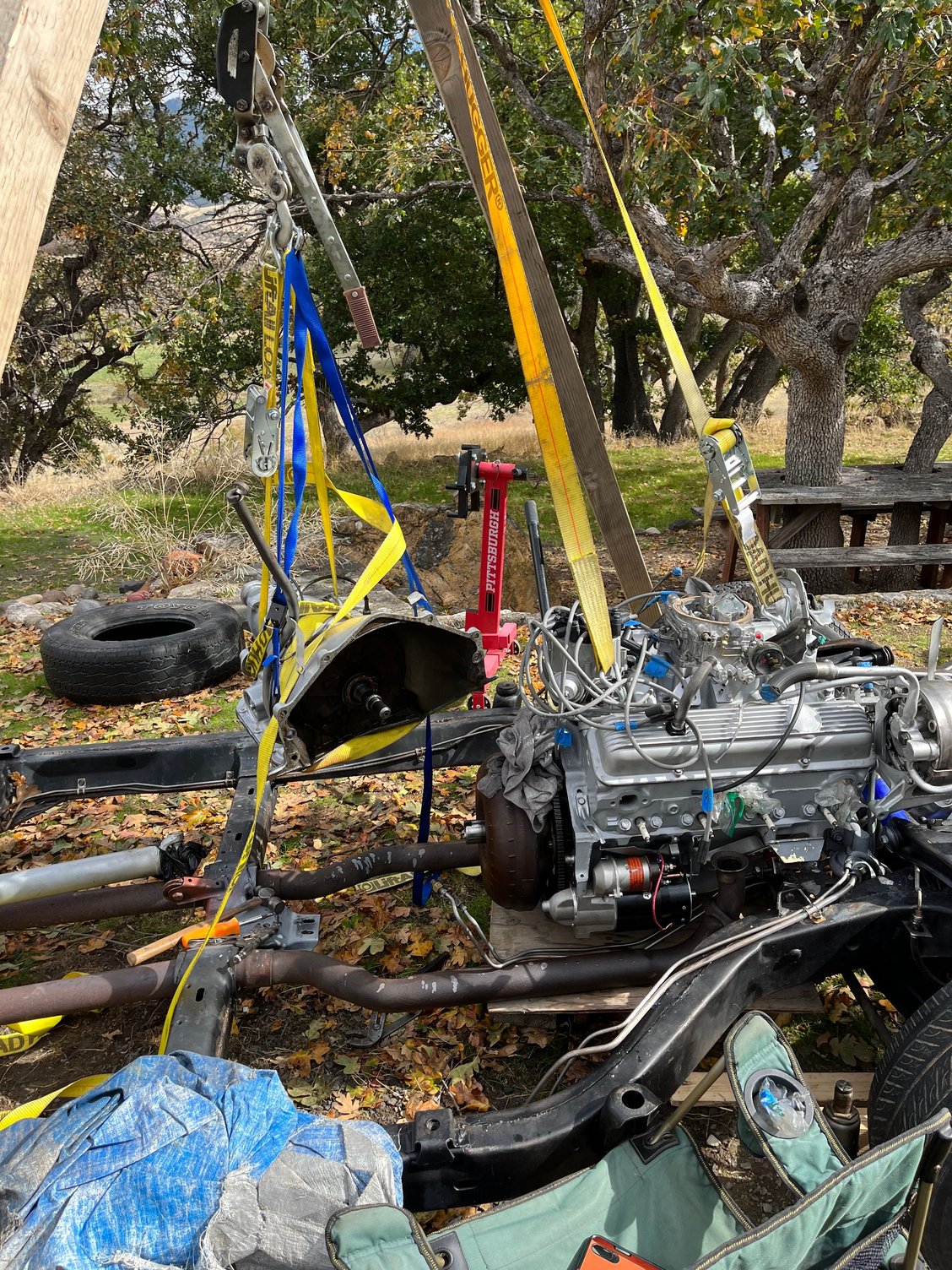

Transmission hung from straps & a come along

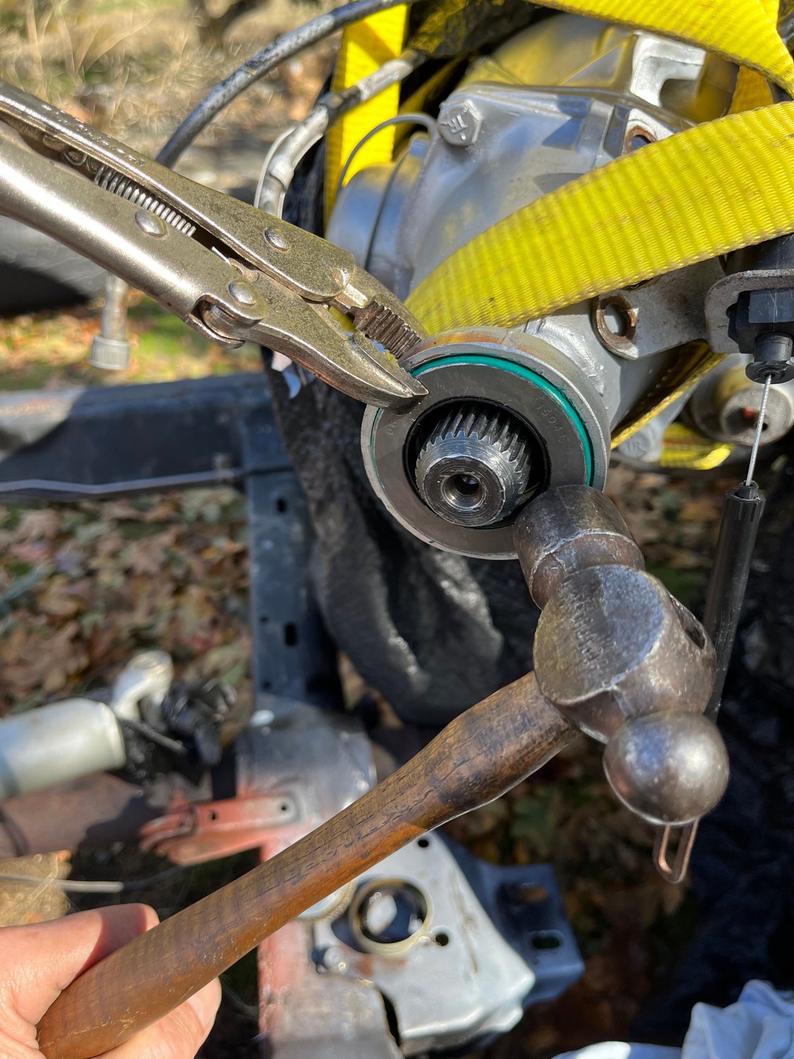

It was tricky pounding the new seal on straight, but this worked.

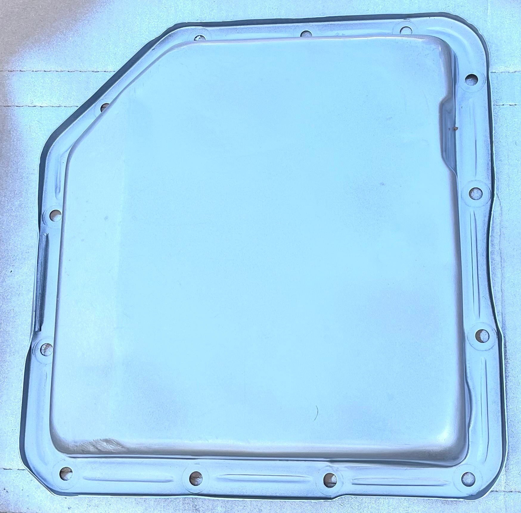

Pan cleaned, wiped down with mineral spirits & painted

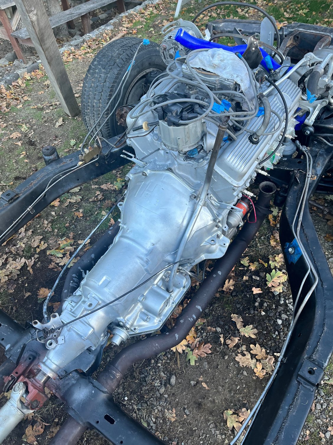

Got a lot done today. Tomorrow I’ll get the radiator & oil cooler hooked up…
Bell housing snugged up to the block after I finally got the notches in the torque converter lined up. I tried doing this with the converter bolted to the flywheel, but couldn’t get it to go. I finally got this done after removing the torque converter & sliding it onto the shaft. I’ll connect the converter to the flywheel after I get the bell housing bolted onto the engine.
