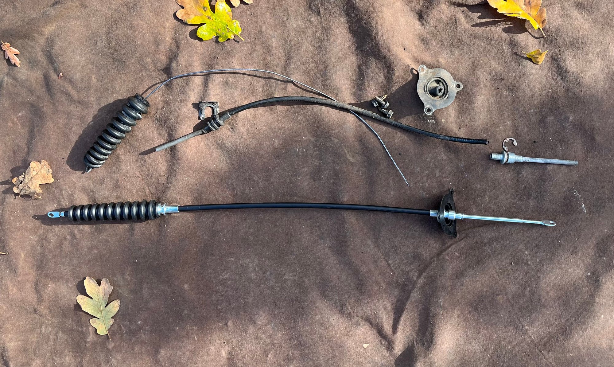

The super stout new shift cable from Full Throttle Corvette will have to get installed after the body is back on the frame.

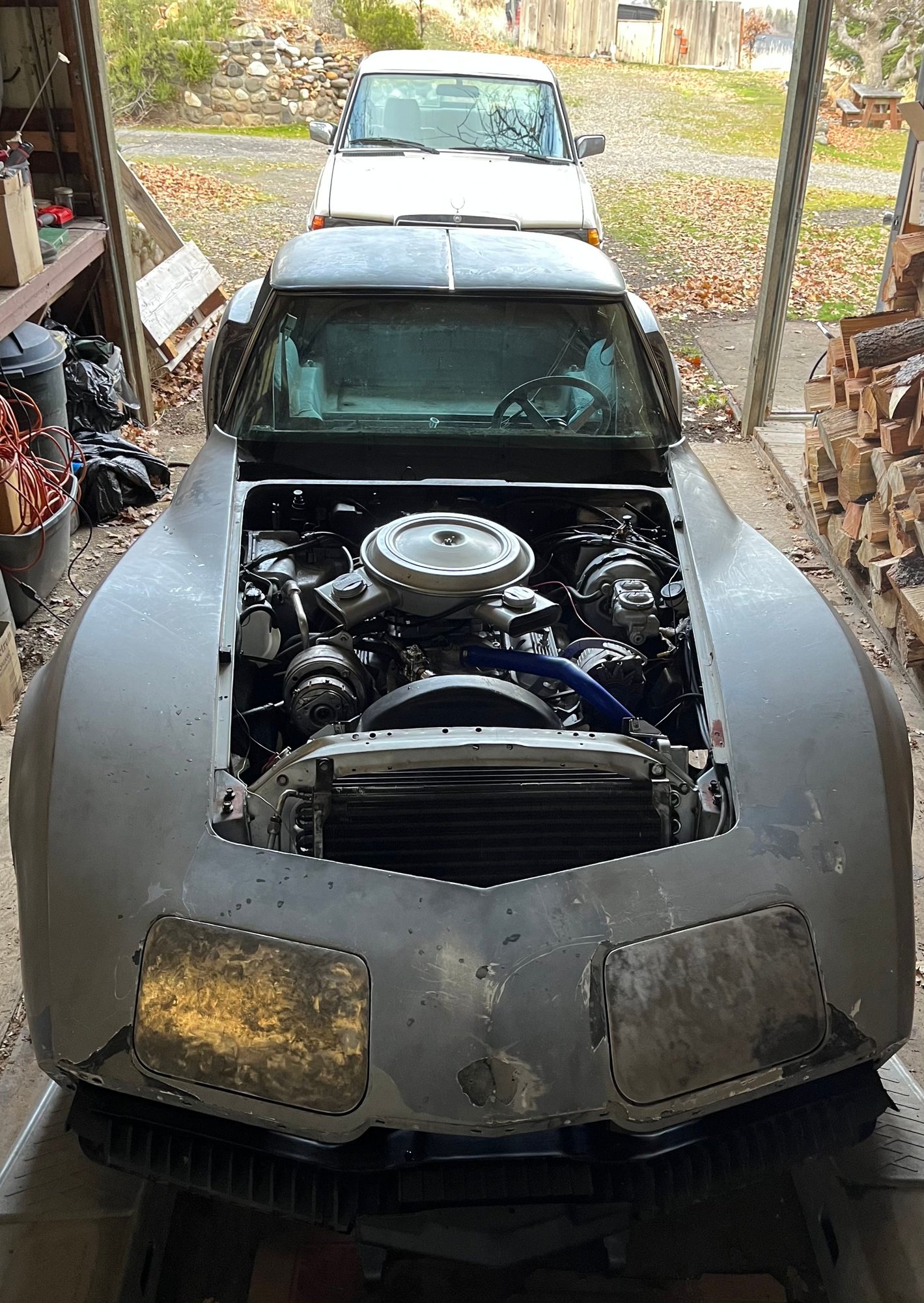

After placing body mounts, up goes the body, until we’re suspended, clear of the trolley.
Disconnected the radiator frame from the front bumper assembly, unbolt the frame extensions, & remove the bumper & vacuum reservoir.
The turning point of this whole procedure came when we found that the body was a few inches too low to clear. Dave suggested taking off the gas tank, which we did; then rolled the chassis under body.
I watched the distributor slide up into place just ahead of the firewall. With a little maneuvering, the radiator & frame wound up sittin’pretty.
If I was to do this again, I’d have another support under the cable on the other side to eliminate the sag; & I’d remove the master cylinder brake lines from the proportioning valve.
Gas tank reinstalled, ready to lower the body…
It was tight getting the body on over the radiator & engine, but somehow it all slid back together, right at sundown. Got the tools put away & the car covered with a tarp, just as the rain started falling.
