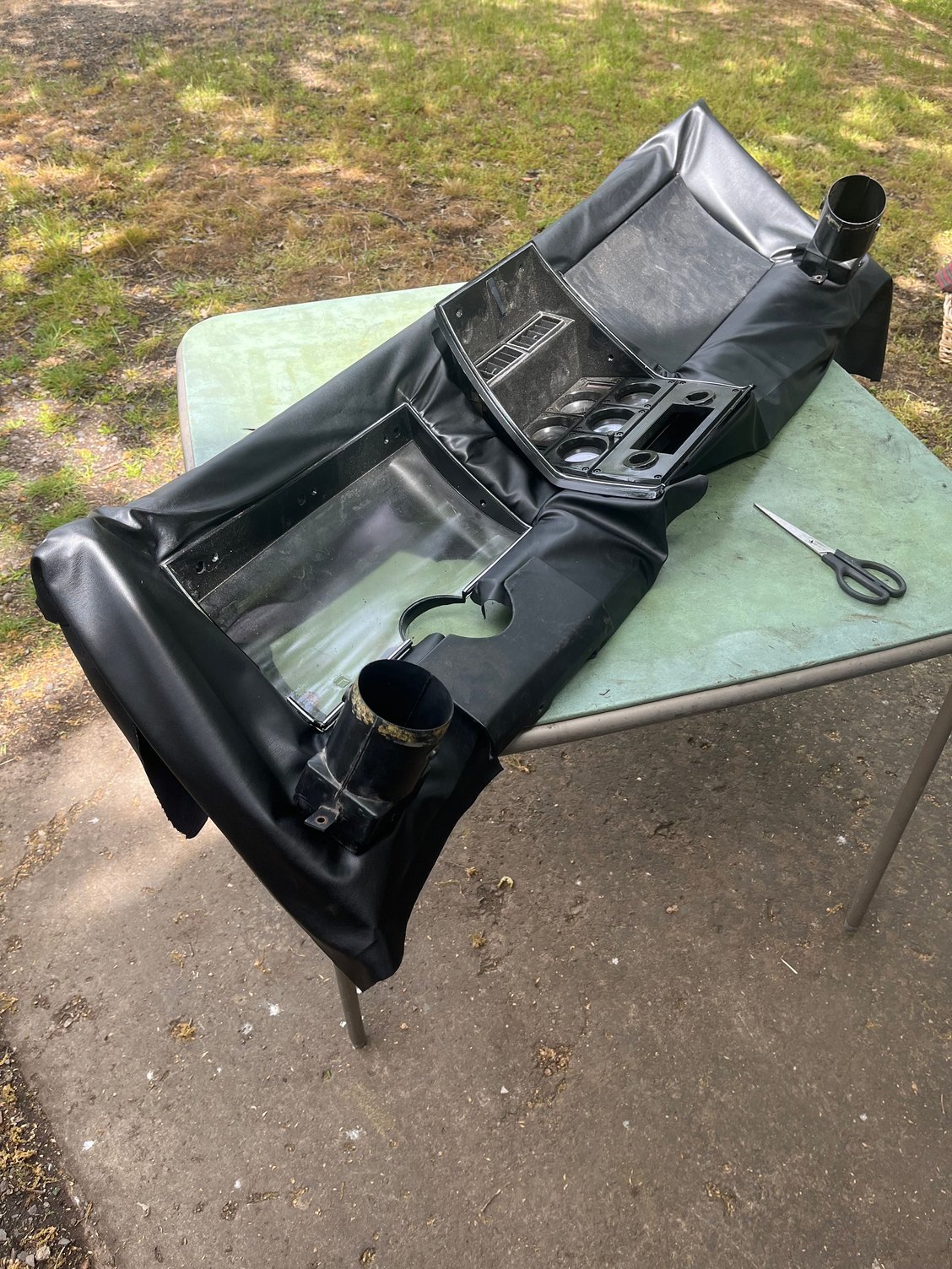

Springtime has made working on the ‘78 a real pleasure again. I took another stab at covering the old dash in vinyl. It was tricky, but it turned out pretty well. A few wrinkles in the corners of the air vents & gauges, but it looks kinda cool that way. More “leathery.”
I removed the steering wheel to install the dash which isn’t difficult. I fixed the telescoping feature, which wasn’t unlocking. Now it does.
Mercy & CJ helped me pull the Vette back outside, into the warm sunshine.
Bathed in fine spring 🌞 sunshine, life is born anew. Wrenching on a classic beauty in the shade of oak trees again. Grace, too sweet to ignore. I’ve decided to follow through on the project to the extent that I can, as long as I can. As it turns out, I’ve got about a year before I’ll have to leave this place. My original plan was to finish the car, drive it down to San Diego & trade it for a bluewater sailboat. Then I’ll go diving for sunken treasure in warm waters until something eats me.
Putting dash components into place before cutting the vinyl keeps it in position as you work the material. I used a small paint brush to apply contact cement, working very slowly. It took me about five hours to do it.

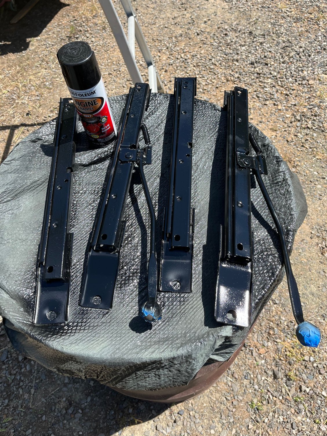

Seat rails were solid rust. Now they’re prepped with a wire brush & primed with acid-etching Rustoleum.
Finished with two coats of gloss black, high temp, cuz that’s what I had.
