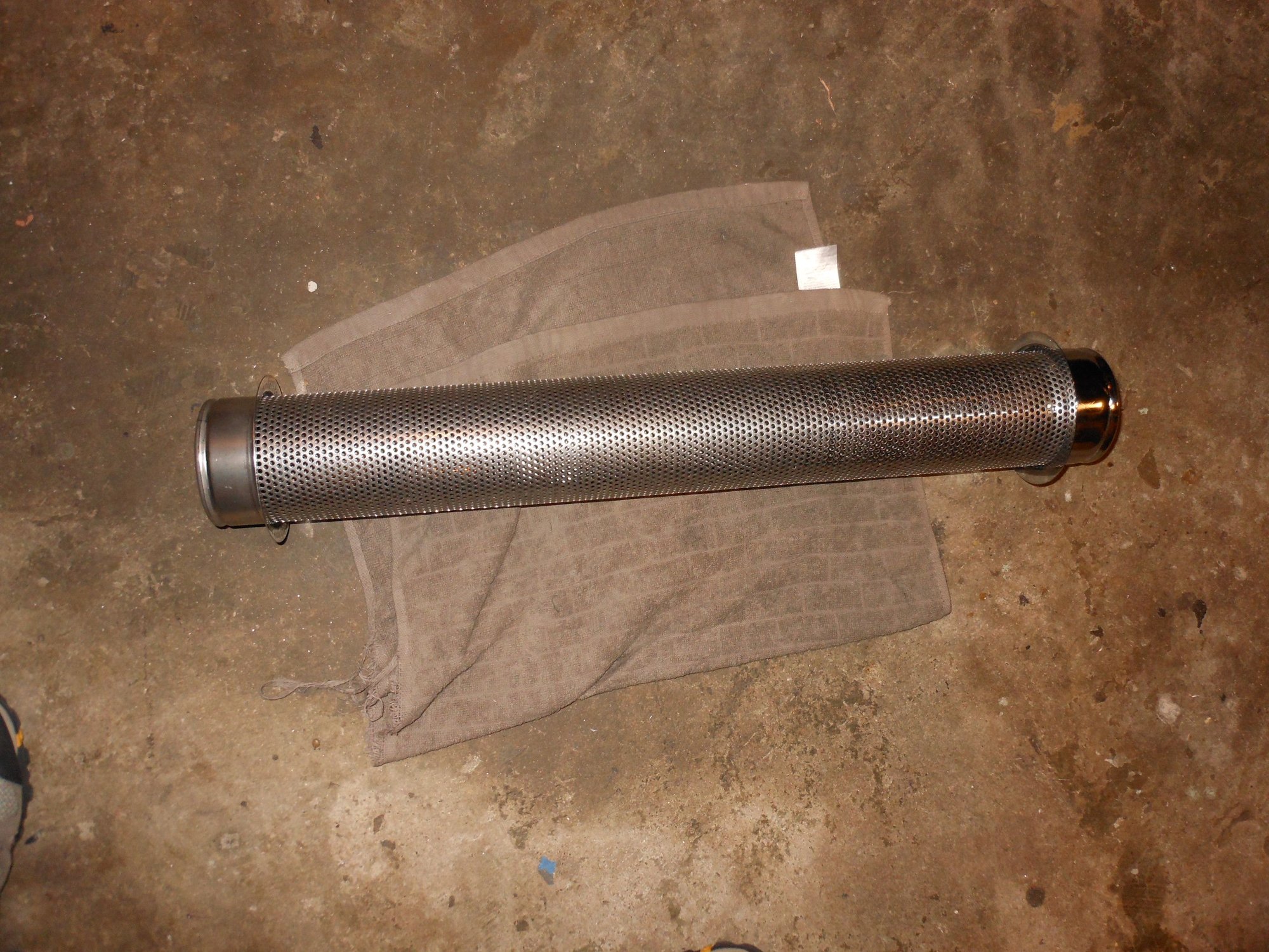

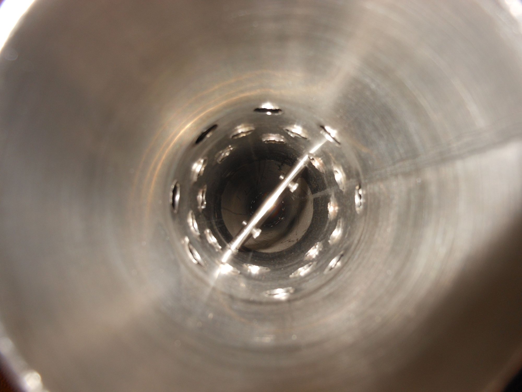

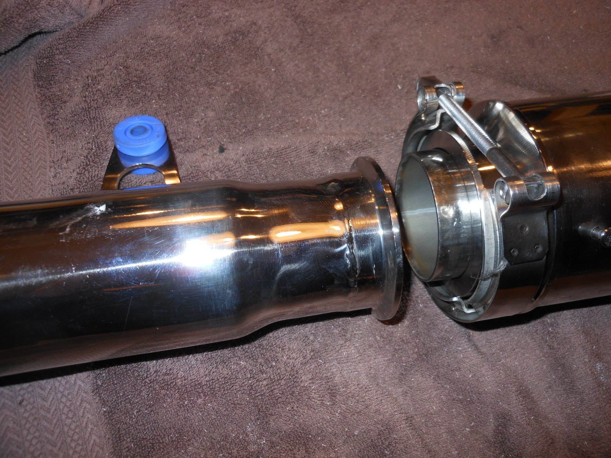

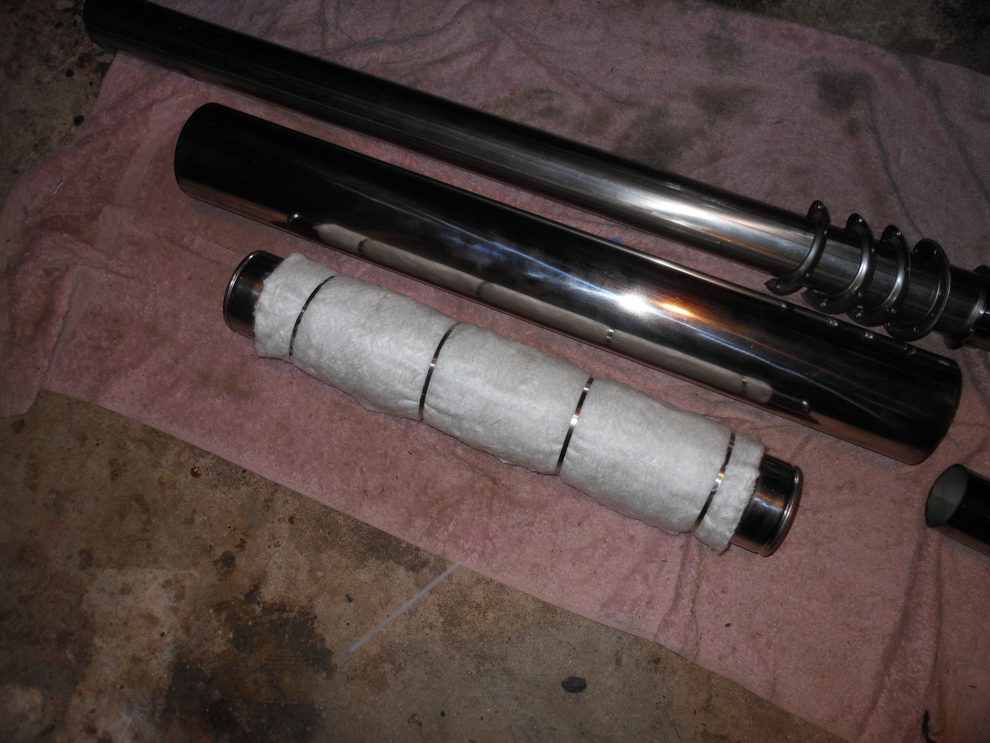

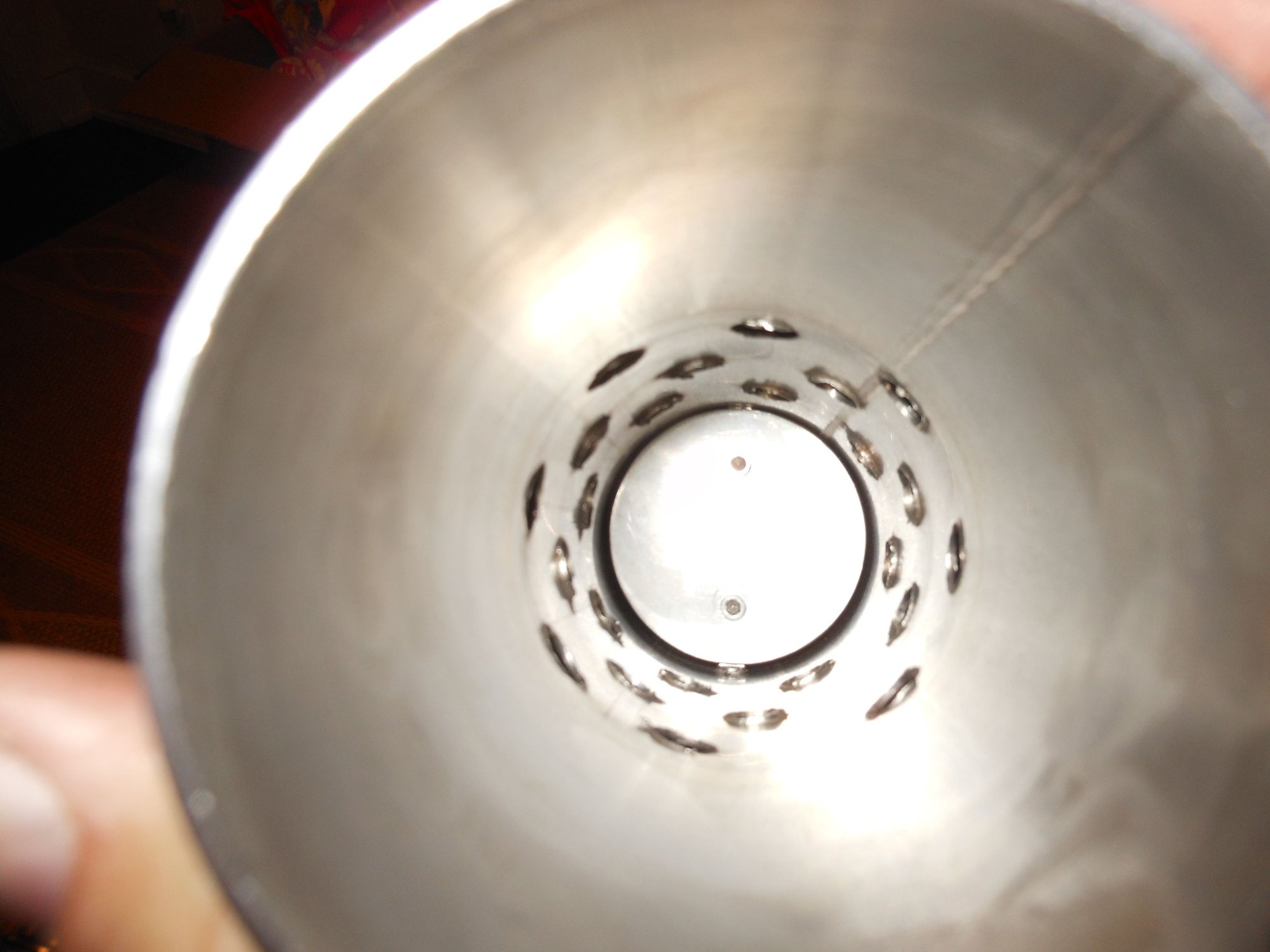

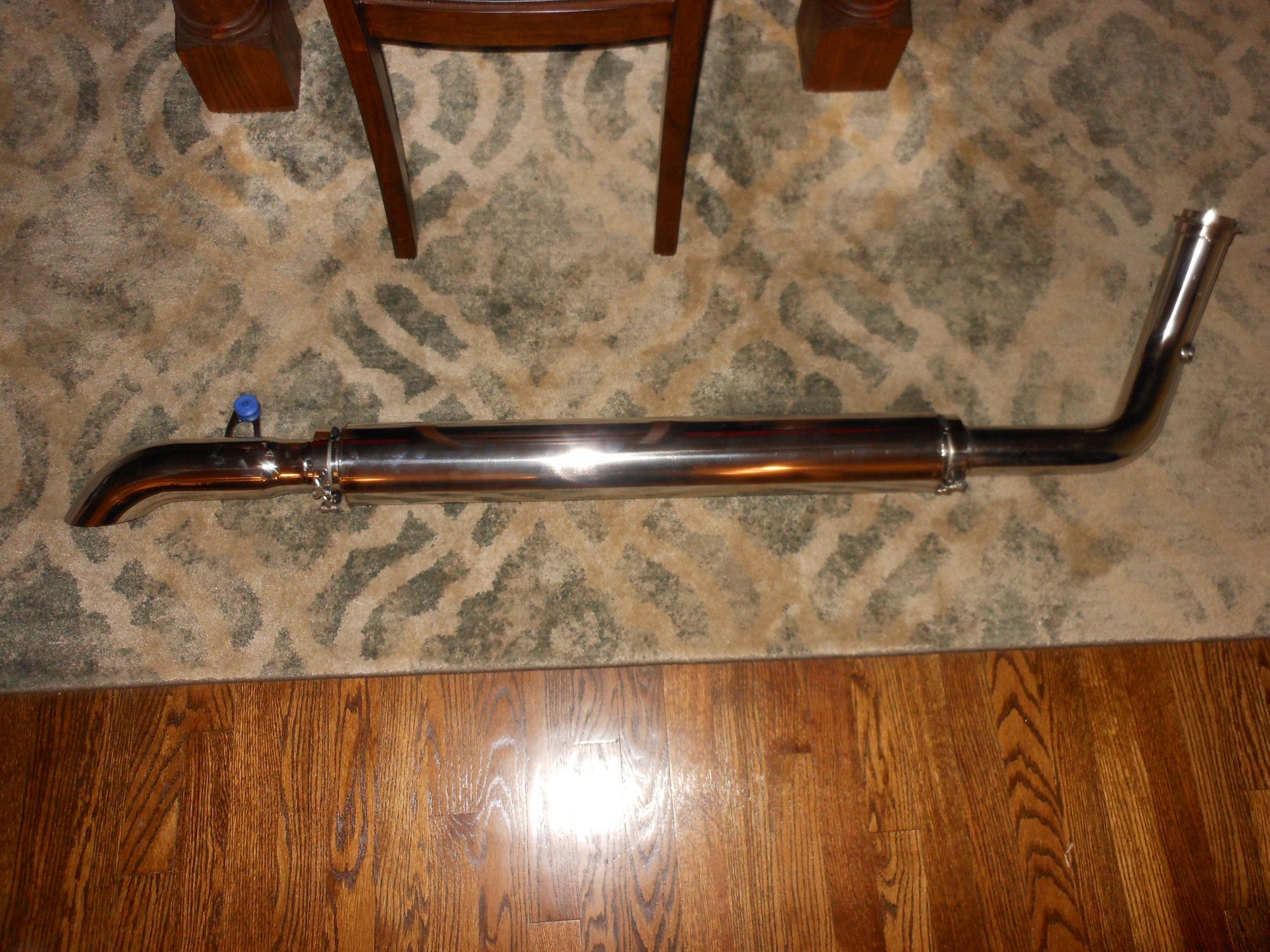

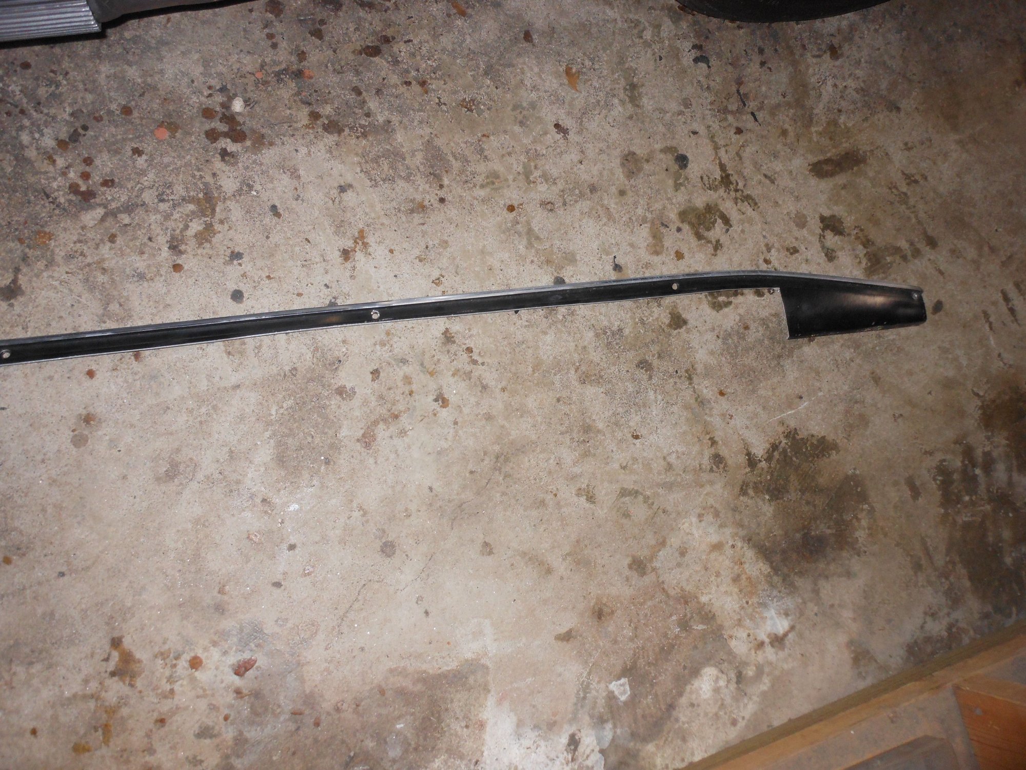

I was able to fit 4" pipes under the factory covers- I used ½ rect tube to space out the covers-
Custom stainless steel with internal electric cut outs-
½" rectangle tube used to space the insulator -covers out
And cut up a rocker panel to totally trim out the pipe covers-

Richard, do you have 2 exhaust systems on the car, one thru the pipes and one thru the back? Next question, where did you get the pipes? Last question, when are you going to make a kit so we can all put electric cut outs in our pipes to go along with our wiper doors and headlight buckets! You are the man, no question about it.
Hey Jim-
"You are the man" -Yep and my pronouns are He/Him!!!
I made then- just one pipe
Way too much work- stainless steel is way to expensive-
Here's how they work-
