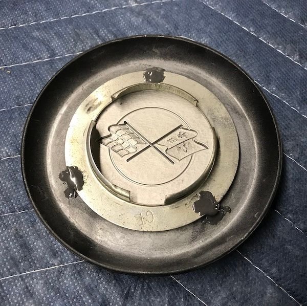

Hey guys,
Does anyone know a way to repair these horn button rivets? Thanks in advance!

Correct me if I'm wrong, but I think my horn contact assembly is good I just need to find a way to reattach the clip on the back of the horn button itself.

Zip Corvette sells just the rivets. I've replaced the ones on my 79.

Ah the metal one..
looks like a blind rivet? Standard?
drill out old and pop in new rivet?

Restored mine a few weeks back. I used JB Weld. There's not a lot of meat on the rivet stub to drill and put anything in there without risking coming through the front.
