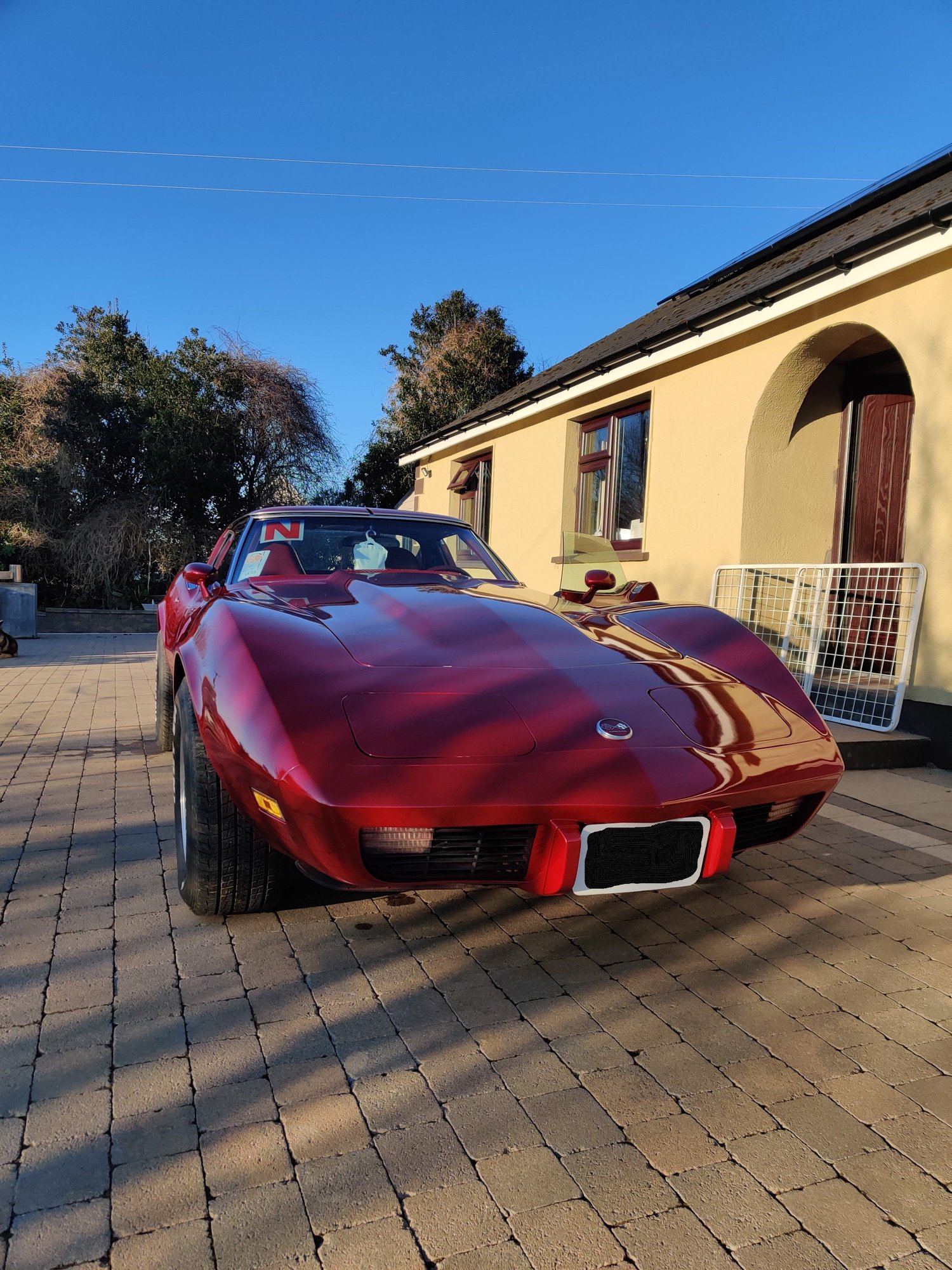

I have a 1976 C3 Corvette and the engine is having major problems. It has already been rebuilt and I think it is time to get a new engine.
I was thinking of possibly getting a BluePrint GM 383 Stroker Engine for the corvette.
My Question is:
Would this fit in my car?
