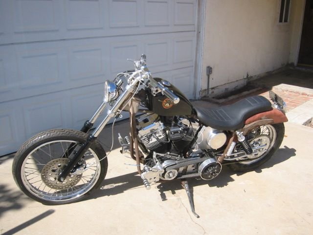

Each bike is a bit different. This one I built from parts back in 1992.

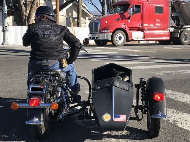

This one is for carting my dog around with me.

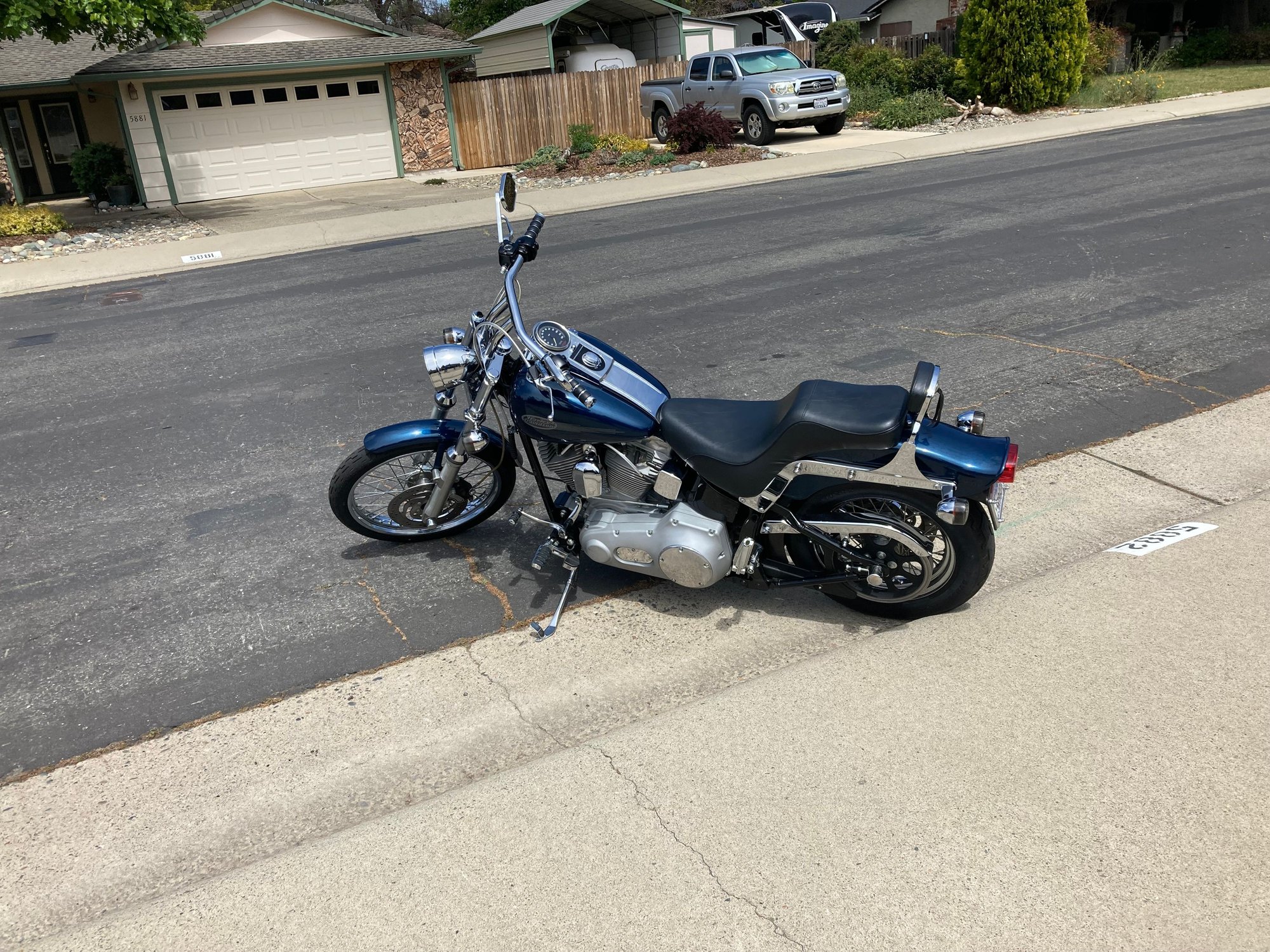

FXSTi

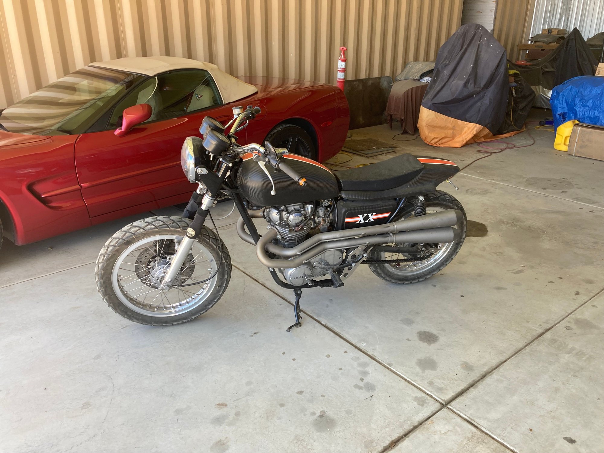

Scrambler for bombing around the dirt roads in my area.
